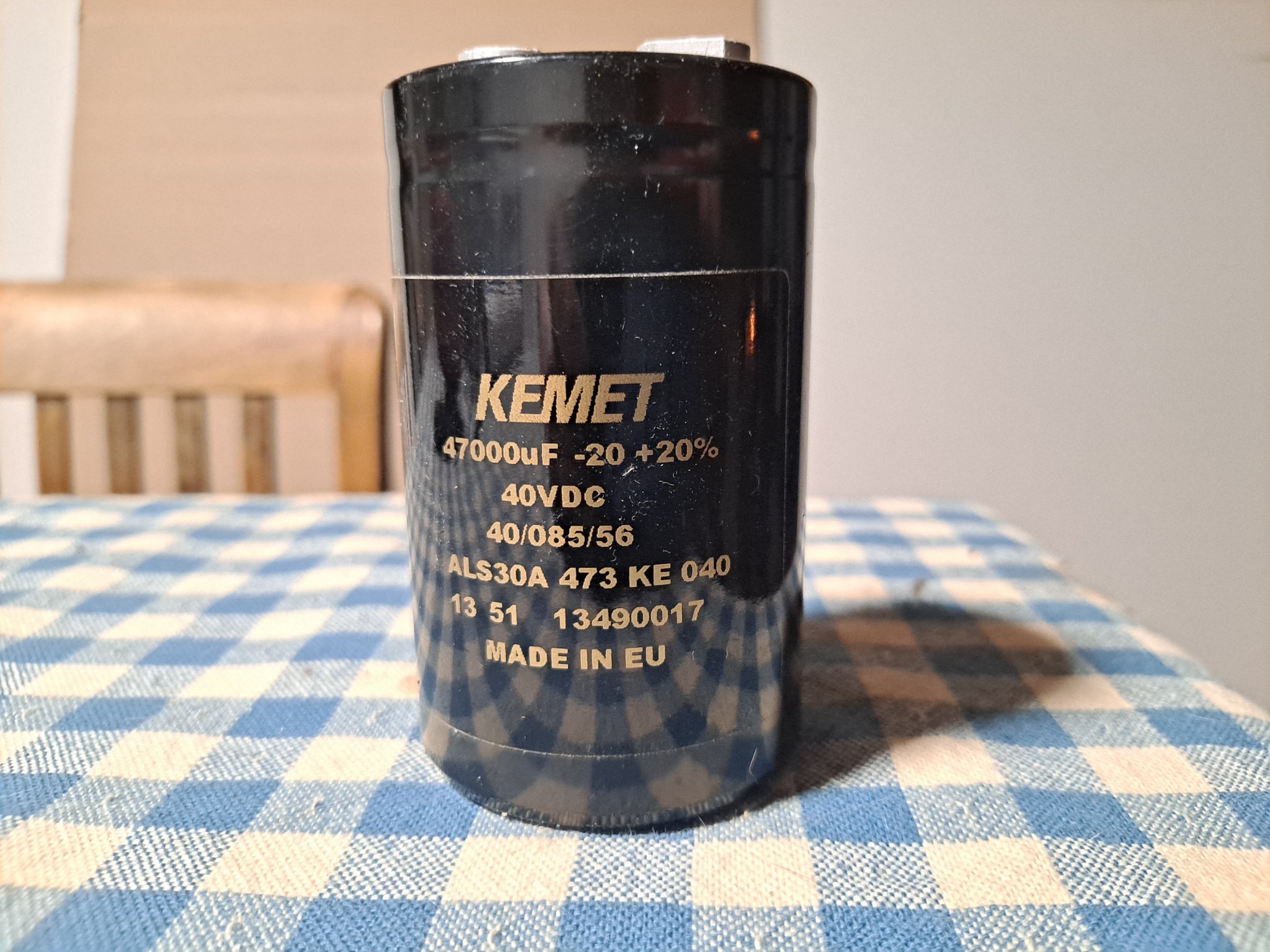

ZenMod, you had mentioned using 35 volt power supply caps for the 30 volt rail setup or 50 volt caps for the 35 volt rail variant.
Is that because capacitors typically are not sold in intervals between 35 and 50 volts? Or is there another reason?
I ask because I have a bunch of these nice Kemet 40vdc 47,000 uf caps.
40Vdc caps are purrrfect

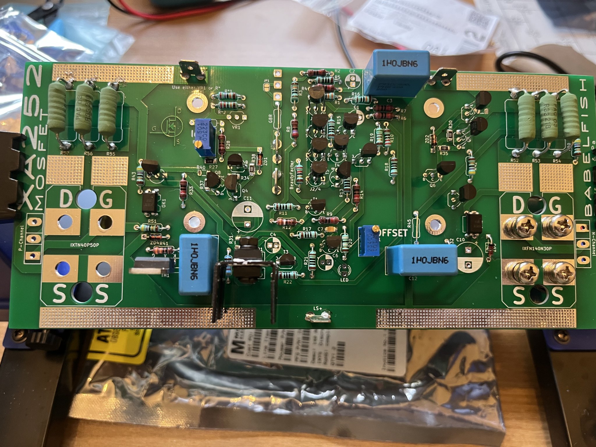

I got bored waiting for this and have started making my own. I could only find the smd 3092 and used those.
I reckon it’s 50 50 if I get magic smoke! I should have waited for the real ZM one, especially as I still haven’t finished my Aleph J’s case.

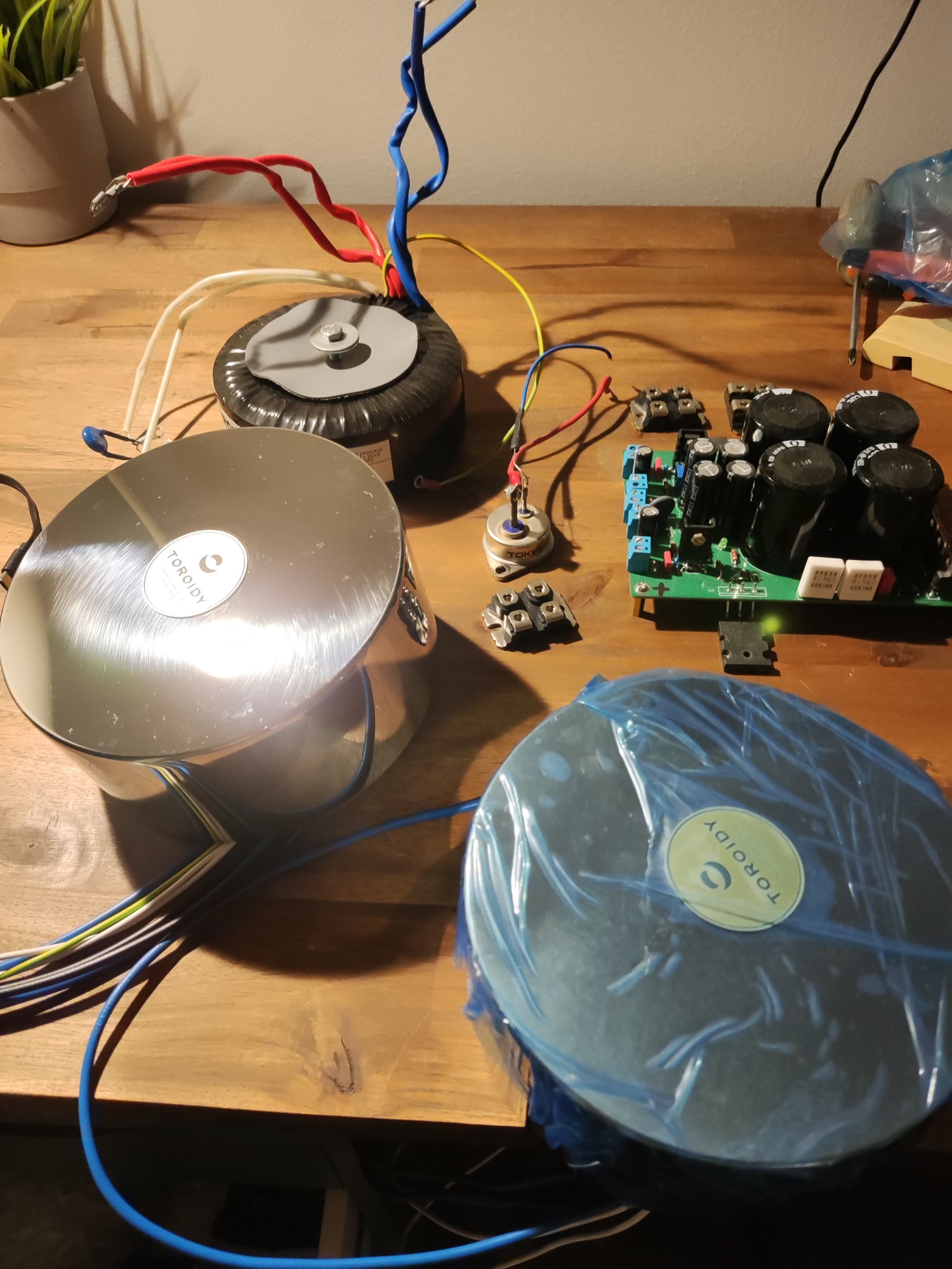

I have gathered my (majority of) parts for xa252 (no SIT, no Schade) and SissySIT P. Thanks ZM, looking forward to receiving PCBs. I always second guess my own choices of parts so conveniently asked ZM to send full packages. At least then I remove that small factor of doubt from my mind. Look at the size of those supreme Toroidy transformers. The one in the back is from Toroidy as well and has equal specs😱. They are heavy and huge!

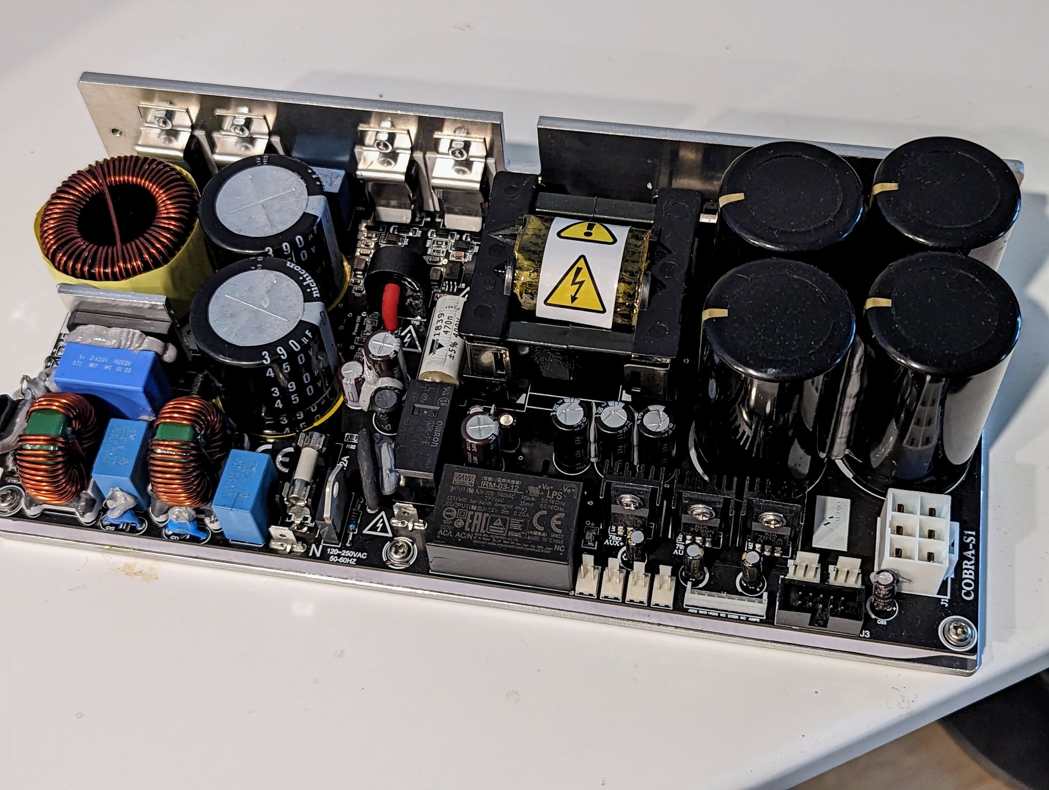

I've recently acquired an SMPS from MicroAudio. Oozes quality. Rails are around +/-33VDC and can deliver 15A peak.
