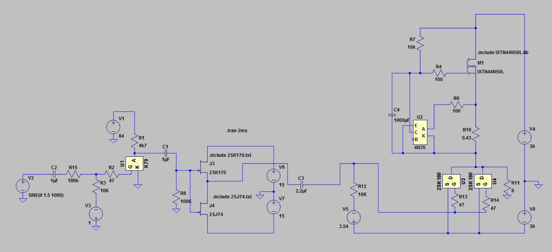

wow nice!!! Jama your schematic looks like its missing something around the input buffer (Q4,Q5 DC path to earth)? Or maybe its just me who'se missing something))
Hi kasey - chalk that one up to me as the scribe. The buffer earth path is "implied" and left off as it was getting crowded in there. It is needed and should be there. My bad.

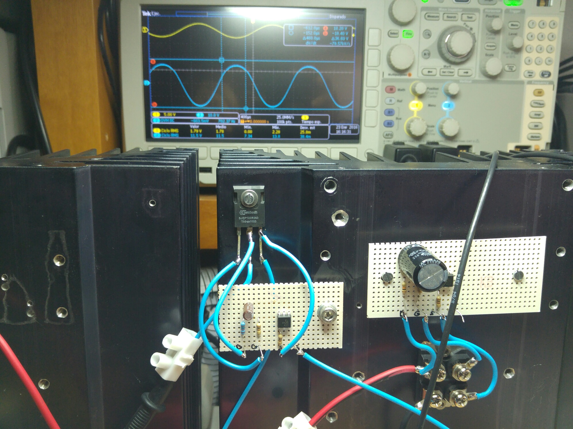

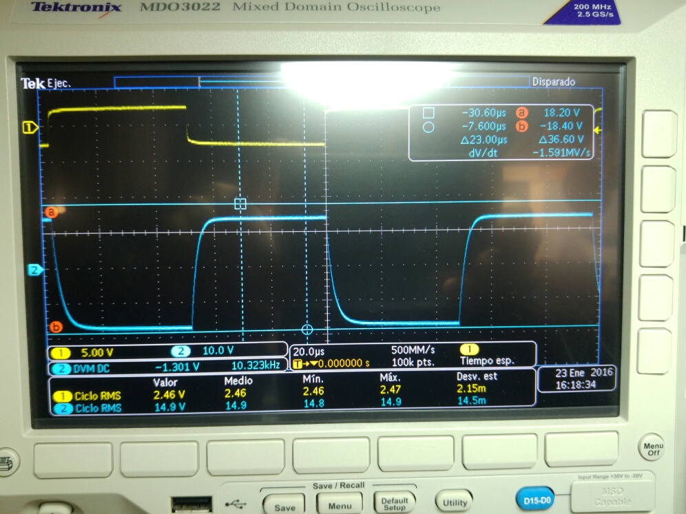

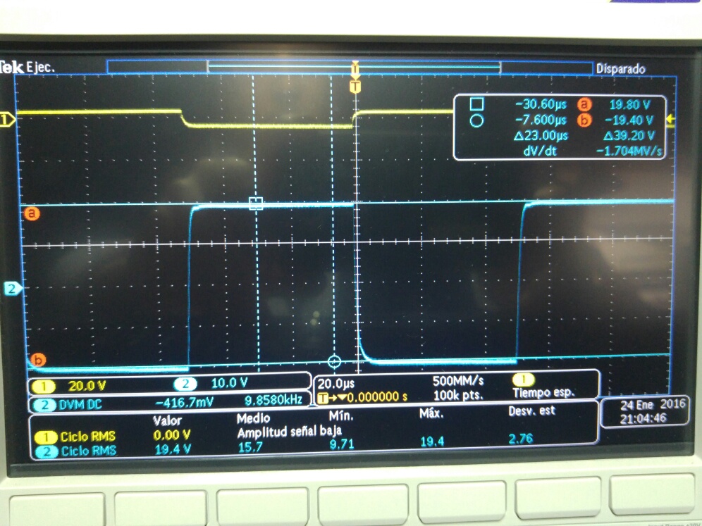

I have a question for all. With one tokin alone, I found that frequency response is a lot better with one THF51 than one 2SK180. I have not graphics, but I measured it. With thf51 I found that is flat until, more or less 70 or 80 Khz, and with 2sk180 (one of mounted) this response is a lot worse, flat until 25 or 30 khz. Well.
Now I mount two 2sk180 in parallel. Frequency response is a lot better. Look square wave at 10Khz and (really 6.8/2 ohm).
I am using 50ohm output of generator all time.

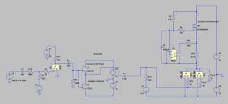

This is the ltspice simulation of the idea.
look at post #644
Thanks all. Last schematic as here (thanks Steve).
It is as ever, only that with two vfets.
I have not mount buffer yet, but sure that I need do it.

For full output, always in function of transconductance of vfet pairs, you need a little of voltage gain at input, and sure the buffer.
I simulate for buffer position 2sk79 as cathode follower and 2sk170 and 2sj74. The best results were with the last, being transparent in simulation. And 2sk79 introduce a lot of harmonics.

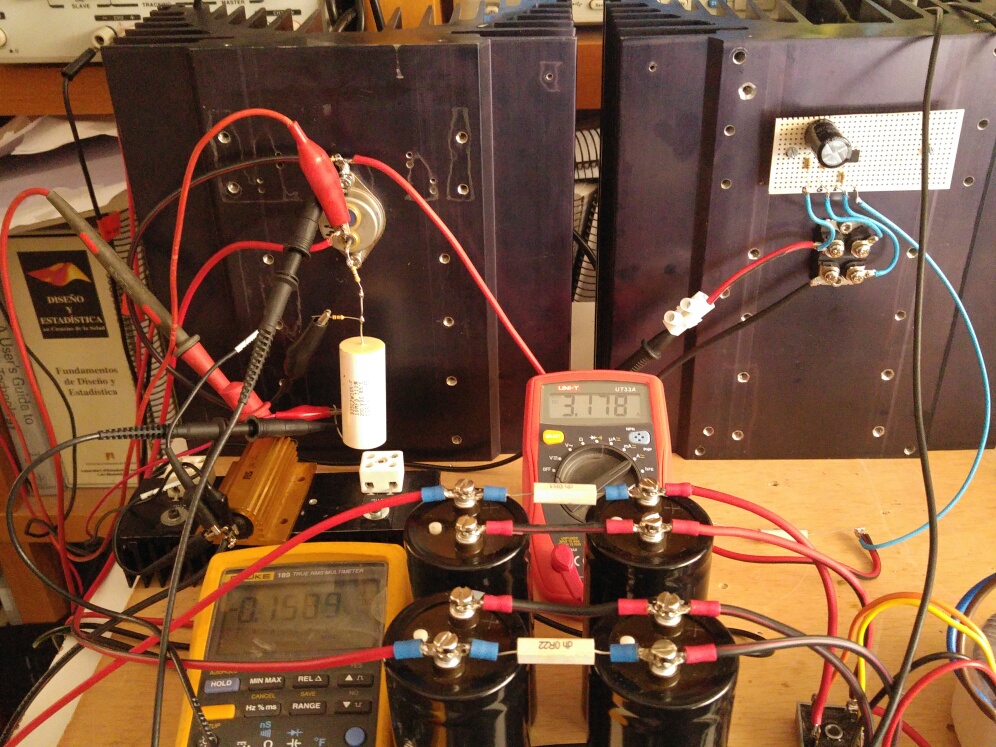

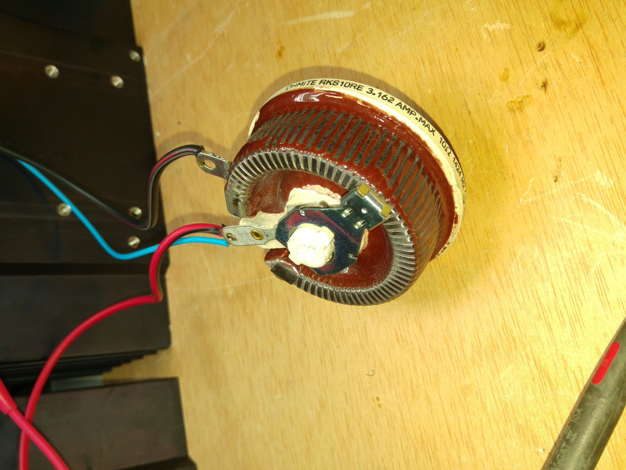

For reference, with this ixys mosfet and using one nice power pot of 10ohm 100w, i could get values for current of ccs, so
3.1 ohm -> 0.45 A -> 1.39V
1.25 ohm -> 1.09 A -> 1.37V
0.85 ohm -> 1.58 A -> 1.35V
0.56 ohm -> 2.34 A -> 1.32V
and .22//1 ohm -> 6A -> 1.08V
