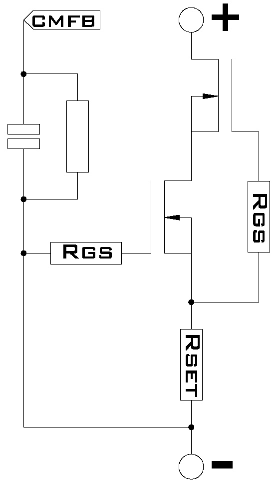

Please forgive the basic question but transistors are like mysterious black boxes to me. Is it possible to implement this type of feedback with a cascode depletion mode fet ccs by returning the feedback signal to the gate of the upper device?
Thanks,
Marty
The cascoding device (tubes, FETs, BJTs doesn't matter) can not be modulated, the feedback must be connected to the active part in the CCS which decides the bias current.
Cheers Michael
Cheers Michael
Thanks Michael, So is this right then?
Marty
That one won't work, the gate is shorted to the negative supply through Rgs so one can't modulate the CCS current with the CMFB signal.
Add a LED or resistor from the point where Rg and R||C (from CMFB) meets to the negative voltage, now we will have a higher voltage on the lower FETs gate so one must increase Rset to preserve the current setting of the CCS otherwise the current will increase quite much. A rough guide to start with.
EDIT: Seems SY and I wrote/replied simultaneously, well 2 versions..
Cheers Michael
Cheers Michael
