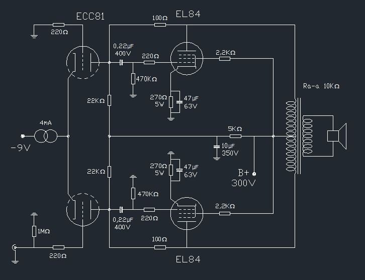

Hi !
Can I please ask something regarding this older thread ?
SY said:
So, all things on the load side are important.
does that mean a scheme like this won't work ?
(a bit of Kirchoff, a bit of Kitic)
Empee
SY said:
...One thing to be careful about is maintaining balance with the measurement- if you stick a scope probe on one output, you've unbalanced things. Use identical probes on each output. ALL bits related to the load, including the measurement apparatus, must be the same for balance. Two probes, dual channel scope.
Empee
