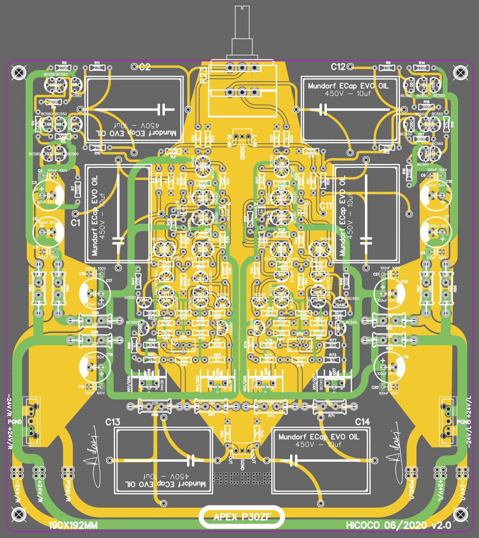

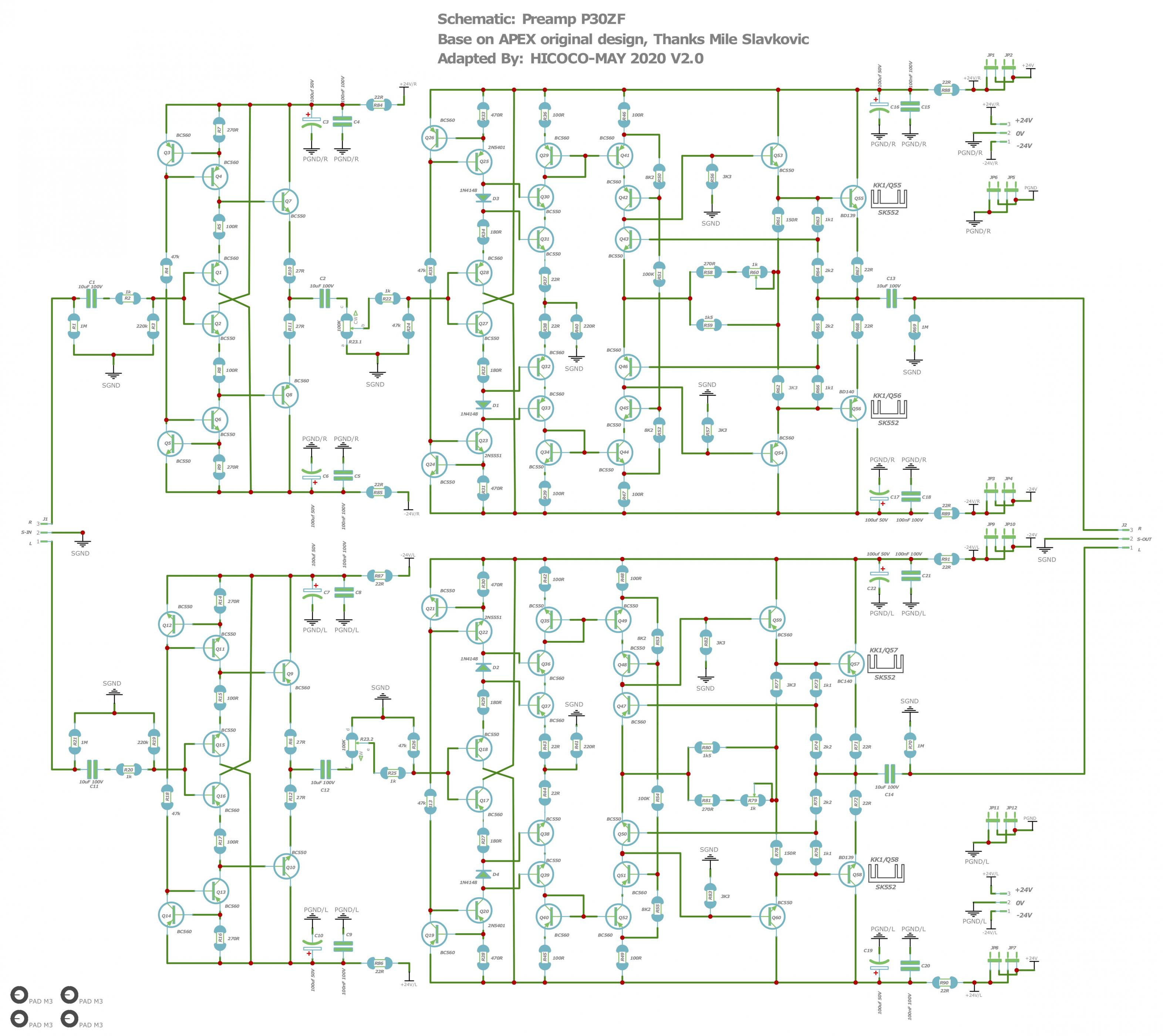

APEX P30ZF with stereo version uses 52 BC550/BC560, actually my New DIY project..
Why do you use big 450V caps?
Because i did not find any Mundorf MCap under 450v for 10uf...Now you can choose an other capacitor that feel your need..i just like Mundorf MCapWhy do you use big 450V caps?
You can take a 47uF electrolytic capacitor without any deterioration in the measured values.Because i did not find any Mundorf MCap under 450v for 10uf...Now you can choose an other capacitor that feel your need..i just like Mundorf MCap
