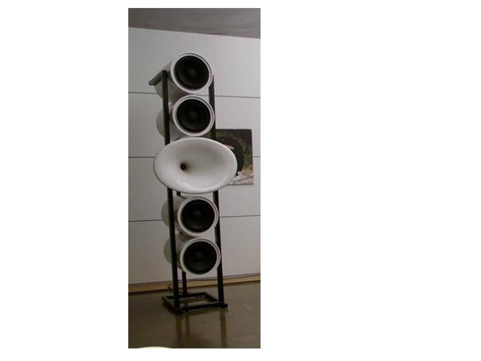

Nice. (Here) The "bunker" version on steroids.
Floating Opera House for Toronto
