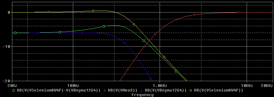

As promised here is the next variant of a "beautiful swingin' speaker"
Gaussian MinPhase horn stays the same - the main improvement is a better match to the good low-SPL resolution of the NEO3W with cone speakers of veeeeery high Qms plus smooth FR and low harmonics.
Another improvements is going "nude" – meaning hanging the speakers without any baffle at all.
Last improvement is to "split power" between a 8" mid and 12" bass making up for a 2 ½ way
XO is basically the same topology, adapted to different efficiency, baffle peak and the two speaker (partly) in series.

![XO_NEO3_Selenium8W4P_Beyma12G40_nude.png](/community/proxy.php?image=http%3A%2F%2Fwww.kinotechnik.edis.at%2Fpages%2Fdiyaudio%2FDDCD%2FNEO3%2FBG_NEO3_BEYMA12G40_SELENIUM8W4P%2FXO_NEO3_Selenium8W4P_Beyma12G40_nude.png&hash=b20e086a944d3acb7a9d8db7dbecadfa)

Michael,
Haven't you tested a less concealing and "boxy" baffle than the first one for the SLS? I believe you were missing half the fun by immediately going nude without testing some nice cutty sark in between.

You are most certainly right – but what I present here is just a detour project of mine to give a teaser for those who are interested in checking out "latest news".
From that background I already knew that there is something better compared to a plain baffle which is in fact to have no baffle whatsoever – its really worth a try !
Though there are obvious drawbacks to going "nude speakers", the sonic "purity" simply is an experience. To see (hear) that you can have enough bass - for home application in decent rooms size (~20m2) - from a nude 12" is fun too.
What I wanted to combine with that step up variant is also a practical demonstration to my findings regarding low-SPL distortion I've been rambling about in Stig Erik's thread.
The main reason the NEO3W and the Peerless SLS did not merge sonically in low SPL levels, I traced down to a difference in how higher order distortion take over at low SPL levels.
IMO this is a very strong indicator to a behaviour of ill sounding dampening due to "non velocity related" friction.
As its not exactly a challenge to find speakers with high Qms – it suddenly is, if you also want generally low distortion, high efficiency and smooth FR in that package too – if you then add a requirement for decent displacement on top of that, you are left with not too many choices – especially for a 6"-8" speaker.
Finally I was very happy to find the SELENIUM 8W4P at a bargain price.
Interestingly this speaker has an old fashioned linen surround – not that usual nowadays – at least not in this form.
The BEYMA 12G40 sadly isn't that cheap, but easily worth every penny IMO and gets my warmest recommendation too.
