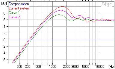

Additionally EDGE will show you, how the dipole peak frequency is a function of the ratio of basket dia to cone dia. Picture is 18 cm basket with 178 (green), 148 and 118 (red) cm dia cone. Was something like a surprise for me:Looks like Edge gets you much closer than the simple calc.
Curve 1?
So which one is green curve 1?Additionally EDGE will show you, how the dipole peak frequency is a function of the ratio of basket dia to cone dia. Picture is 18 cm basket with 178, 148 and 118 cm dia cone. Was something like a surprise for me:
I can only hope as much for my driver selection.There's a new graph below without any smoothing! Its shows that the breakup ringing is still there at 1 meter, but its still remarkably smooth around the dipole peak at at lower frequencies.
178. One of the reasons I'm tempted to mill down the flange on my Neo3s.So which one is green curve 1?
