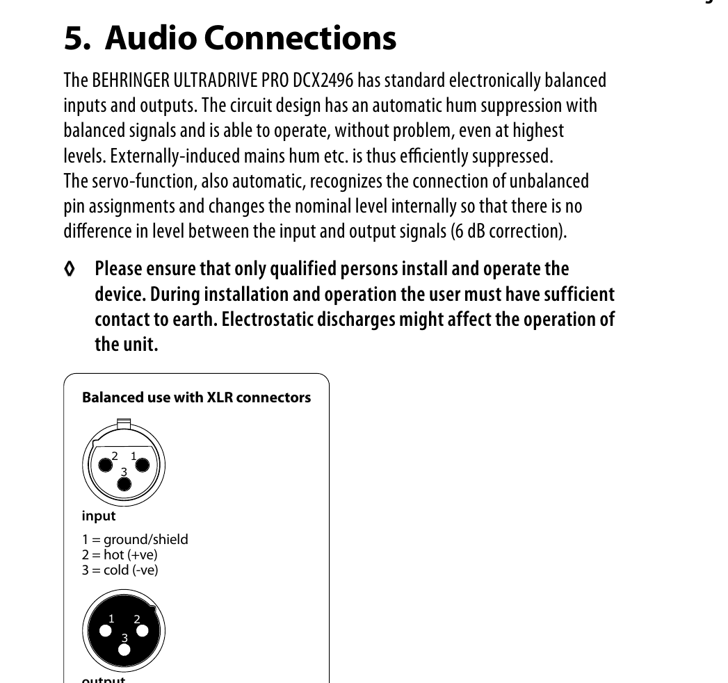

Ok, I'm wrong, it has a quasi floating output and the cold must be grounded?It appears when connecting to an unbalanced input I should leave pin 3 floating, correct? I've got the schematic, doesn't look like that driver would appreciate it's output being grounded
What is it you see on the pin 3 output that is floating or quasi-floating???
Dave.
The balanced line driver is quasi floating like this figure 6 Balanced Line Technology
When connecting to an unbalanced input it seems to be unadvisable to leave pin 3 floating with this kind of balanced driver Balanced and Unbalanced Connections | PreSonus
That's not how I understand it, according to the article above the gain remains the same, although Doug Self says the headroom in down 6dB. This is from that article:
""Another electronically balanced configuration uses what’s often called a “cross-coupled” or “servo” balanced circuit. This generally uses three op-amps and delivers the full voltage between pins 2 and 3, even with one of those outputs connected to ground, the same as when unbalancing a transformer output. This output-circuit configuration was designed to emulate the effect of a transformer, and while it’s far less expensive than a good transformer, it requires a few more parts than a simple op-amp inverter. When connecting this type of output circuit to an unbalanced input, pin 3 should always be grounded. This effectively puts the two legs of the output circuit in series. By grounding pin 3, the full signal voltage, rather than half, will be seen by an unbalanced input connected to pin 2 and ground.""
The DCX’s outputs should have pin 3 grounded when connecting to unbalanced equipment. The internal topology is such that the gain is automatically halved when you do so.
No, I'm afraid not. The gain is doubled, not halved, when you do so.
Dave.
