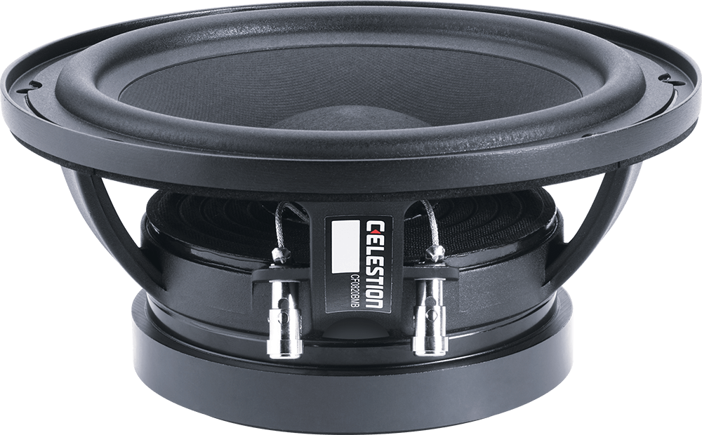

Maybe there are nicer edges out there but there is no PA foam on this one (picture ist from the Celestion-website):Because I always feel it's tricky to make them look nice with the PA foam edge, that are supposed to make them be mounted from the inside of the cabinet.

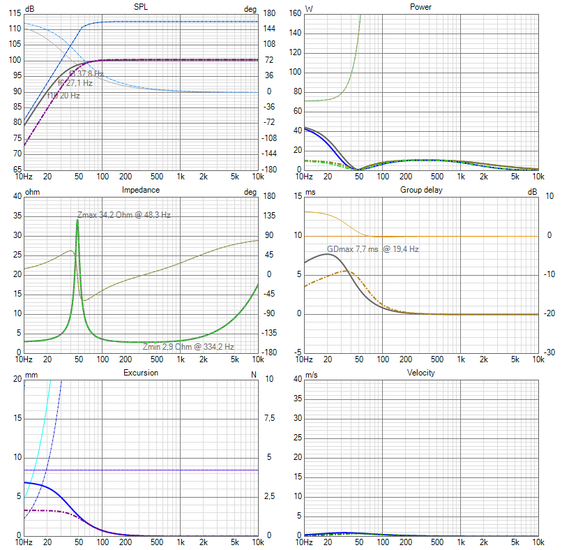

Another example: 2*Satori 9 1/2" 8ohm in 60 liters. With and without LT:
As you can see on paper/simulation because it is 2,5 times more expensive than the Dayton Alu, it does not translate to miracle results when we look at SPL.
I guess this has most to do with that we need to move a lot of air to see a significance difference.

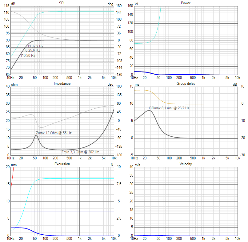

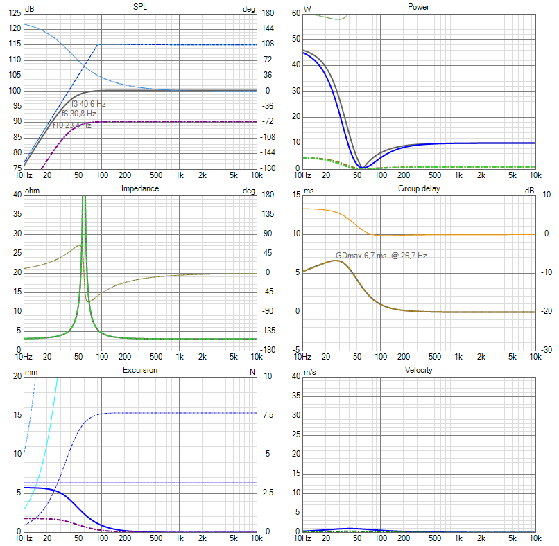

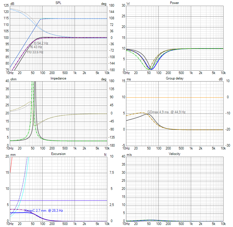

Here some simulations:
Two of those wavecor (8ohm).First we have 70 Liters and 40 liters with no EQ. Compression window in Vcad changes a bit.
Then a pair in 40 liters with LT to F3 40 hz at 100 dB and 90 db.
Reason I picked 40 liters is because that it my own contraints in my build. Of course best case is to test what sounds best, but from the sim i think 40 liters will be okay. Also with example Hypex Fusion 125 (125 Watt 4 ohm), it would do just fine. Maybe bit bigger than 40 liter is better, but not sure one could hear the difference in practice if we add LT.
