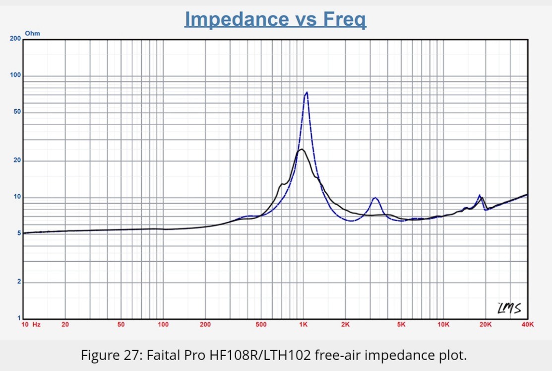

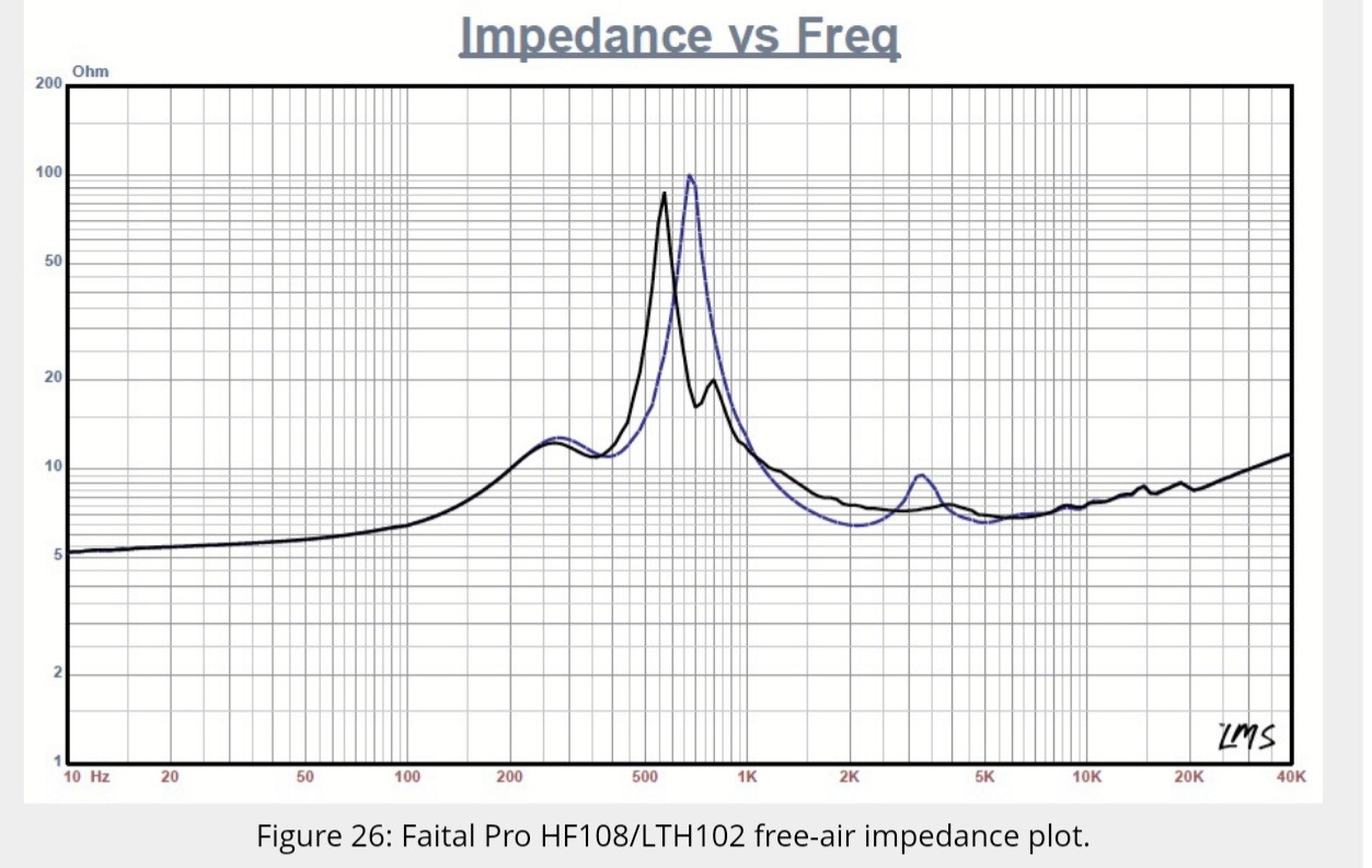

I think Faital know what they are doing. Yes, higher Fs for the R version, so not the lowest possible crossing. On the other hand, the impedance curve in the passband is smoother than the non-R. The CSD of the R version is also slightly cleaner, according to the Audioxpress review.You may be right. The rear chamber may be set up for different diaphragm termination points. The one big thing i noticed on the HF108R is the higher resonant frequency. This is counterproductive for using the driver at the lowest practically possible xover points, as you would try to stay out of operating in the resoant areas of the curve. I dont believe the R version is more suited to hifi use based on the description given by Faital, as a heavier diaphragm is worse at reproducing higher frequencies based on its increased mass alone. Plus a driver that needs more non-linear EQ to flatten is usually going to have more problems in general.
Voice Coil Magazine did a brief comparison and review on both versions of HF108s, but didn't go into much detail on differences, as they felt there were more similarities than differences. I dont agree, but those who want to know can read it for themselves. There is some differenc in the HF breakup based on FR and spurious impedance peaks associated with the R version. Here's the link -

I tried to do alot of homework chosing between the two versions of HF108s and came to the conclusion the non R was better suited to domestic or studio monitor use. The critical stuff I believe is the upper passband around 8k where the resonances start. The R has some breakup there as you can see on the impedance resonance. Thats an important area in the curve due to the inter aural resonance of the ear canal length and drivers with problems in this area sound rough and grainy to me when played louder. Many people don't exploit the full dynamic capabilities of a compression driver in a domestic setting, but I get pretty close while watching THD levels. I've listned to dozens of 1" exit HF drivers so far and the best by a mile is the regular HF108, especially how low it can be pushed. I dont agree with the VC test as a whole, mainly because Vance D never says anything bad about a driver even though it can be seen theres a clear issue with some.

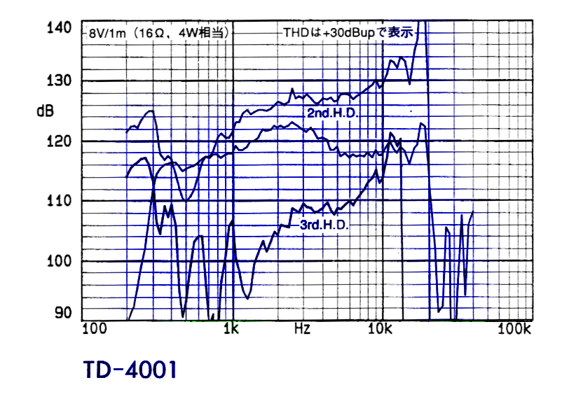

Oof, the alu version is nasty, good thing that beryllium existsHere are mediocre measurements of the aluminum version 951: https://audioxpress.com/article/tes...pression-driver-from-radian-audio-engineering.

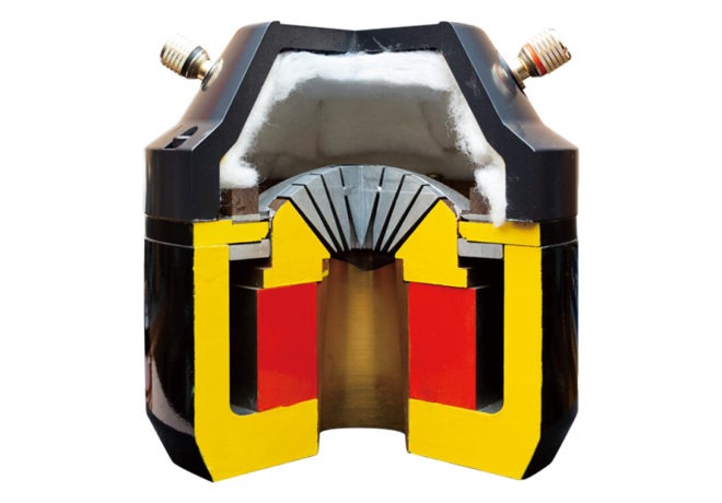

And lastly a rarity. A vintage, large format 2" Compression driver, with a aluminium diaphragm that behaves well compared with the TD-4001.Oof, the alu version is nasty, good thing that beryllium exists
The cutaway is of the modern version of it, made in Japan and sold for hmm interesting amounts of money, by G.T sound.
Using a 35 μm thick 4" alu diaphragm, with diamond shaped stamped surround like JBL. It also has unusally high amounts of copper in the motor, double shorting rings, copper covered top and a thin 'shorting' ring pressed on the voice coil, 4 slit phase plug. And 3,1kg of Alnico magnet with 2.0 T in the gap.

Nasty, really? How exactly do you find them nasty?Oof, the alu version is nasty, good thing that beryllium exists
I have the 950 with both original alu and truextent beryllium. I find the alu very nice sounding, warm and full bodied/weighty sound with surprisingly good top end extension. Beryllium is more transparent and detailed, but thinner and more clinical sounding.
The Yamaha JA6681B is another very nice driver with alu diaphragm, using copper/beryllium fingers for edge suspension.And lastly a rarity. A vintage, large format 2" Compression driver, with a aluminium diaphragm that behaves well compared with the TD-4001.

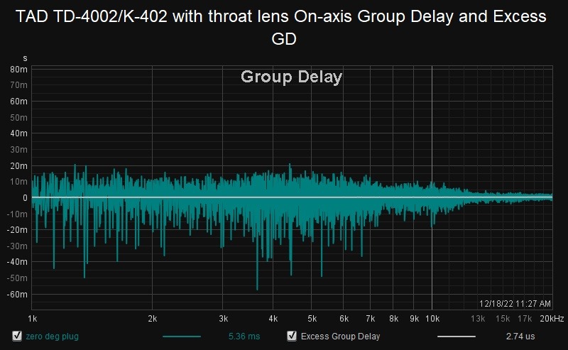

Hi ChrisThe issue with any driver exit diameter is related to dispersing the output above a frequency which corresponds to a half wavelength of sound across the throat exit--the sound above these frequencies "beam". For a 2" driver, that's ~6800 Hz at room temperature. For a 1" driver, it's ~13500 Hz, so both have issues, just at different frequencies.
There is a fix for this: an in-throat acoustic lens that divides the throat diameter into smaller annular distances:
In my subjective experience, this little 3D printed acoustic lens that slips in between the driver and the horn throat seems to solve that issue. I can now walk off axis at extreme angles to the K-402 centerline and the timbre of the sound doesn't change (i.e., above 6.8 kHz up to the limit of my hearing acuity--which probably is below 20 kHz at reasonable SPL).
This also creates a more realistic decay in-room while listening essentially on-axis. The extreme highs that are reflected off the walls, ceiling and floor sound like they should as if the real instruments or voices are playing in-person (subject to the limitations that the recording engineers placed on their recording via microphone choice and their placement, as well as in-line compression that's typically used).
Chris
Did you take any on/off axis measurements of this device?
To me it sounds a bit like black magic.
You were good up to this statement (quoted above), which, I don't know...really doesn't motivate me to answer. [In the future, I recommend leaving this sort comment off--if you really want an answer, as a courtesy to wider diyAudio community--not just the person of whom you ask the question.]To me it sounds a bit like black magic.
However, there was another gentleman on the forum that asked that question some time ago--and he asked more reasonably. I'll answer his question instead:

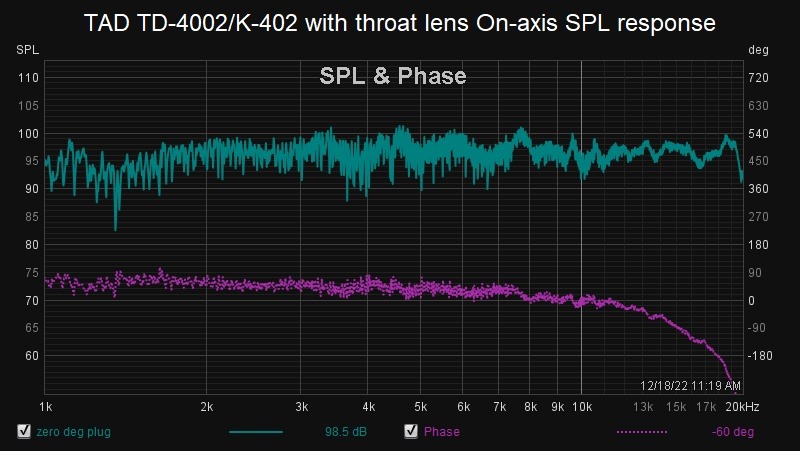

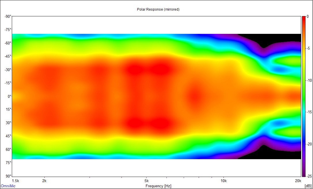

The following polar sonogram was generated using OmniMic from FRD files taken from REW measurements of a TAD TD-4002 on a K-402 horn in the horizontal axis at 10 degree increments. (Some here might know that the TD-4002 has a "snout" that increases the throat diameter from 1.5 to 2 inches, thus increasing the distance of the acoustic center of the driver to the horn's throat entrance. The effect of this lengthening of the distance of the driver's throat entrance is to increase the beaming of high frequencies above 6.8 kHz without a corrective lens. )
Below, you will see the polar coverage out to ~14 kHz before the beaming becomes dominant subjectively (which BTW was the advertised performance of the throat lens by the guy that came up with the device). This increase in polar coverage between 6.8 kHz and ~14 kHz places the TAD TD-4002/K-402 on par with a good 1" driver on a 1" horn--without said lens.
Here is the on-axis SPL and phase plot of those measurements (no smoothing):
and the total group delay and excess group delay of the same measurement (on-axis, no smoothing):
This increase of the polar coverage above 6.8 kHz is what I was subjectively reporting on. This is very audible and greatly increases the subjective performance of the loudspeakers, especially listening off-axis while walking from side wall to side wall in my listening room.
I've got these throat diverging lenses in my front three loudspeaker array (i.e., TD-4002 Jubilees left and right front corners, bi-amped BMS 4592 ND K-402-MEH in the center location--in my 5.2 loudspeaker array setup).
Chris
