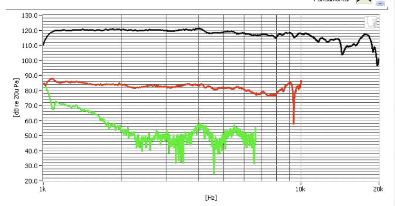

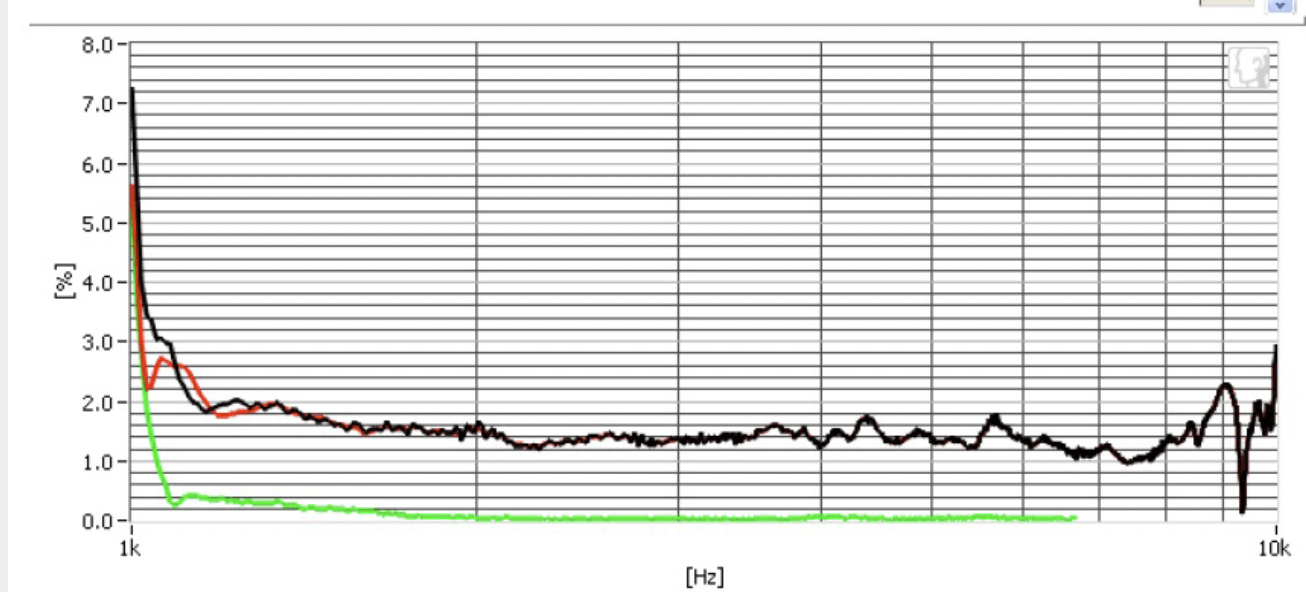

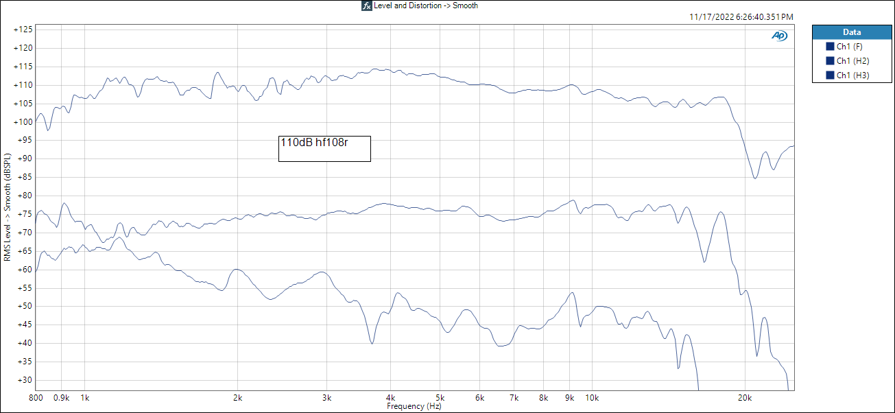

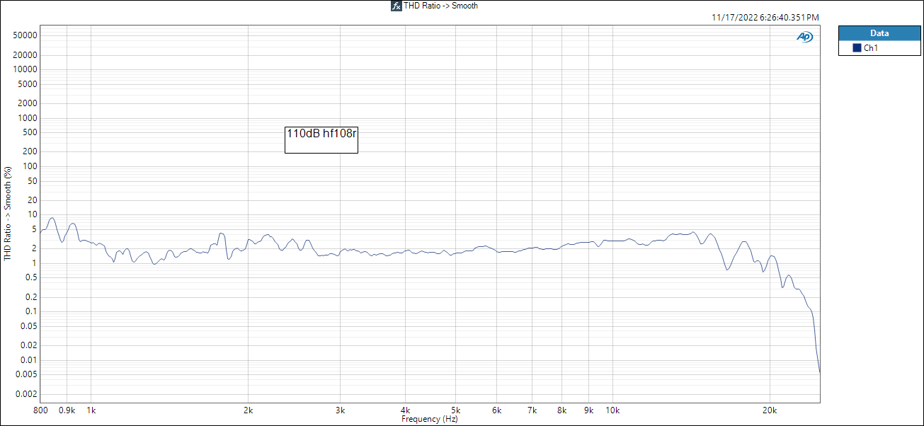

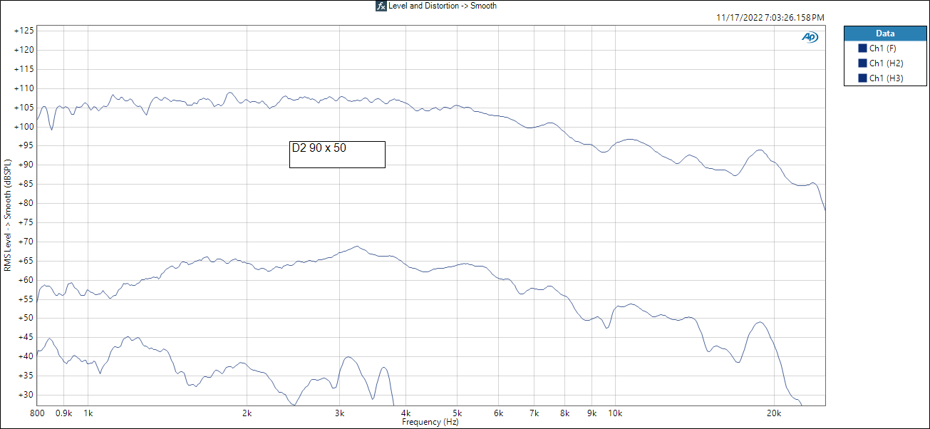

The speaker was still on the bench.

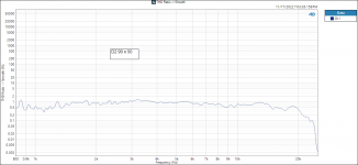

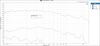

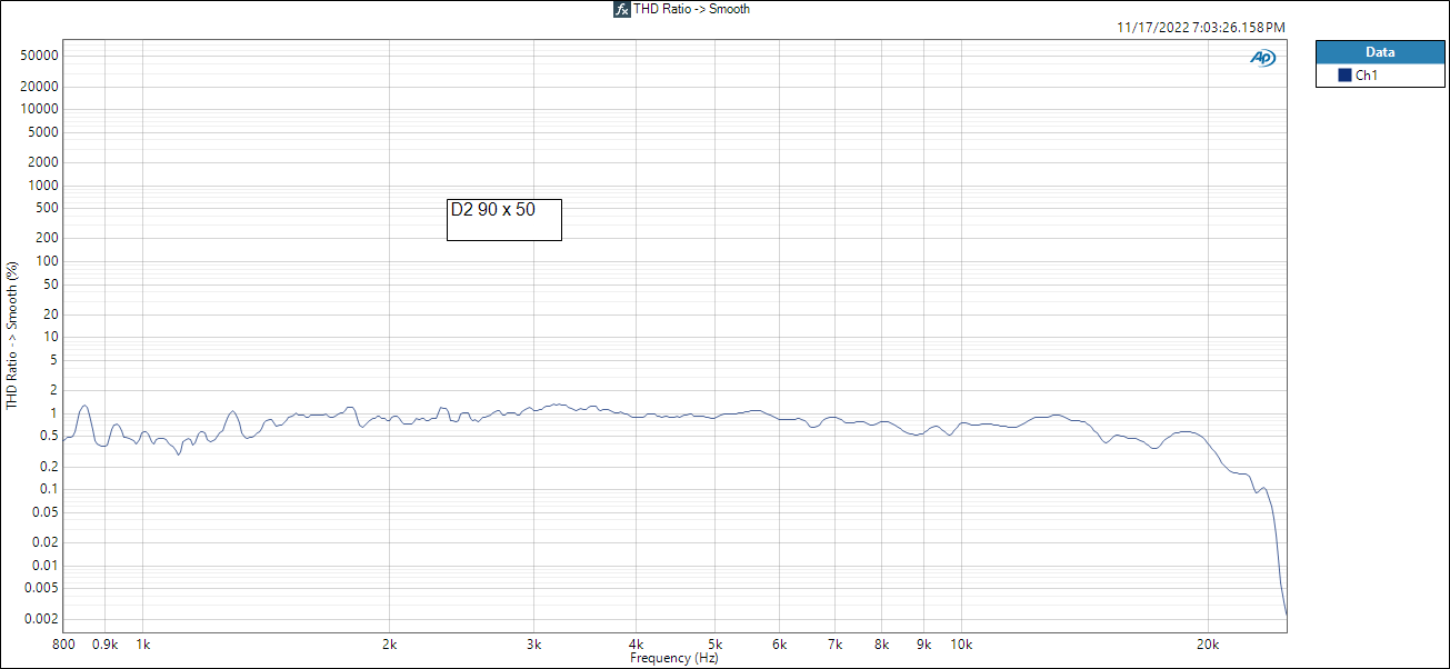

Microphone was moved to about 1 yard to 1 meter away from the mouth of the STH100.
The microphone and analyzer set to auto calibrate to 2.5khz at 110dbB. See the attached plots.
Note increased distortion. Still not too bad.
Thanks DT
![110dB hf108r Level and Distortion -_ Smooth.png 110dB hf108r Level and Distortion -_ Smooth.png](https://www.diyaudio.com/community/data/attachments/1018/1018577-e33313fca614c7dbdf1470b1ee043900.jpg)
![110dB hf108r THD Ratio -_ Smooth.PNG 110dB hf108r THD Ratio -_ Smooth.PNG](https://www.diyaudio.com/community/data/attachments/1018/1018578-f072d993df68c423557259d52e533956.jpg)

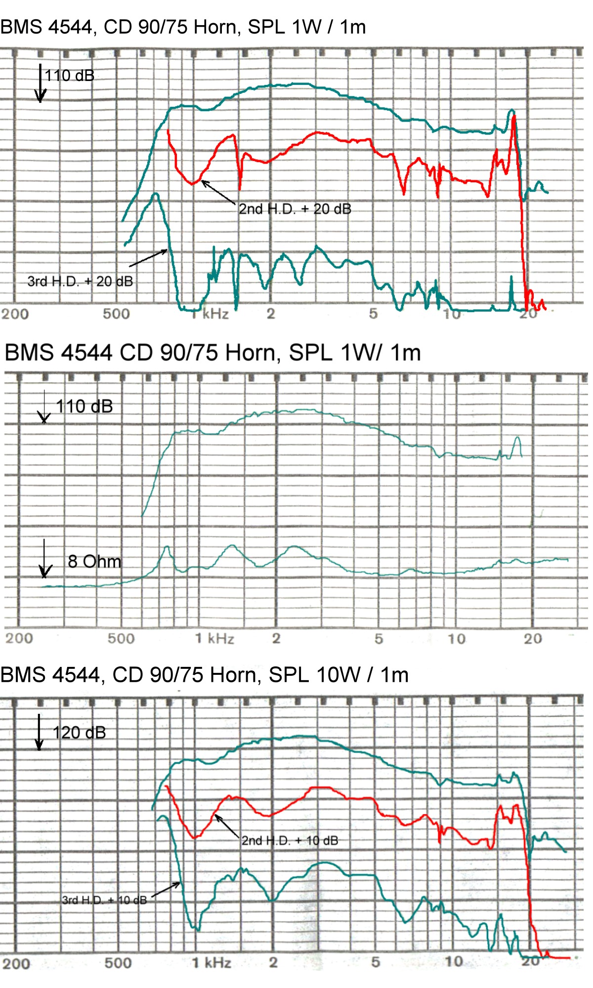

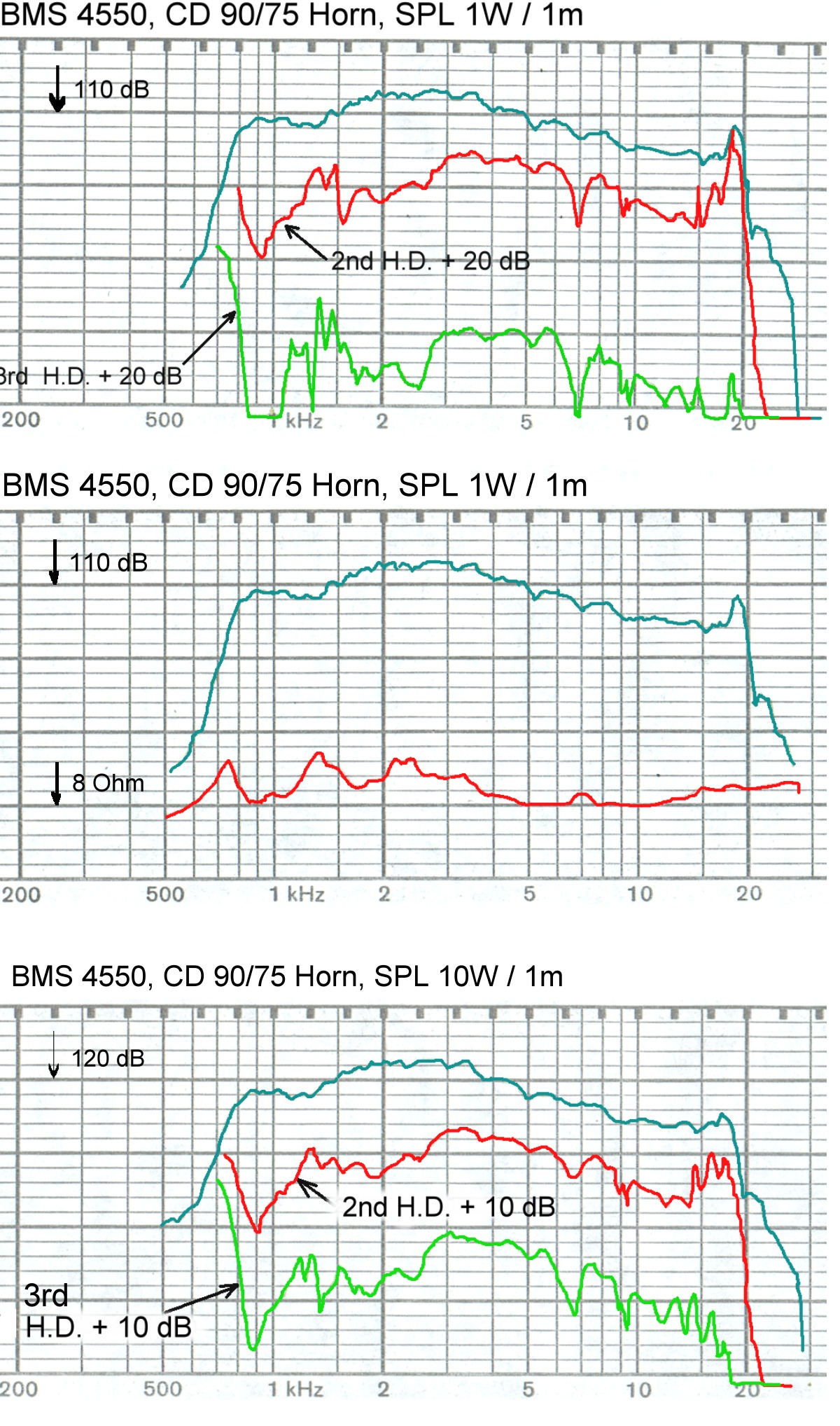

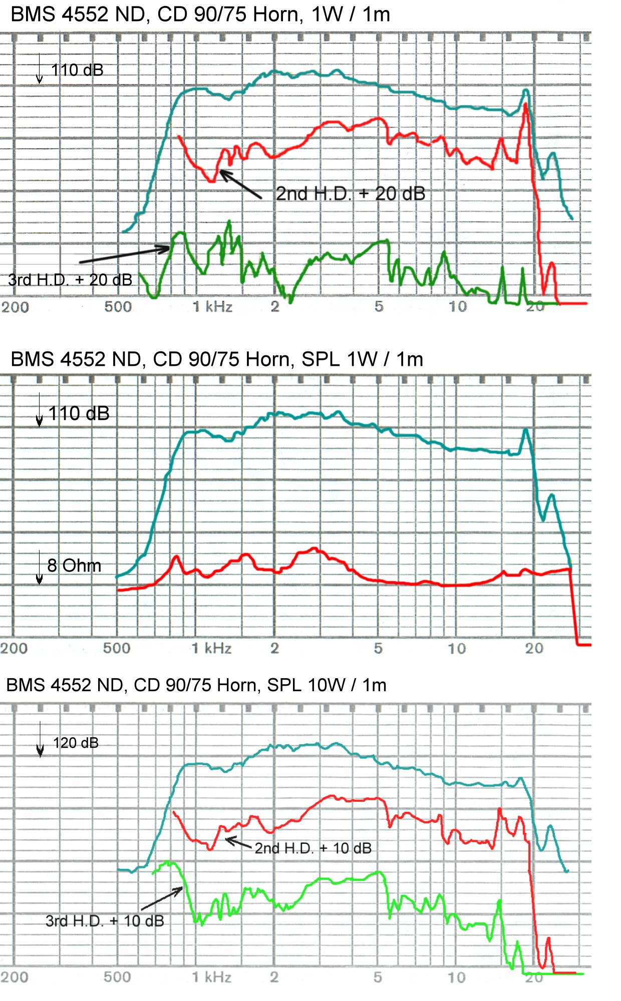

Hi milezone, others, have you tried BMS 4544? Its less than half the price of 4552ND or 4550 but seems to be closely related, main specs are about the same and graphs look almost identical. Some aftermaket replacement diaphragms list all these drivers like this one https://www.artsound.gr/product/aftermarket-bms-4550-diaphragm-for-yorkville-7402/While a quote rumor... the driver to test against would be the CP755ND in my opinion. I have a single extra one on hand which I plan to list here or ebay once I get around it. I think it would be worth your while to start there. I would look to drivers that are extended to 20khz only without eq and rule out the rest. Distortion occurs at various points in the higher frequencies depending on the diaphragm material which determines the frequency of breakup modes. This effects the performance of the driver on the whole and those which are more extended and least distorted at high frequencies will preform best.
Much less expensive than the CP755ND, the 1 inch Beyma CP380M is supposedly quite good. I am curious to hear your impressions if you ever do get around to comparing your HF10AKs with any other drivers.
Going after rumours, hard to resist cheap
