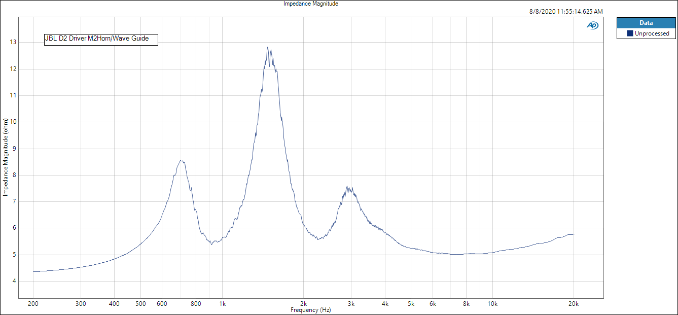

Speaking of your state of the art D2/M2, CD/Waveguide I have dissected the pair and measured it. CDs/horns and or waveguides are acoustic transformers, their impedance curves are reflected in a electrical impedance sweep. See the attached D2/M2 impedance plot below.
The impedance curve with 3 impedance peaks, count them is one of the least smooth or continuous impedance plots that I have measured.

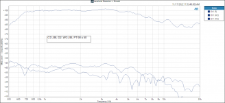

Hello,I read your post.
With what CD/Horn do you compare JBL 2123? Some real data?

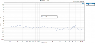

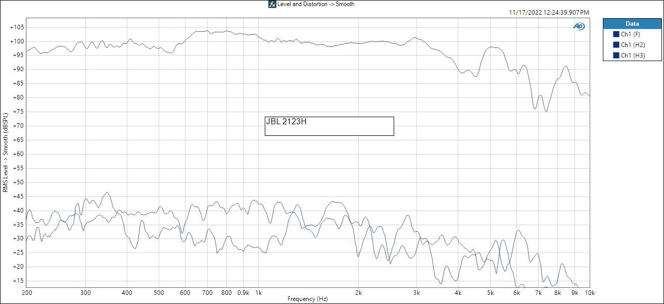

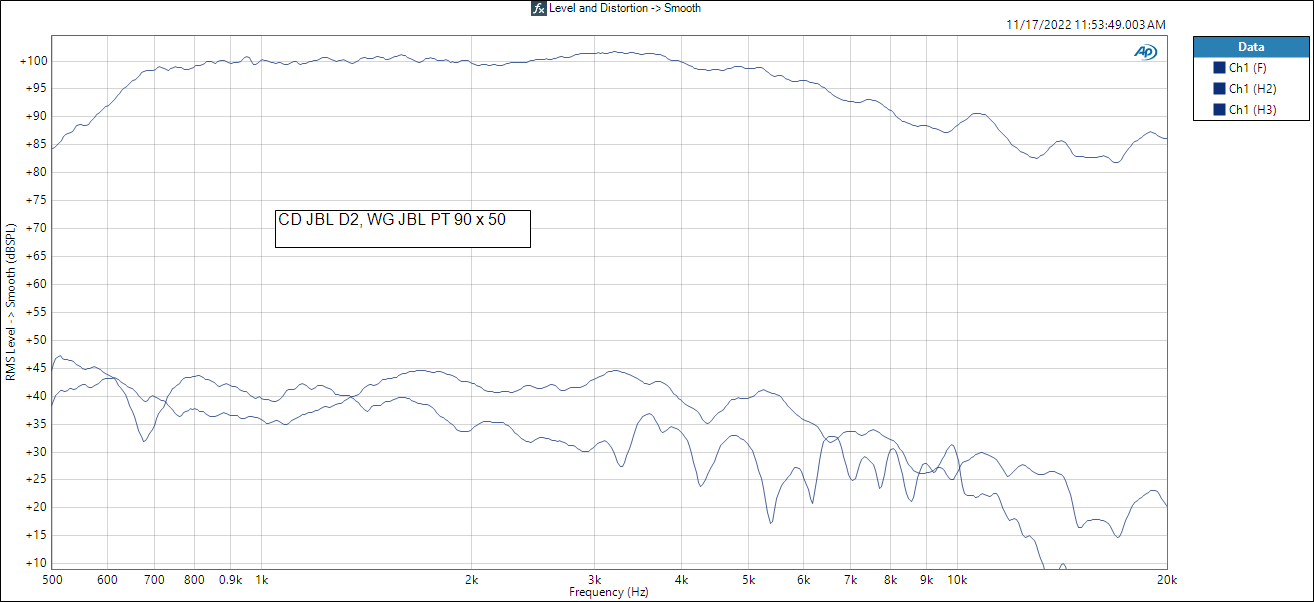

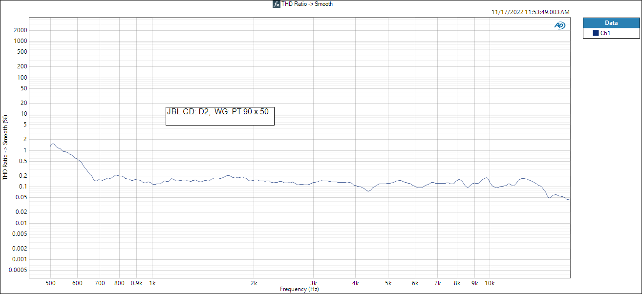

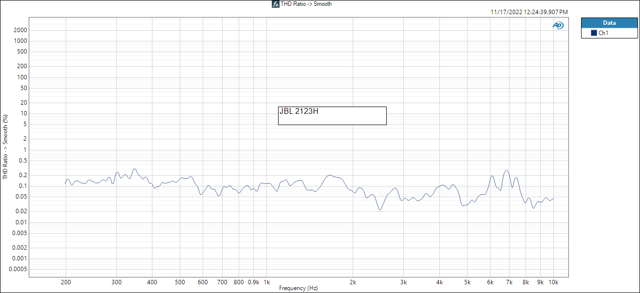

Real data.
See the attached plots for data a 1 foot distance from driver both at calibrated 100dB. This is about 90dB at 8 feet away from the speaker, kinda a medium loud listening level.
JBL2123H in 0.67 cubic foot test enclosure.
CD is JBL D2 as used in M2 speaker
WG is JBL for speaker STX825 (Progressive Transition 90 x 50)
https://reconingspeakers.com/products-page/jbl-horn-lens-5006815-stx825/
Note that the cone driver and CD/WG have different ratios of 2nd to 3rd HD's.
Thanks DT
If there is an interest I will also post plots for HF108/STH100 CD/WG.
![D2 PT 90 x 50 Level and Distortion -_ Smooth.png D2 PT 90 x 50 Level and Distortion -_ Smooth.png](https://www.diyaudio.com/community/data/attachments/1018/1018484-016b686fb3f57579b115425b31500ebd.jpg)
![JBL 2123H Level and Distortion -_ Smooth.PNG JBL 2123H Level and Distortion -_ Smooth.PNG](https://www.diyaudio.com/community/data/attachments/1018/1018485-abb456df0e4171a24af43d778b9c335e.jpg)
![JBL 2123H THD Ratio -_ Smooth.PNG JBL 2123H THD Ratio -_ Smooth.PNG](https://www.diyaudio.com/community/data/attachments/1018/1018486-1163b0c3452f395813bf912fdff63c15.jpg)
![JBL CD D2, WG PT 90 x 50 THD Ratio -_ Smooth.PNG JBL CD D2, WG PT 90 x 50 THD Ratio -_ Smooth.PNG](https://www.diyaudio.com/community/data/attachments/1018/1018487-64db02379eabdb00d3fcdce086590148.jpg)
Thank you!
But correct me if I am wrong: we have quite similar THD levels, lower 3rd in CD, which is better.
And you need a HF driver (with its own distortions) for JBL. (And crossover in sensitive region)
In M2 WG it's a chance for even better results for CD?
Thus it does not conclude:
This was predictable.Note that the cone driver and CD/WG have different ratios of 2nd to 3rd HD's.
Like it or not air compression is not linear and causes much higher 2nd and 3rd HD's

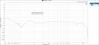

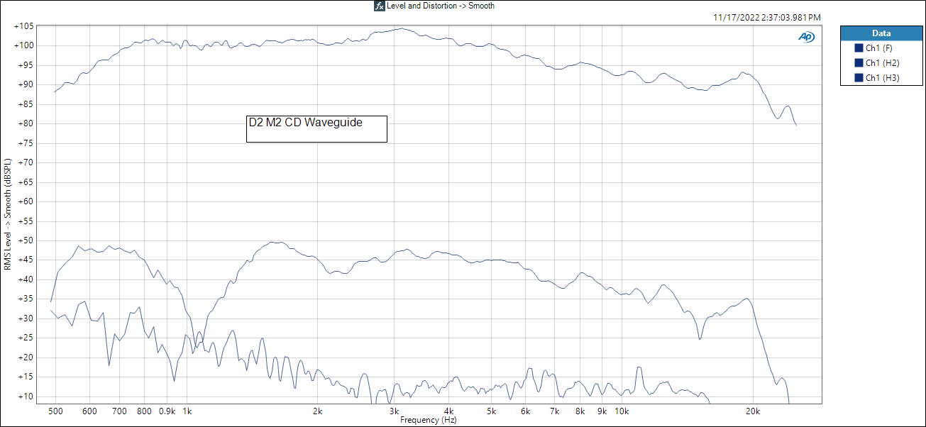

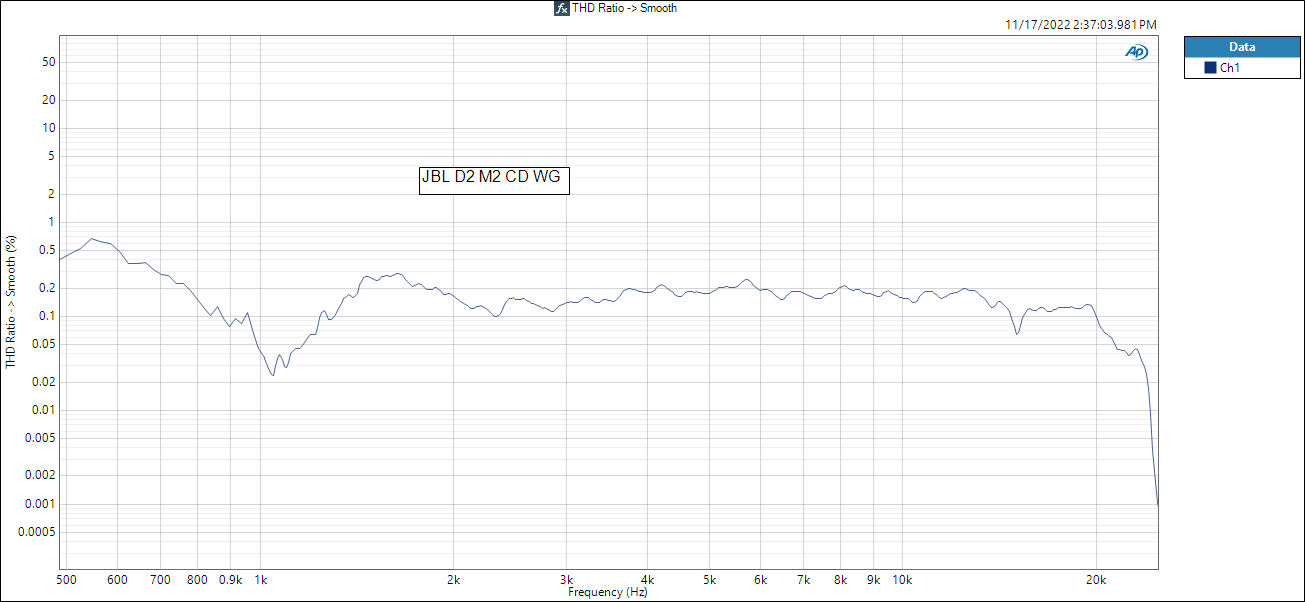

You asked what Cd was being used with the JBL 2123.
I showed you the D2 plots in reply.
The D2 is a special case with 2 diaphragms, not a good example of classic CD Compression distortion.
The M2 is huge, too large to use with the JBL 2123. In my thoughts.
See attached plots for the D2/M2.
Thanks DT
![D2 M2Level and Distortion -_ Smooth.png D2 M2Level and Distortion -_ Smooth.png](https://www.diyaudio.com/community/data/attachments/1018/1018523-10ad427d28412bba48e78ca1698f6ecc.jpg)
![JBL D2 M2 CD WG THD Ratio -_ Smooth.PNG JBL D2 M2 CD WG THD Ratio -_ Smooth.PNG](https://www.diyaudio.com/community/data/attachments/1018/1018524-cacbfd4a7d547218e1e6d4ab0e4c4756.jpg)

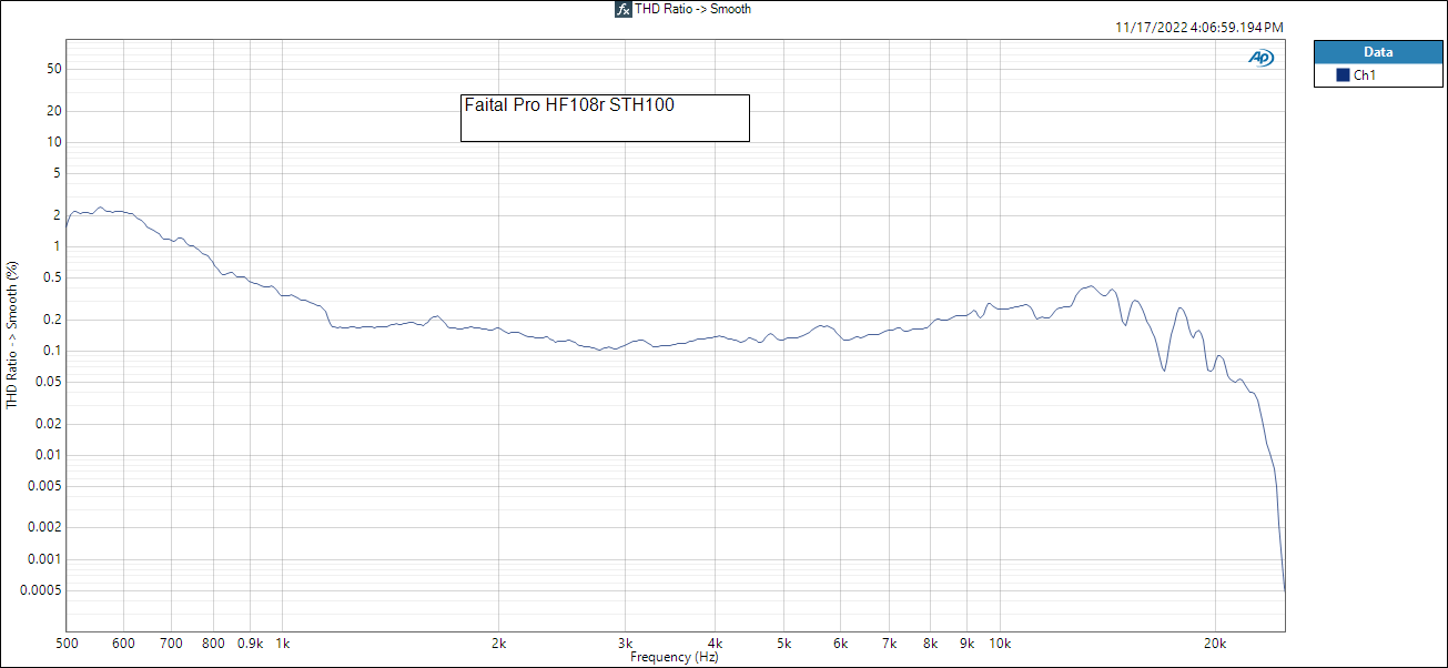

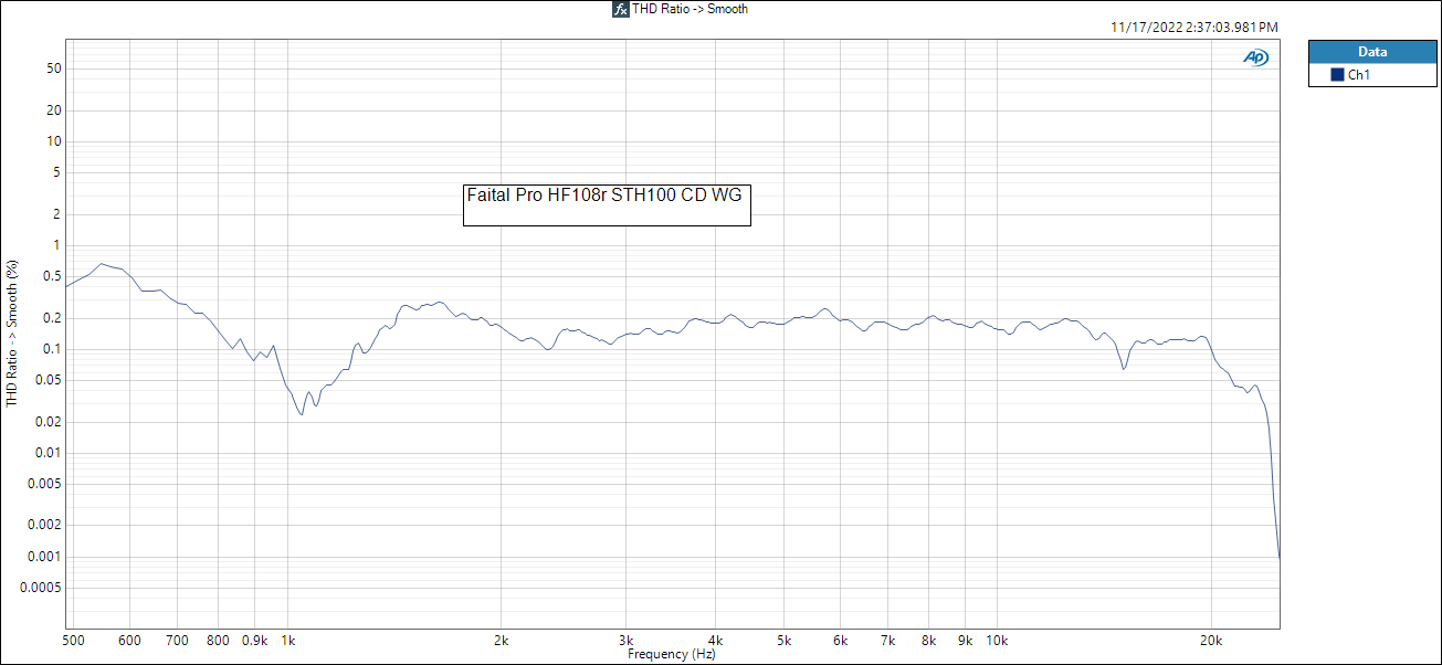

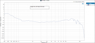

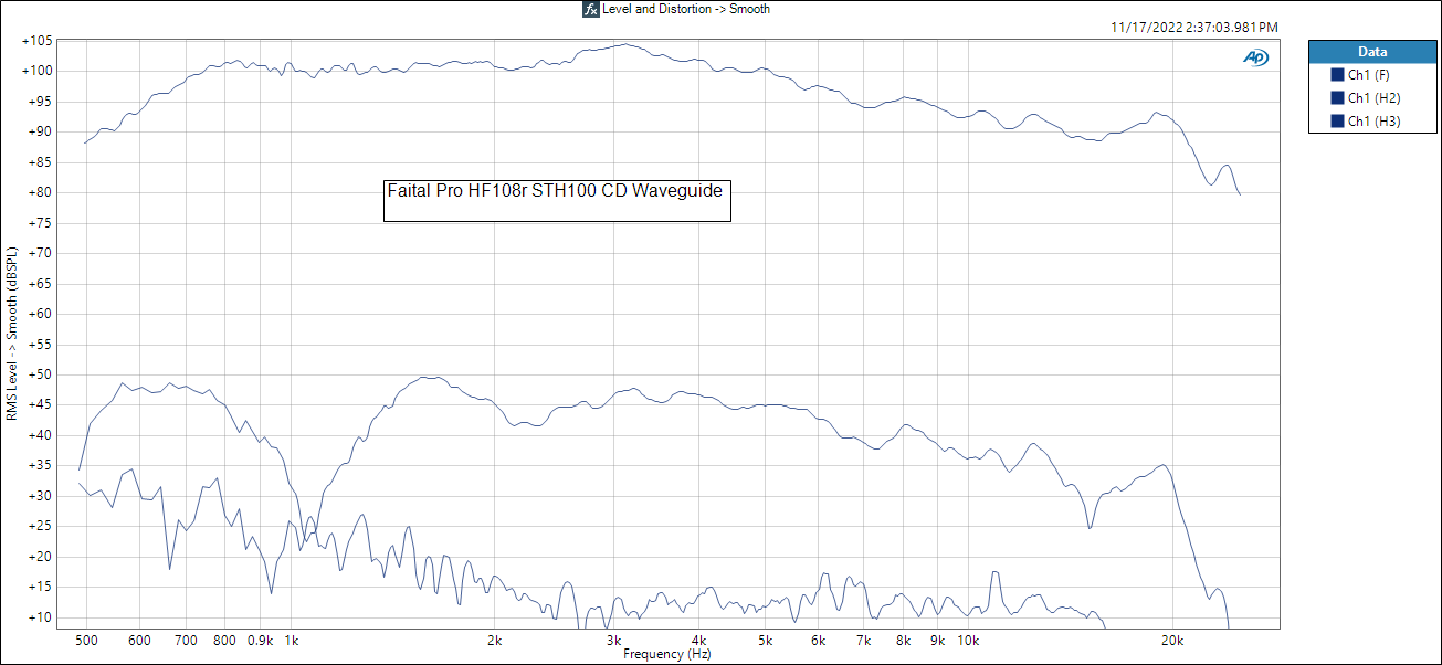

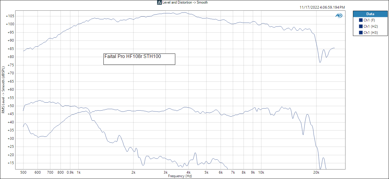

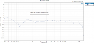

4th order electrical high pass at 500hz is good?Just for fun this the Faital Pro HF108r STH100 CD/WG.
Thanks DT
View attachment 1110620 View attachment 1110621
Looks like you reposted the D2 M2 plots or vice versa no?Just for fun this the Faital Pro HF108r STH100 CD/WG.
Thanks DT
