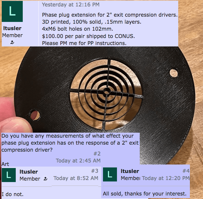

Roy Delgado's "phase plug extension horn throat diverging acoustic lens" depicted in post 205 is specifically designed with non-equal length passages to spread (diverge) the very high frequency waves into the Klipsch K-402 conic/tractrix horn.

I just found this:Chris,
Thanks for the picture, info and audio description!
Looks like the bug screen would have to be removed on the BMS 4592ND to fit the diverging lens.
Appears like ring 1 and 3 may have been designed to align with the Axi2050 phase plug rings.
What drivers are you currently using on the Jubilees?
Did you make polar measurements of the Jubilees with and without the lenses?
Art

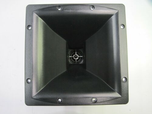

BTW: those lenses probably sold due to the pent up demand for a 2" compression driver lens--by those running K-402 horns currently--and there are well over 100 people running them in their home hi-fi systems. The K-402 horn didn't change in the latest Jubilee version--it's the same horn, but painted to improve the appearance.
