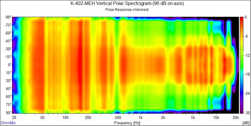

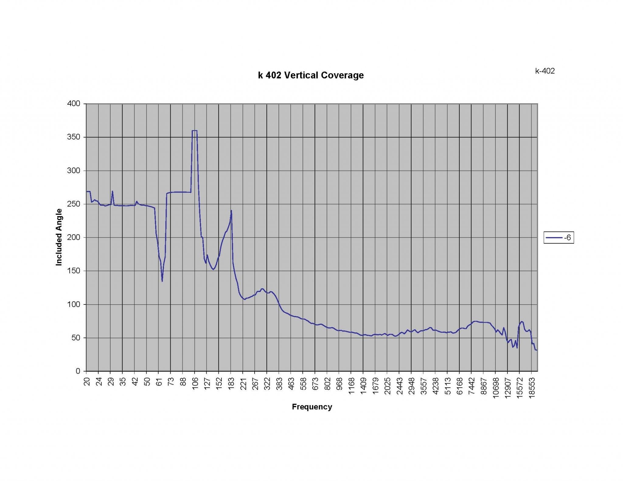

Do you have a vertical spectrogram (or equivalent) for the K402?
Non-normalized...

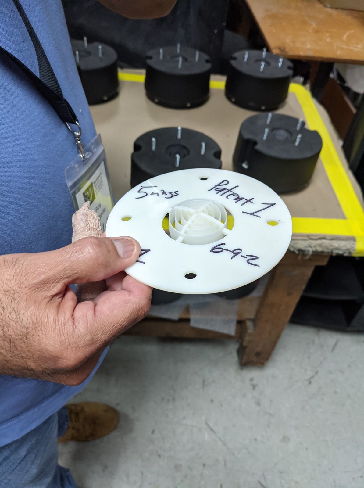

Does this K-402-MEH use the phase plug extension horn throat diverging acoustic lens?Non-normalized...
The convex exit plane of that lens is difficult to see in any photos I've come across so far, do you have any photos of the lens independent from the K-402 horn?
Art,
No. That series of measurements that I posted above were with a cheap P.Audio BM-D750 (series I) 2" driver with a modified phase plug (slightly closer to the diaphragm)--taken about 7 years ago (2016).
I currently use a BMS 4592ND (with bi-amped/time aligned diaphragms) and intend to add a post phase plug diverging lens to spread the polar above 6-7 kHz. I currently use these lenses in the Jubilees on either side of my K-402-MEH center, and they work very well. I'd say they were most audible when I stand up and move around, as well as provide a more realistic high frequency decay/background "acoustic bokeh". It's a bit difficult to express how the lenses really sound, but I haven't had a need to remove them since I put them in last year.
Chris
Chris,I currently use these lenses in the Jubilees on either side of my K-402-MEH center, and they work very well.
Thanks for the picture, info and audio description!
Looks like the bug screen would have to be removed on the BMS 4592ND to fit the diverging lens.
Appears like ring 1 and 3 may have been designed to align with the Axi2050 phase plug rings.

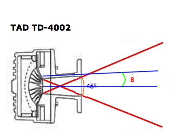

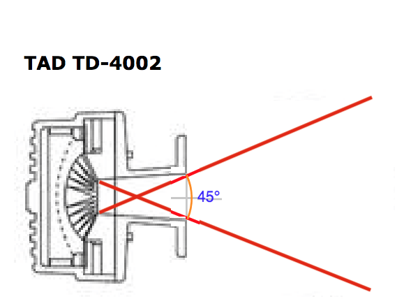

The P.Audio BM-D750 or BMS 4592ND don't have the long conical throat extension like the TAD TD-4002s.
I'd think the change using the lenses on either of those drivers would be less apparent than on the TD-4002.
Drivers with a flare rate like the TD-4002 effectively have a "built in" narrow VHF horn.
Art

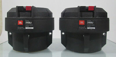

How do you get this CD? You buy separately CD and diaphragm?
Any link for diaphragm?
Regards Greg
No, that's not how it works. Imagine a straight tube - its length is irrelevant for the radiation pattern.Is that how exit angle is measured?
It was a retorical questionNo, that's not how it works. Imagine a straight tube - its length is irrelevant for the radiation pattern.

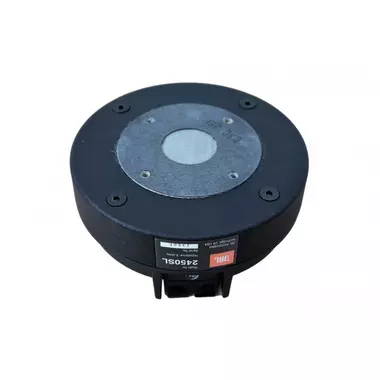

I find the 4002 sounds /measures best without the snout used as a 1.5" driver.
Same goes for the JBL2450, the aquaplas 2450SL (snout less 2450) is pretty nice, sounds like the TAD 4002 but less up front and smoother midrange. The JBL 2450 2" exit with Be was the lesser of the three in smaller horns like 300Hz tractrix or EV Great White Whale horns.. but is best when loaded in my monster 150Hz horns.

The CD can be had used all over the place, ebay is one example. The diaphragm is from Radian and can be bought from for instance US speakers. The 2451 has an odd bolt pattern of 114mm and some used ones have been modified to fit standard horns but i dont like buying stuff that somone have messed with so i recommend that one adapts the horn to fit the CD.
//Anders

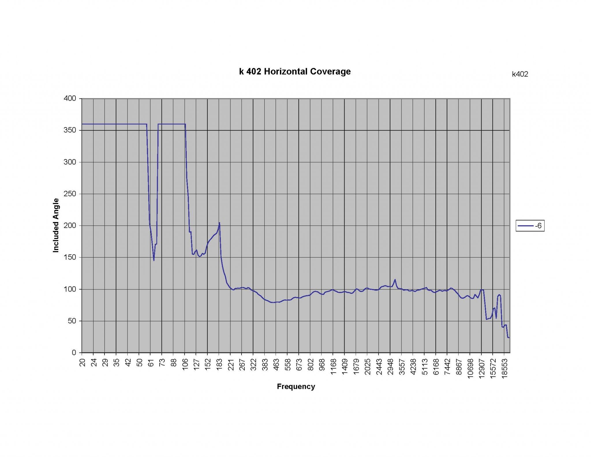

No, I believe that you read the polar sonogram not very well. Try the following -6 dB anechoic plot (vertical first):Thanks 👍
Very well controlled it seams.
Shame it widens pattern at over 600hz. If it got to 500 or so I would have used it on its side.
Then horizontal:
Chris

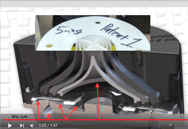

Rob,Here is a good look at the Coherent Wave Phase Plug used in the 2451. The phase plugs ends at the screen and functions like the above "lens"
Rob![]()
The JBL "Coherent Wave™" phasing plug structure uses four equal length passages to provide in-phase summation of the diaphragm's output, in other words, a plane wave. It is designed for use with the 235X series of Bi-Radial diffraction horns.
Roy Delgado's "phase plug extension horn throat diverging acoustic lens" depicted in post 205 is specifically designed with non-equal length passages to spread (diverge) the very high frequency waves into the Klipsch K-402 conic/tractrix horn.
