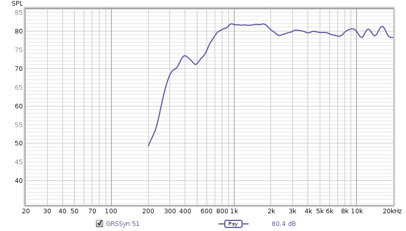

This is a measurement of the CP755Nd on my monster ES horn at random level and 0.5 m distance (inroom, therefore Psy smoothed). It is an exceptionally flat response.

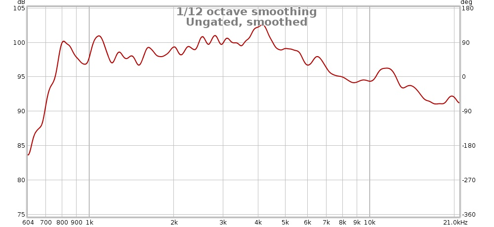

Just for comparison, BC DE500 on a smaller version of the ES horn:
Different scale and smoothing, but the downwards slope above 4k is clearly visible. I am not sure where this comes from, maybe my pair is just not perfectly OK. There is nothing like that to be seen in the datasheet.
Ideal constant directivity waveguide makes 6db/octave slope. Put small capacitor to make 1st order (6db) highpass filter somewhere +10kHz to compensate.

Constant directivity waveguide (conical Synergy) is even worse drop. The ES horn is more close to an exponential horn with rising DI. There was a drop of 13 dB in the Runt clone synergy horn between 5k and 10k that is +- 6 dB more than for the ES horn - which is the compensation for constant directivity. I have two of these and they behave the same way, which is really strange and that is why I do not think they are fully OK.

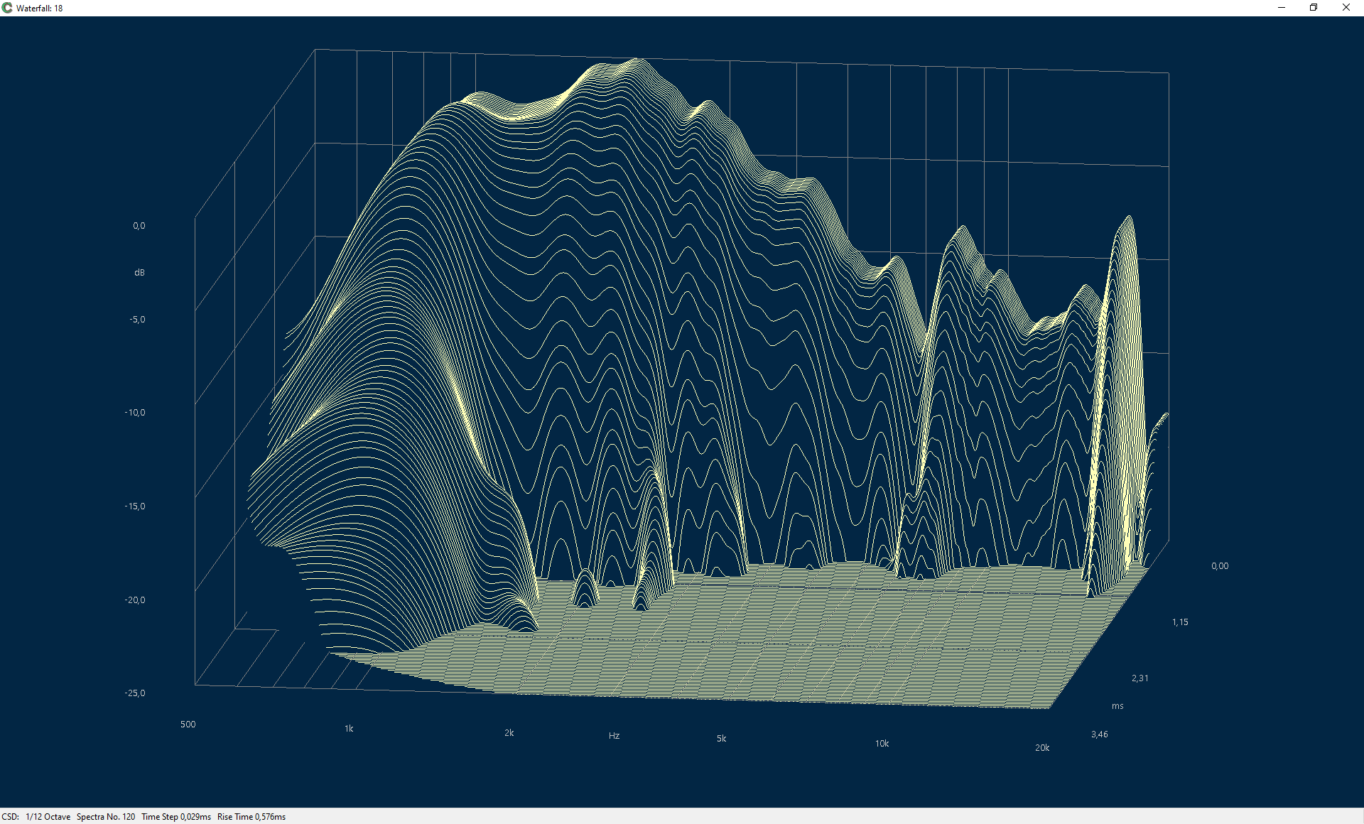

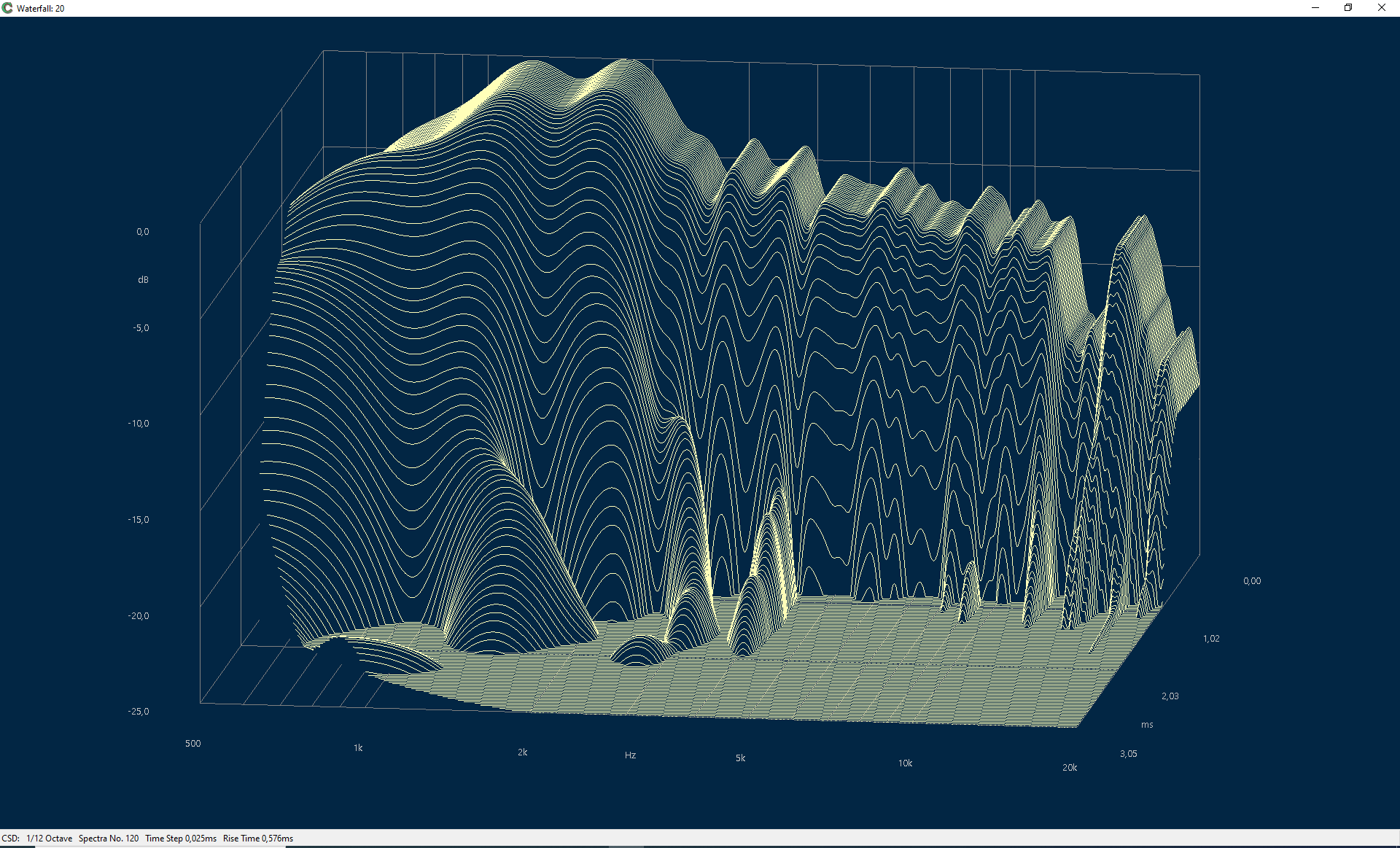

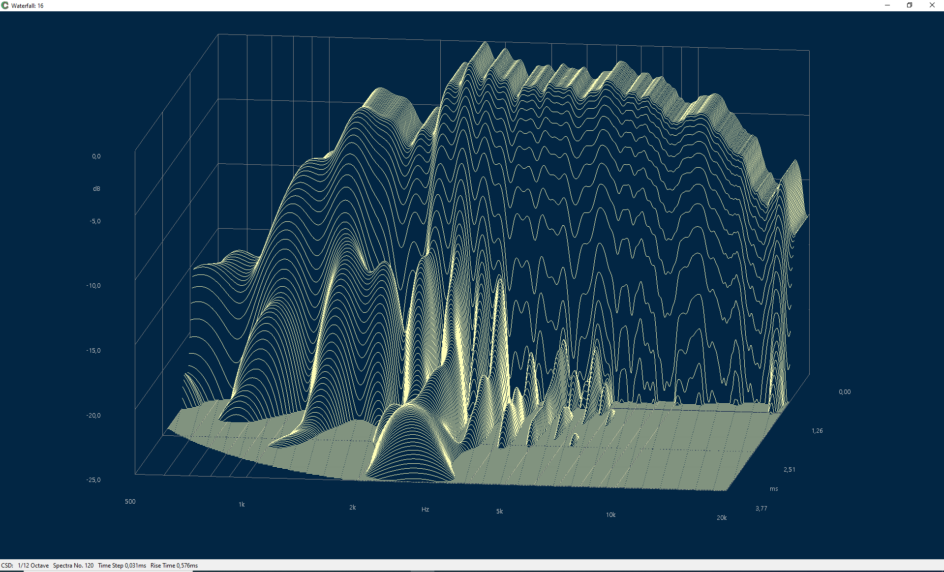

Ladies and gentlemen!
I have adopted the view of the waterfall used by a well known german DIY audio journal Klang + Ton
Visaton DR45N + Visaton HT21

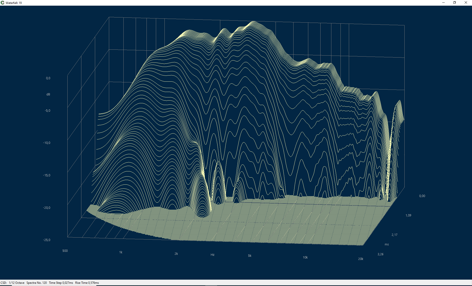

Eighteensound NSD1480N + Eighteensound XT1464 horn
Eighteensound NSD1095N + Eighteensound XT1086 horn
Eighteensound NSD1095N + LMH sTrak 4.5 inch wooden horn
the real interesting thing will be the measurement of the NSD1480N mounted on the LMH sTrak 16 inch wooden horn that will arrive soon to me
Took quick read what actually makes the slope with constant directivity waveguides and actually, nothing :D The drivers response comes through as is, it is same to all directions. Rising DI (not constant directivity) waveguide would "boost" the driver response on axis as radiation concentrates there with rising frequency.
I guess we tend to compare our system response to datasheet curves. The impression is made as we look the datasheet response and if our own waveguide is more constant directivity the response slopes in comparison. If it is less then it rises (compared to datasheet). If the datasheet curve was made with really beaming device one could have more than 6db/octave slope with constant directivity waveguide? In the end it is the same driver we just look the graphs measured with various waveguides which more or less "boost" the highs. Not considering problems here like diffraction and possible reflections on sudden impedance changes which would add their effect on top.

The measurement in the datasheet for DE500 is from an exponential horn (ME-45 https://www.bcspeakers.com/en/products/horn/1-0/0/me45), so I would expect it to look similar on the ES horn. The Beyma is measured on TD-565 horn (https://www.beyma.de/fileadmin/seiten/download/pdf/Beyma_professional/TD565.pdf), which is supposedly constant directivity. I am slightly puzzled by this, since the ES is not really constant direrctivity, but is slowly narrowing. Iit would be more similar to this measurement by Joseph Crowe - this is his ES290:
It kind of corresponds to my quick and dirty measurements.
But nevertheless, I can say that my CP755Nd drivers are far superior to the DE500 pair I own - both in FR and quality of sound when equalized.

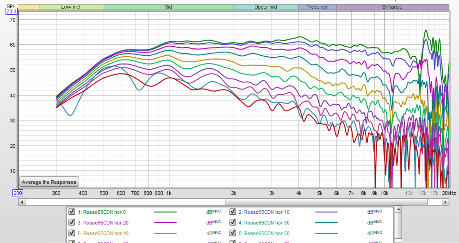

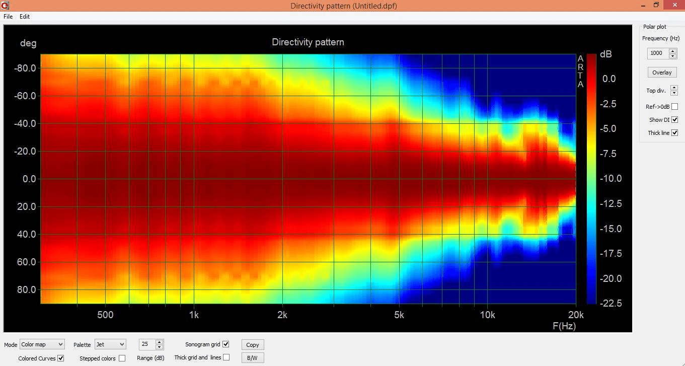

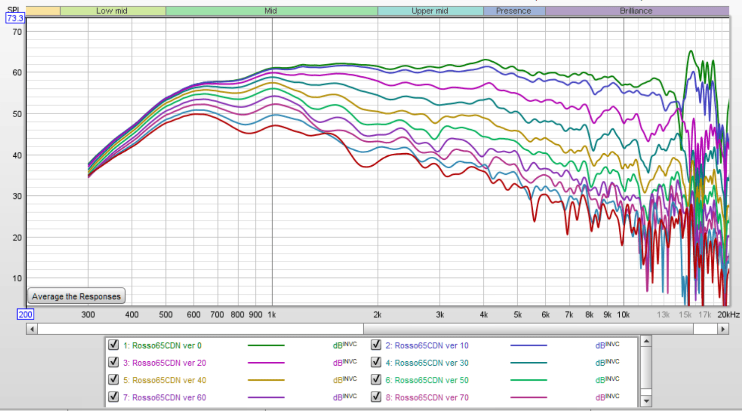

I really liked the Rosso65CDN-T compression driver (I haven't heard any other CDs though).
Here are the kind of measurements I got in a prototype build with the Rosso65CDN-T attached to a Faital pro LTH 142 horn.
Horizontal polars up to 90 degrees
Vertical polars up to 90degrees
