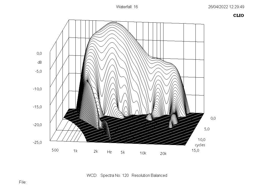

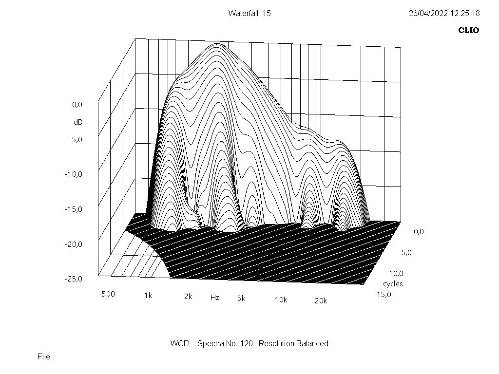

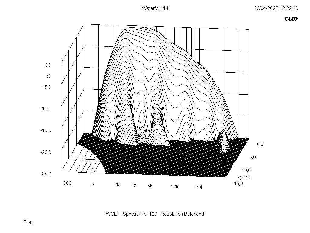

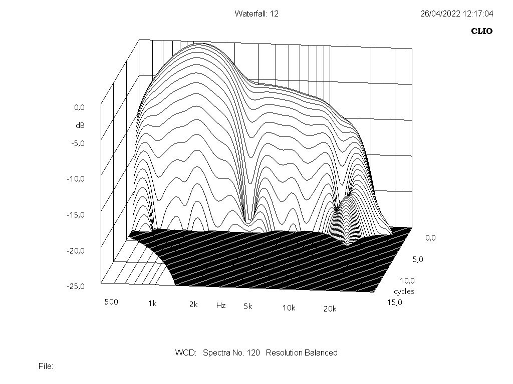

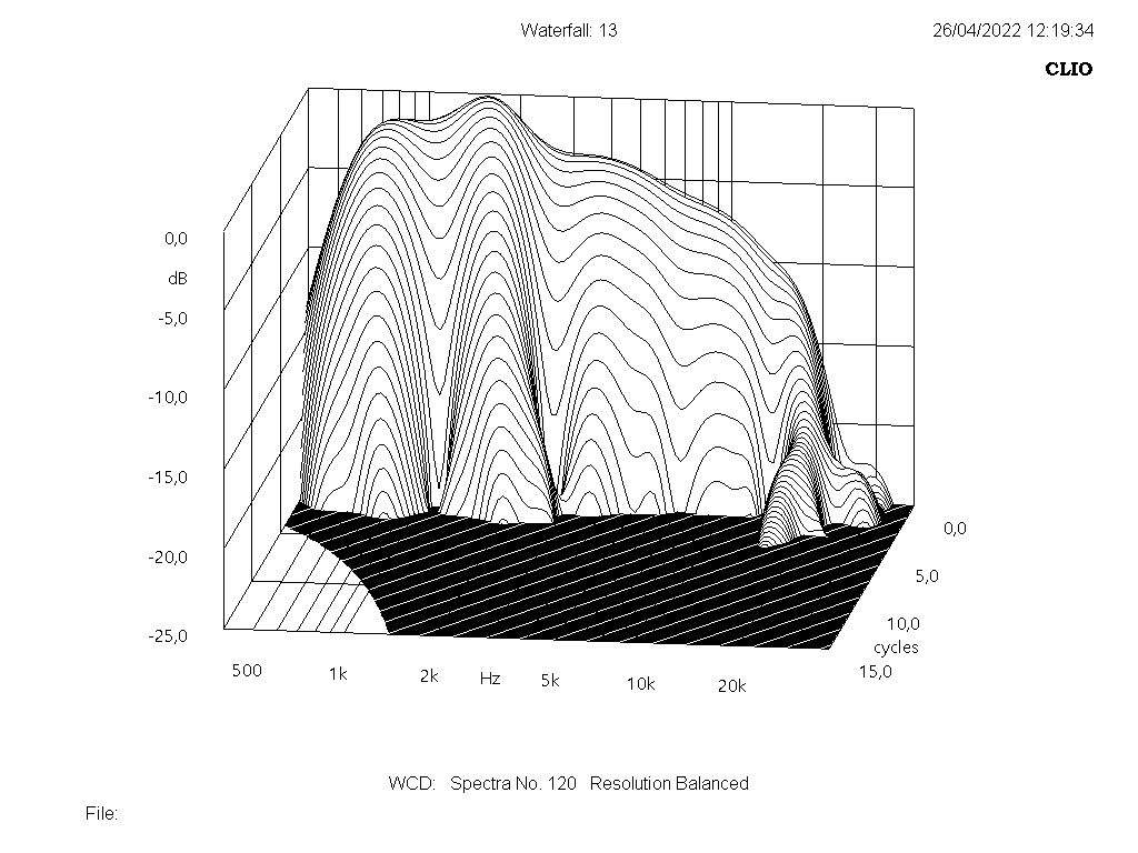

I have to make an additional comment about the CSD measurements with CLIO posted here from me. I have noticed afterwards that the CSD behavior under about 1200 Hz depends from the microphone distance. No good transient behavior with more than 8 inch or 20 cm distance, the room begins to make the difference and not the horn and the driver anymore. The frequency response over all on the other hand becomes less accurate when you come to close to the horn with the microphone.
After a good comment from the forum administrator of the VISATON forum here my latest findings for a good comparison of the quality of the driver horn combination. Waterfall diagram with wavelet cycle decay view and not the standard cumulative spectral decay view
1. Eighteensound 1095N driver Visaton HT21 horn 50 cm microphone distance horn shows to ceiling of 320 cm height
2. Visaton DR45N driver Eighteensound XT1086 horn 50 cm against ceiling like 1.
3. NSD1095N with 4,5 inch wooden horn nearfield 20 cm
4. 18sound NSD1480N 18sound XR1496 alu horn 20 cm nearfield
5. 18sound NSD1480N 18sound XT1464 elliptic horn nearfield 20 cm

Hello Pano, good question! I have taken the first answer to this from the CLIO pocket survival guide:
We might be interested in looking at resonances in terms of cycles instead of time. This will better highlight resonances at high frequency, where the CSD could not reveal such short time artifacts. In the Wavelet Cycle Decay the energy decay of a system is analyzed using Wavelet Analysis. The result can be interpreted as running a bank of constant Q band-pass filters and then looking at the energy decay for each calculated band. The results are then plotted using cycles instead of time. They do not explain in detail why the lines are diagonal, at least when the export to jpg is done. I have put a capture from the original view of the woodhorn WCD here:
