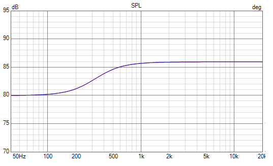

If you add a woofer that is near 6dB more sensitive then you can cross it in at the baffle frequency and it's done.
I'd like to use the same woofer for consistency. How do I calculate the baffle frequency? I'm curious enough to try it, have the extra drivers, and simple to make a new front baffle. Just need to calculate the right cutoff.

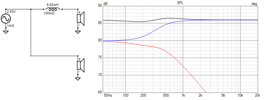

So it seems simpler to me why not add a second identical driver for -100Hz? That will reduce LF distortion and eliminate a bunch of the bass boost electronic stuff you mention.
You can do that, but its not that simple.
Bass rolloff starts around 200Hz and amount of boost required is more than 6dB which 2 drivers in parallel can give.
Passive 100Hz cut will be hard beacuse its close to drivers impedance peak.
But will I still need BSC?
Yes, if you want flat response.
I recommend you to cut the second driver higher, 1st order around 400Hz. Add a simple 3,9mH inductor in series. Nothing fancy, ferrite core is ok.
That should cover BSC.

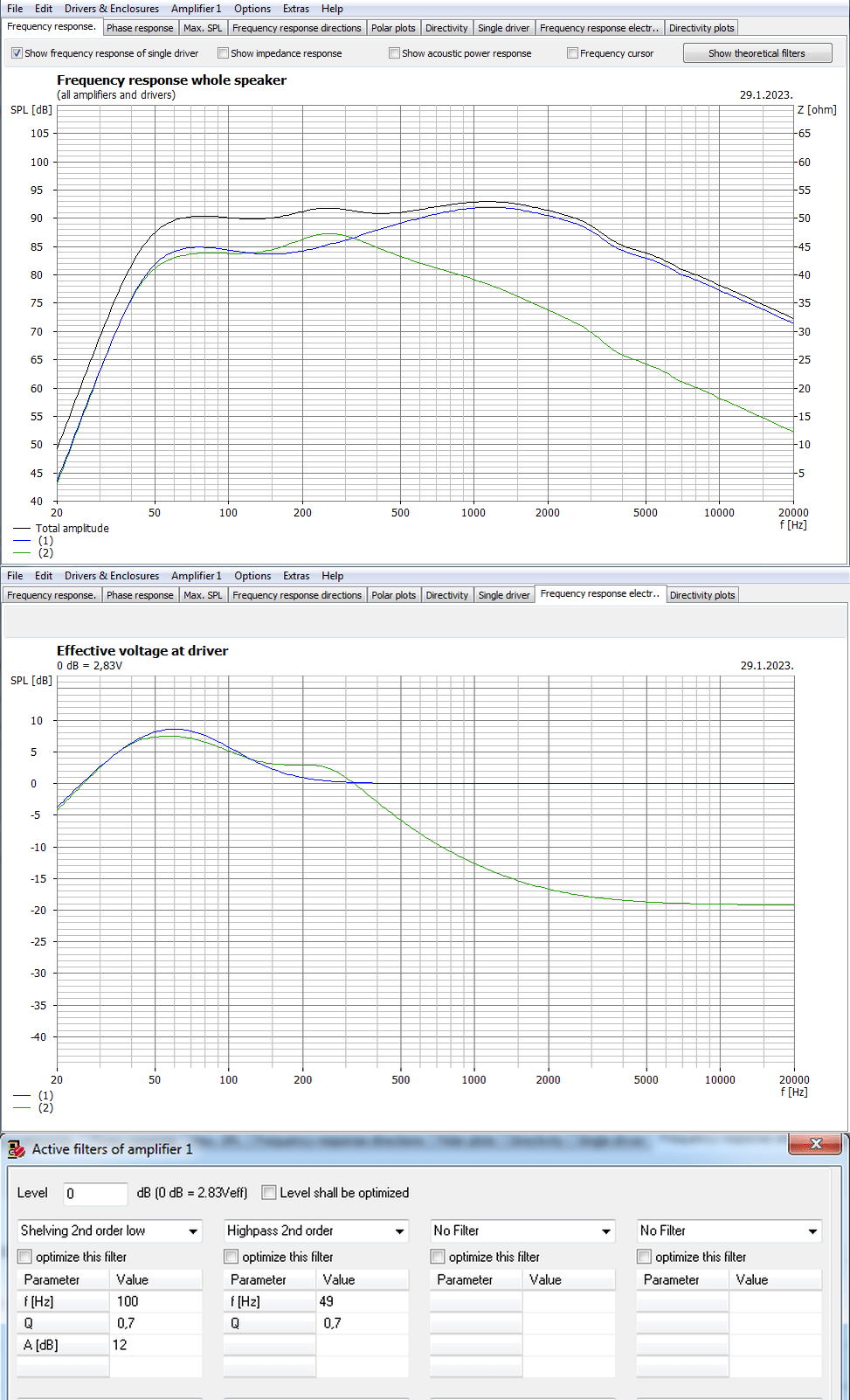

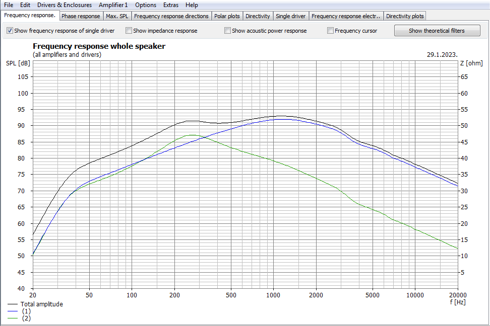

I made the sim to show the effect of 2 drivers working together to 400Hz. They share the same box, 7 Liters, Fb=42Hz.
I don't have measuring files for W4-616SA so its made with calculated response.
Bass rolloff below 200Hz is clearly visible, as in TB datasheet.
You'll still need good amount of active bass boost. To reduce that a bit, I recommend you to raise the Fb=49Hz (0,7xFs).
Than add LF boost shelf 2nd order, Q=0,7 , centered at 100Hz plus high-pass 2nd order at 49Hz.
Together, that gives 9dB of active boost with flat response and -6dB at 42Hz.
Drivers data don't show Xmax. Assuming 1,75mm max SPL is 90dB.

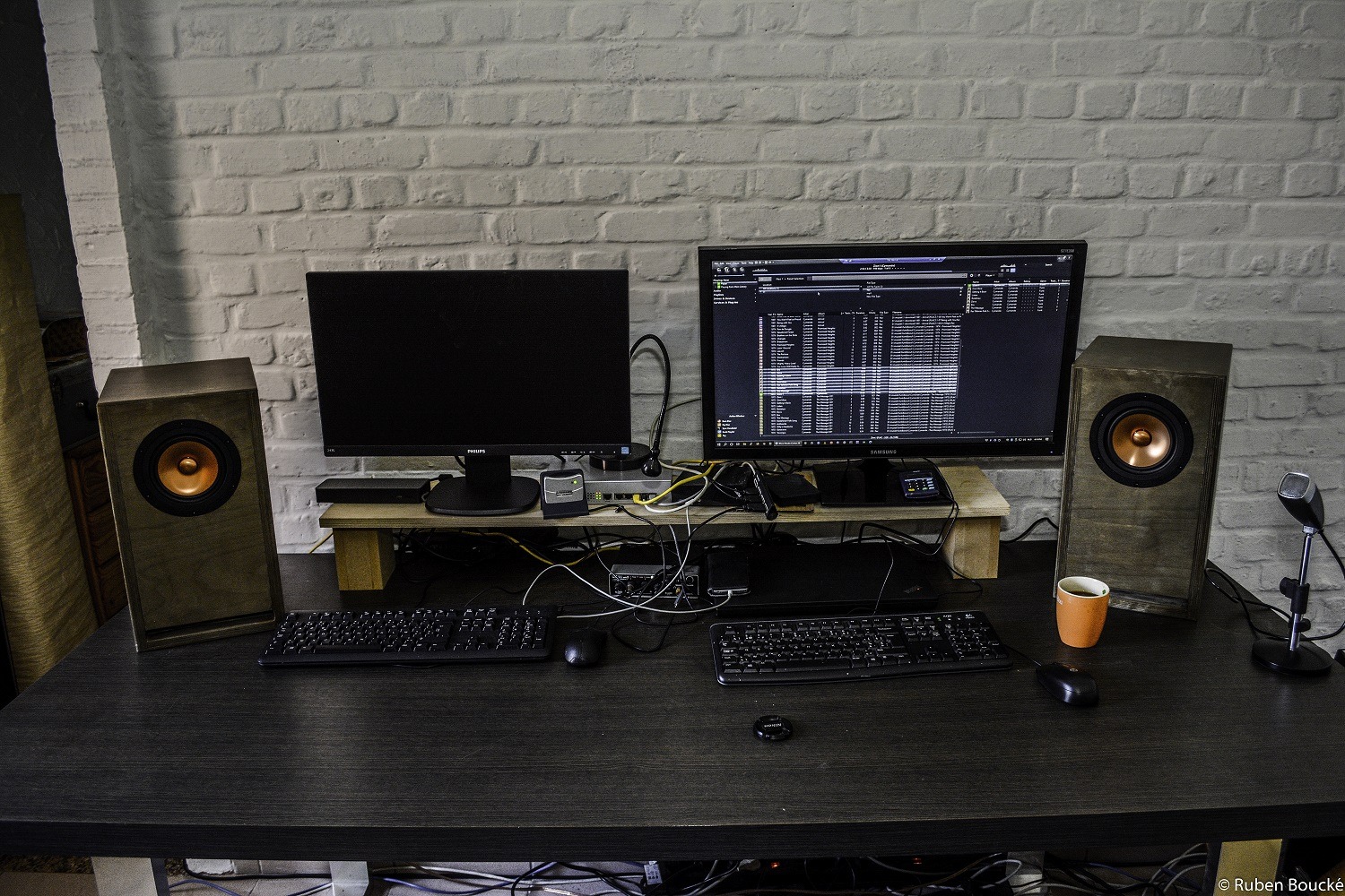

How about the Kartesian Kapella_4 build?
Yes, nice driver and looks very well thought out. The HF remind me of a full range floorstander using Fostex F120A (5" poly cone) or maybe was the F200A (8" poly cone). I remember thinking how rough the HF was and how a $10 tweeter would do much better.
Can't say if any other similar driver is better what with smoothing and all.......
