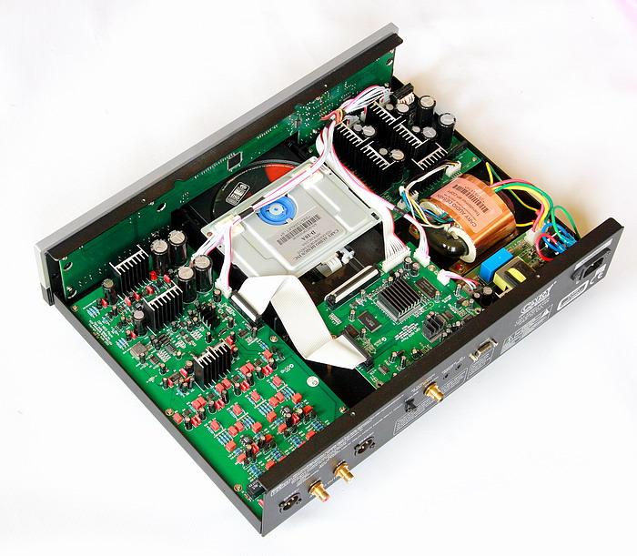

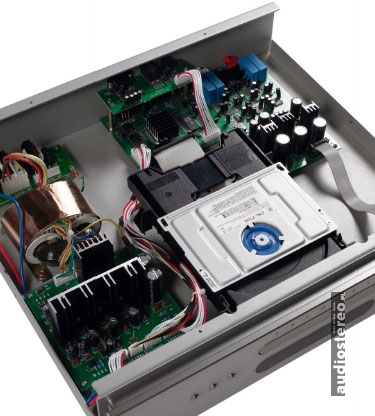

By looking to the dvd player devices from the good old high end companies like Primare, Naim Audio (DVD-5) and Meridian I often discover DVS Loader from
?????? WELCOM TO DVS KOREA ??????

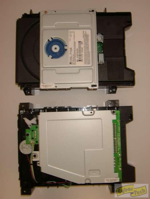

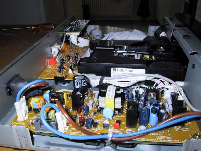

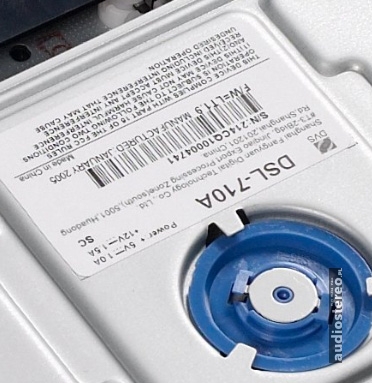

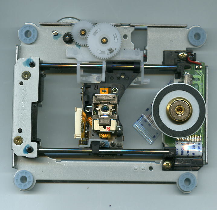

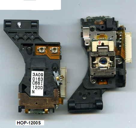

(mostly DSL710A/DSL-710A) and mechanism together with Hitachi's optical pick up HOPM-1200 versions.
What about this stuff concerning lifetime and reliability ?
Even by player "Only CD" this stuff is often inside.

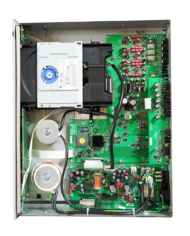

obviously, model DSL710A is also available in different versions - here an example without without metal enclosure (iron housing/sheet metal housing/shielding cabinet - I don't know the right english term)

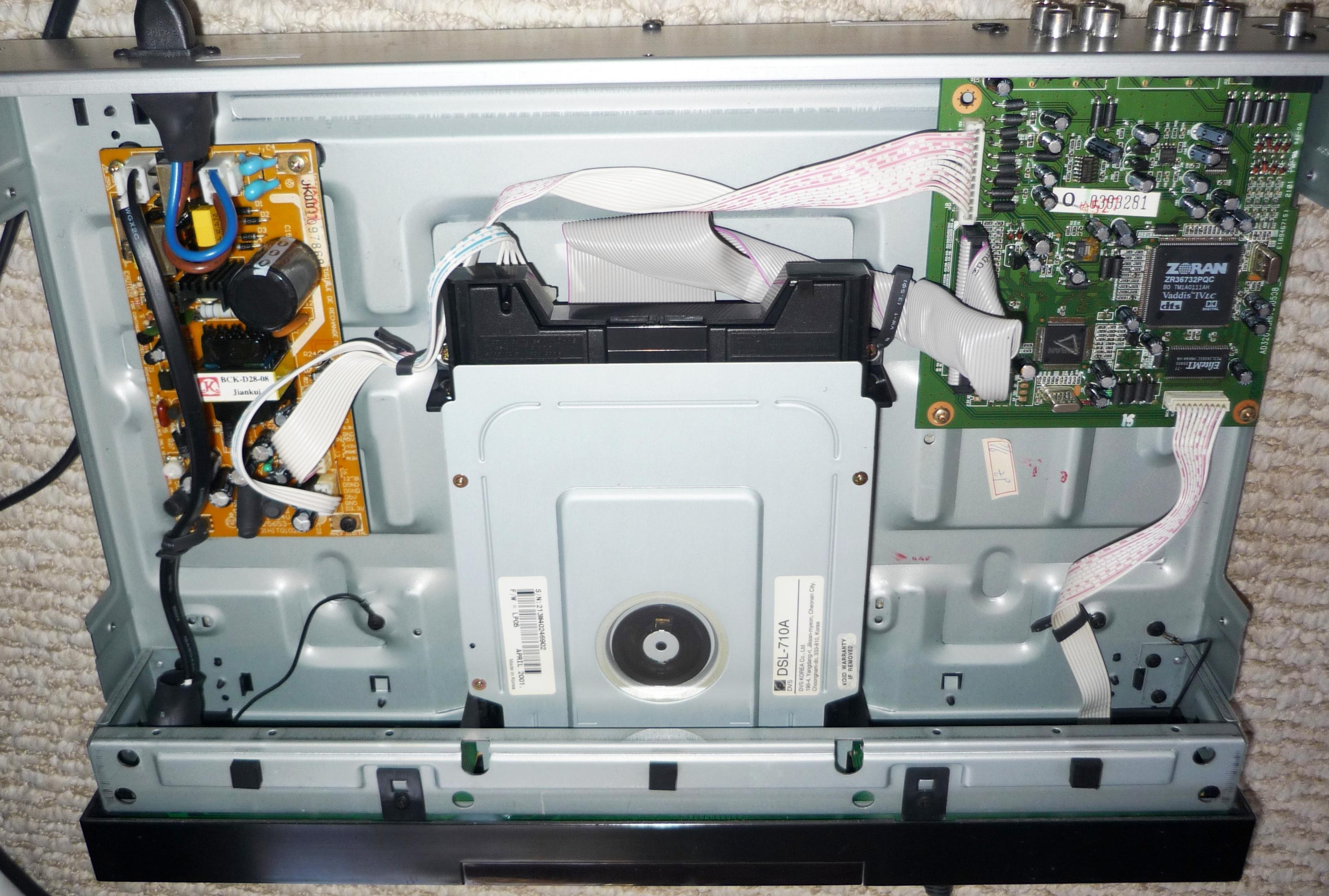

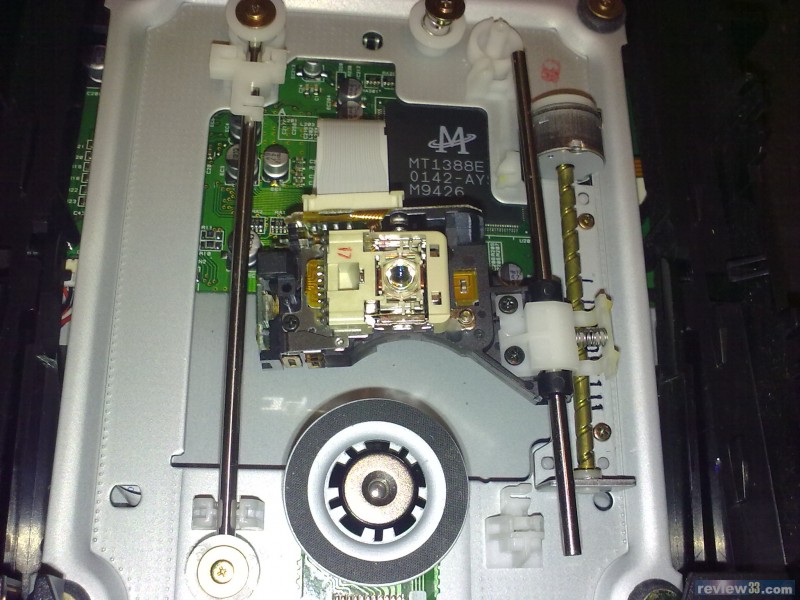

I have the DSL710 in an Apex AD-3201 (DVD/HDCD/CD/mp3) that I bought in 2000 - see below pic. Still works. Video cipset Zoran Vaddis IV, DAC BB PCM1745.

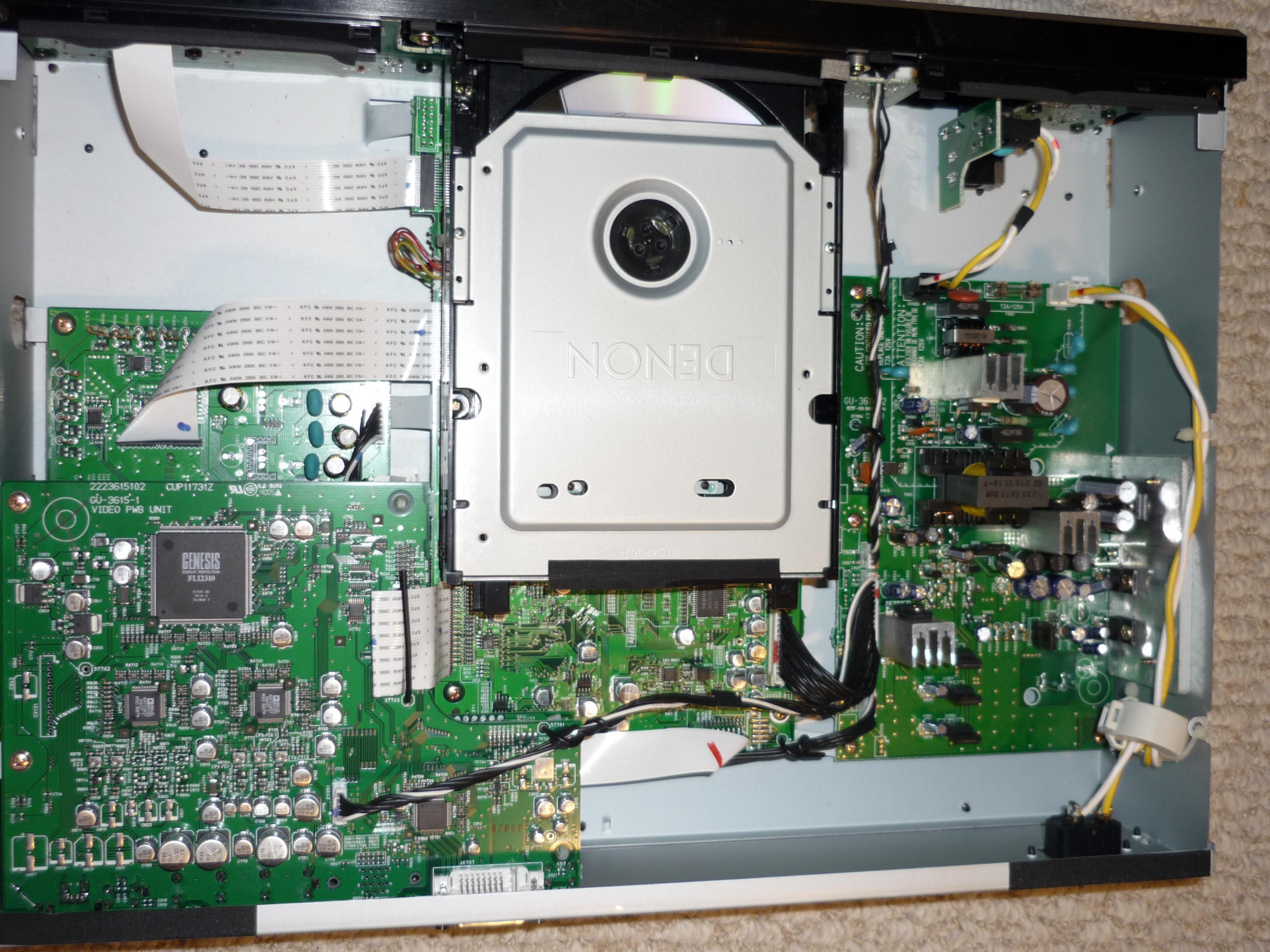

The same laser (HOP1200R) is found in the Denon 2910 that I was telling you about above (2005 and still working).
IT IS A MIRACLE when a DSL710 and anything else with a Hitachi dvd laser holds up for more than a year. The HOP1200 series is the most disastrously unreliable dvd laser I have yet seen, short of the 1st gen Panasonic VED0378. Worse, though, is that very often the drive electronics fail in the DSL710. It is pure garbage, and the only reason so many makers use it is it is CHEAP, just like the horrid CDM12 cd junk. Lasts usually long enough to make it through warranty, and after that, they just don't care. Denon, Rotel, Naim, etc., are perfectly happy to make money selling overpriced replacements, and don't seem to give a damn how much damage this practice does to their reputations.

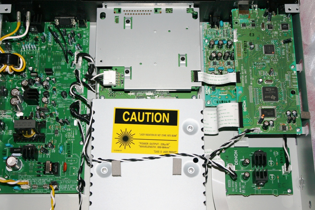

If you are curious, below are the Denon DVD-2910 and DVD-2930:
The DSL710 was used in Apex players in 2000 - I see them still working in the trift stores/cash converters in the area that I live, so mine in not really an exception.
I really think that, with the lasers, is more a issue with quality control - they are so cheam that don't test them in factory. They get tested in the players. If you get a good one, it will last.
The picture that I post above is for the Apex AD-3201, to show the DSL710. Denon does NOT have that unit, just the same laser.
PS: I don't sell nothing, just sharing my experience. And I only bought ONE player at full price in store - the Apex AD-3201. The rest from eBay or discounted (DVD-2930 was 160$ new at Vann's). I would never pay the full price asked for top of line components.
Sorry I maybe sounded a bit hostile there. It's just that when a company like Denon continues, over and over, to use lasers & mechs in expensive gear that they clearly KNOW is totally junk for reliability, it makes me really annoyed when people on here, even those that talk about how many times they've replaced their lasers, act like it's totally OK for a company to build things like that. Denon's first dvd unit used the disastrous VED0378, but this was forgivable, as it was too early to know how bad they would be. So they shift to the Hitachi/DSL in the 2900 series. Maybe they didn't know this would be 2nd worst choice possible, but they CLEARLY knew how bad the reliability was by the 2910, as I was Denon warranty at this time & replaced LOTS of hop1200's in warranty on 2900 series. This was nail-in-coffin time for Denon, as far as my respect for them. Then they shift to the very well known to be terrible SF-HD65, and that's when it became utterly and completely clear to me that they did not give a damn about the customers getting gear that could be counted on much past the warranty period. Hence, my rather seething contempt for what used to be a good company.
