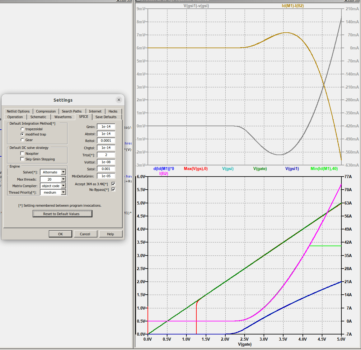

Thank you. It looks like these equations require the Spice iterative solver. I don't see a path to a closed form solution.
Here is an interesting additional plot from your test jig. It show the differences: V(gsi1)-V(gsi) and Id(M1)-I(B2).
I found it necessary to adjust various Spice tolerances to avoid differences in convergence between Vgate rising vs. falling.
Ignore I(B1) and I(B2) equations. You only need I(B3) and I(B4) which were almost explicit using Id(M1).Thank you. It looks like these equations require the Spice iterative solver. I don't see a path to a closed form solution.
Here's the updated exact equations:
Code:
Vgs=Vto + nVt*Ln(Exp((V(gsi)+Id(M1)*Rs)/nVt)-Exp(Id(M1)*Rs/nVt))
where
Vgsi=Sqrt(2*Id(M1)/(Kp*(1+Lambda*(V(d)-Id(M1)*(Rs+Rd)))))
Now I don't need a 0.5mR offset. It means the 0.5mR offset doesn't actually exist in reality as I thought.
