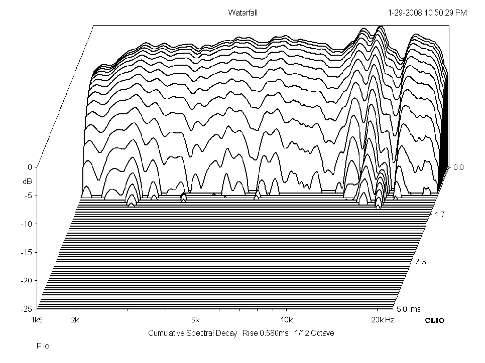

Second plot of the 2435
Rob🙂

The VT1010 waveguide looks a little weird but there's no arguing with the very impressive CSD plot you've posted for the 2435+VT1010 - frankly, the best I've ever seen for any horn system, from any vendor. That's an impulse response in the same league as very good direct-radiators - with the huge advantage of 20+ dB more headroom. I'm not thrilled about what's going on between 12~16 kHz, but I plan to use a supertweeter anyway, and gently roll off the medium-format compression driver with a lowpass network.

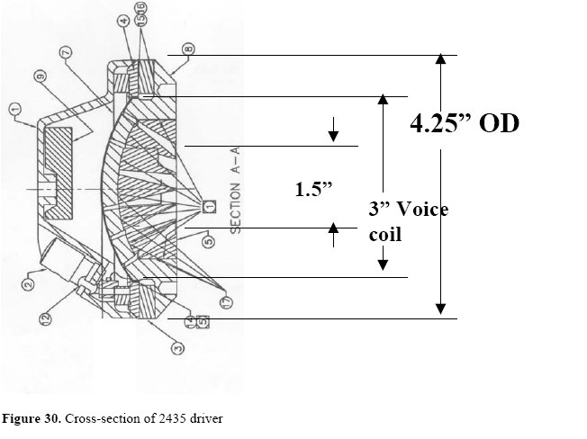

Attached is a crossection drawing from the reference Lynn posted in his previous post.

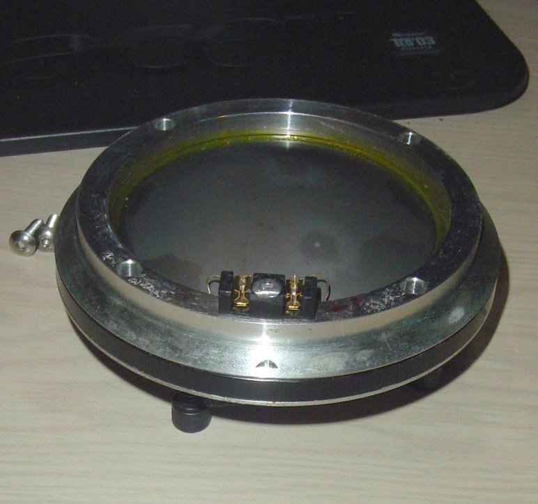

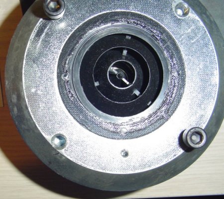

Here's a shot of the phase plug. This one was damaged you can see some chips on the edge of the plug. To get one open all you do is peel off the gray silicone pad and you can easily remove the screen
Rob🙂
