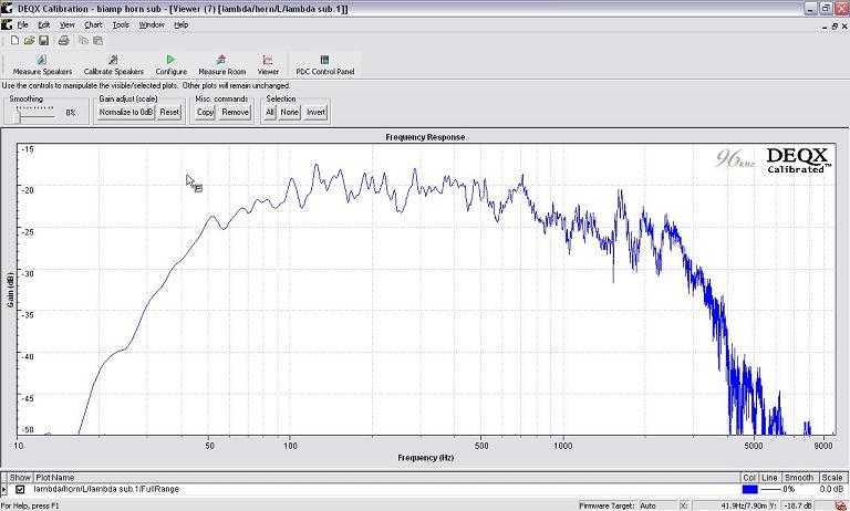

John,
Good to see that you are still going. These drivers are nice. Here's a raw unsmoothed nearfield measurement taken of my Apollo 15TDX. The measurement was taken at 15cm on a modified open baffle (sort of U-baffle, or a short open backed box). The lower end is crossed over at line level with a 80Hz second order transient perfect crossover. I don't have my system handy for full range measurements, or I would provide that.
Sheldon
