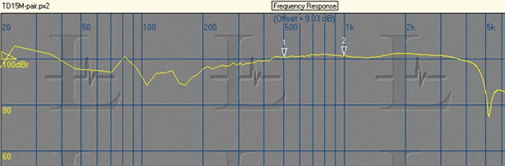

TD15M - 8ohm
Fs: 34.7Hz
Qms: 5.09
Vas: 312L
Cms: .3mm/N
Mms: 70g
Rms: 3kg/s
Xmax: 6mm
Sd: 855
Qes: .35
Re: 6.6
Le: .2mH
Z: 8ohm
Bl: 17Tm
Pe: 500W
Qts: .33
1W SPL: 97.8dB
So far so good. A few questions:
What is the normalized efficiency of the TD15M?
Is the cone profile similar to the Altec 416 or 515?
Which magnets are available - ceramic, Alnico, or Neodymium?
Is the voice coil underhung or overhung?
Price?
The provided curves for the TD15M/BMS MTM system show 8~12 dB peak-to-dip ripples in the 700 Hz to 2 kHz region, although very smooth above that - are these real or some kind of measurement artifact?

I believe the region you're looking at is the 70-200hz region, not 700-2KHz. My room is quite small so I have to time gate and measure only above about 500Hz to get very accurate. When measuring those I was mainly concerned with the response up higher. That curve is for just the TD15M's without the BMS coax. The sharp dip you see at 5KHz is an issue caused by the 2 15" drivers at 25" center to center distance. I'll try to take some measurements outside of a single TD15M if the wind dies down soon.
John
I believe that Lynn has positions available for drivers of various responses, ie both of the above..
This was in response to Lynn's quote " show 8~12 dB peak-to-dip ripples in the 700 Hz to 2 kHz region" These bumps are in the 70-200hz area, not 700-2K as mentioned.
