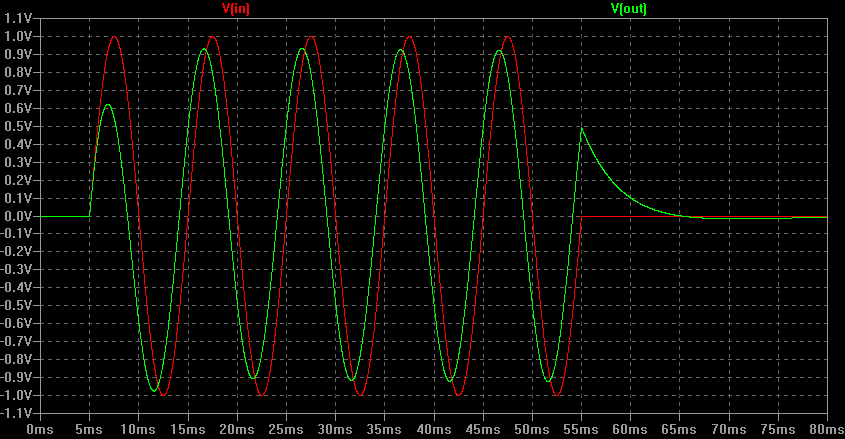

Yes, this "wrong" lead-in part of the waveform is a consequence of the highpass function (and, with a real driver, also of it's lowpass behaviour) applied to a non-sinusodial input (the sudden start of sine is not sine anymore, spectrally). The higher the Q of the 2nd order highpass, the longer it takes for the wave to settle. Unfortunately any highpass shows a step response overshoot, the magic Q value only applies for the lowpass function and there it isn't 0.71 (this only yields maximum flat amplitude frequency response, it's 0.50 (aperiodic response). Therefore, at the sudden start of sine running through a highpass we have two events, an intitial ringing/overshoot and a more or less slow build-up of amplitude. The overshoot/ringing only is visible when we are below the corner frequency, otherwise is masked by the amplitude. To test effects that are really a function of driver nonlinearities etc, one might better use sine bursts with raised cosine envelope which have a known and benign spectrum.mige0 said:But frankly - I havent explored that any deeper –maybe someone else can comment on that more profund.
Taking some old datasheets I would expect that the "first half cycle behaviour" shouldn't be considered as a constant. My half educated guess would be that it's related to the Qts of the speaker. Qts past 0.7 should result in overshots if I am right.
Linkwitz has some graphs showing these relationships:
http://linkwitzlab.com/filters.htm#9
And textbook highpass filter simulations confirm this perfectly.
- Klaus

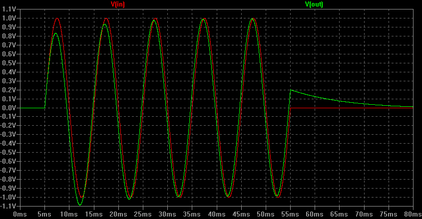

Maybe I misread you, but do you say the composite response, driver+correction, doesn't follow the product of the individual transfer functions? Assuming linear time-invariant systems (which is to be taken with a grain of salt wrt drivers) this initial "error" is only a matter of the combined transfer function.Graham Maynard said:Thanks for your Linkwitzlab link.
The last set of drawings in section 9 show EQ controlling Fp=55Hz with Qp=1.2, however the first cycle dynamics are cannot be improved due to the higher driver Qp figure.
I've attached a 28Hz Critical/Aperiodic (Q=0.50) 2nd order highpass time response, with 100Hz test frequency, which gives the same frequency ratio as in the Linkwitz example. All in all a 1:1 copy of the Linkwitz graph, isn't it? The perfect theoretical response for HP2 with Q=0.5 and a 3.5:1 freq ratio. If you have that conditions with a real system, this will be the response, regardless of system type (OB/CB/BR/...), provided that the system is well executed.
- Klaus
Addendum, even one decade away from the filter frequency the ideal HP response still isn't a "copy" of the input waveform. We have to say goodbye to that, unless we go way up in frequency. This "error" is, BTW, a common source of confusion in distortion measurements, be in in reality or under simulation, you have to wait until things have settled.
- Klaus
- Klaus

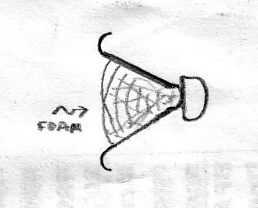

Ii this the right concept if I understood at all?
Not sure that I understand your drawing. If this an OS waveguide or a conical horn?
