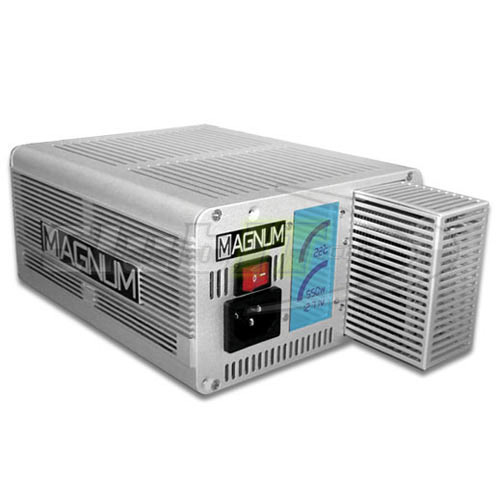

For field coils, a PC power supply that supports advanced graphics cards would be a low cost option. Fanless PC supplies go up to about 15A @ 12V. A PC supply with fan goes up to 1000W with 35A @12V.
http://www.clubit.com/product_detail.cfm?itemno=CA6224501
$39 PC power supply...heatpipe + heatsink cooling... no fans
two 12V power regulators... up to 15A each
1A to 15A @ 12V DC - Output Current
GENERAL INFORMATION
Manufacturer MGE Company
Manufacturer Part Number PSMG-500
Product Name Magnum 500 500W ATX Ver 2.0 AC Power Supply
Product Type ATX 12V
POWER DESCRIPTION
Input Voltage 100V AC to 230V AC
Output Voltage 3.3V DC ±5%
5V DC ±5%
12V DC ±5%
12V DC ±5%
-12V DC ±10%
5V DC ±5% Standby
Current 80A @ 115 V AC to 230 V AC - Surge - Input Current
10A @ 115V AC - Input Current
5A @ 230V AC - Input Current
0.5A to 25A @ 3.3V DC - Output Current
1A to 30A @ 5V DC - Output Current
0A to 0.5A @ -12V DC - Output Current
0A to 2A @ 5V DC - StandbyOutput Current
Output Power 500 W
GENERAL INFORMATION
POWER DESCRIPTION
5V DC ±5%
12V DC ±5%
12V DC ±5%
-12V DC ±10%
5V DC ±5% Standby
Output Power 500 W
