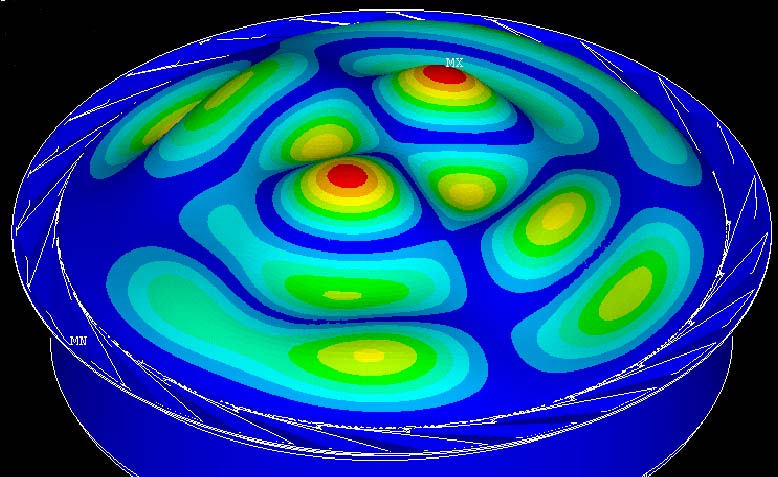

Dr. Geddes, I was wondering about one of the things you mentioned over in the Waveguide thread. Perhaps I misread it, but it appeared that a major source of HOM's was simply the fact the throat size was nonzero - in other words, the smaller the throat, the less the HOM's. Is this a correct reading?
In traditional horn theory, second-order nonlinear distortion is assumed to primarily originate from the throat geometry, but as described in the 2002 Voishvillo paper, the major source of second-order air nonlinearity is actually between the diaphragm and the rear surface of the phase plug, and other small-dimension parts of the phase plug.
If throat size is an open variable, and you had a free hand designing the phase plug, would smaller throats have better performance in an OS waveguide - say, half or quarter-inch? Or would that be flirting with second-order distortion from air nonlinearities?

I read the whole paper and he didn't quite get the history right. He must have gotten my book about 1/2 way through the thesis because there is no mention of it in chapters 1-3 and in fact much of what he talks about there is described in my book, but he doesn't reference it. Then by the later chapters he is taking things directly from the book. I found this confusing until I realized that the book would have come out right in the middle of his project, so I guess its natural that he picks it up in the middle.
The one thing that he does not point out is that his optimization is for a waveguide in a sphere. He might find different results for different enclosure geometries. This is the problem with his approach - it is very specific for a very specific situation.
The part of his experimental data that got my attention was how often the mouth velocities were non-axi-symmetric. I have wondered about this and expected it would be the case and his data clearly shows that it is - or can be.
Morgan is also the only other person that I have read that recognizes that HOMs can have an evanescent aspect to them. He got a lot of things right, although his major contribution was in technique rather than specific designs. His "best" designs all looked like OS waveguides with some slight modifications at the mouth. This certainly wasn't new to me. He also seemed pretty clear on the goal - constant directivity with frequency. I'm afraid that the horns that you have choosen don't have this feature. Constant directivity does not apear to be a major requirement for all designers.
I'm not sure that one can say that there is a major source of HOMs because there are many sources and the contributions will differ with the specific situation. The smaller the throat the higher the cut-in frequency for the HOMs, so in a sense, yes the smaller the throat the fewer HOMs there will be IN GENERAL, but not necessarily always.

Do you have any data to back this up? I remembered a FEA run I did about three years ago on a tangential surround diaphragm assembly. I went back and looked at it again. It was modeled in 3D to get the tangential compliance, so I didn't do an acoustic simulation, but I did look at the mechanical modes. I looked at the first 100 modes and did not find one where the surround was significantly resonating in any way. This covered almost 1 decade of response. Note that this geometry is not the 288 geometry. It also may be that all the modes I looked at do not contribute significantly to the output of the driver - I was looking at shape, not magnitude. It may also be that the surround resonance is the only secondary resonance that really does contribute to the output of the driver, but personally I'm not convinced of this for the tangential surround shape. Now if you have a direct radiator with a surround that's much softer than the diaphragm, sure, the surround will have some issues. Or if you have a compression driver that uses a surround that's made of a softer material than the dome. Anyway, I'd be very interested if you have some information on this.
For example, mode 53 (about 5 times resonance). Color scale is displacement - blue is zero, red is max.
Lynn Olson said:
to the tangential surround of the aluminum compression driver diaphragm. JBL applies Aquaplas/Antivibe to the whole diaphragm when you buy a 435Be, but I feel this is a mistake. The part of the diaphragm with the most chaotic radiation is obviously the surround, and it's an area where mass-damping and outright suppression of radiation is desirable. That is NOT true of the diaphragm dome, where low-as-possible mass and uniform emission into the phase plug assembly are primary goals. Raising the mass of the diaphragm is extremely undesirable, since it depresses efficiency and decreases HF extension.
The reference is Murray and Durbin of JBL, published in 1979. Since the results appear to depend on small manufacturing tolerance errors, it's a good question how repeatable they would be. The claim that the JBL diamond suspension is more immune to these variations is not backed up by the data shown in this paper - only one example of the new suspension is shown.
The reasons for JBL to convert over to the diamond suspension (as opposed to tangential) are not very clear. This was the same time that diaphragms were failing in stadium rock applications, and in movie theaters that were using the new Acousta-Voicing equalization system. JBL switched to diamond suspension and titanium, while Altec switched to a different aluminum alloy (Pascalite) and retained the tangential suspension that went back to the WECO days.
Emilar (now Radian) retained the traditional aluminum diaphragm and used a plastic (Mylar) surround. My limited understanding of the situation with soft surrounds is that they can be prone to rocking modes (this is certainly true in direct-radiator midrange domes) and may have unexpected dips and peaks at the bottom of the working range.
