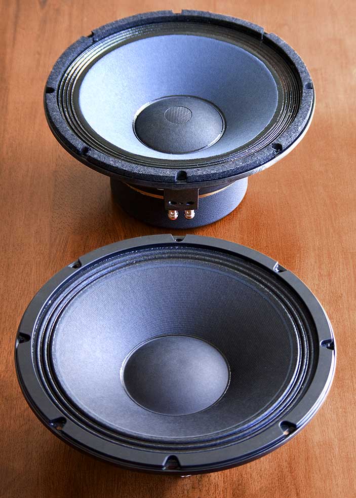

GPA and 18Sound Drivers - Rear View
The 18Sound 12NDA520 Neodymium-magnet 12" driver is in the foreground, and the GPA 414 Alnico-magnet 12" driver is in the background.

Re: GPA and 18Sound Drivers - Front View
Lynn Olson said:
The 12NDA520 is in the foreground, and the 414 is in the background.
Lynn,
Do you plan to first listen to those drivers full-range on a simple baffle (as you stated previously) ?
I think there are quite a few here (myself included) that would be greatful for detailed measurements and listening impressions of those 3 drivers -- those two + TD12M (or, better, the TD12M's OB variant ).
Florian
