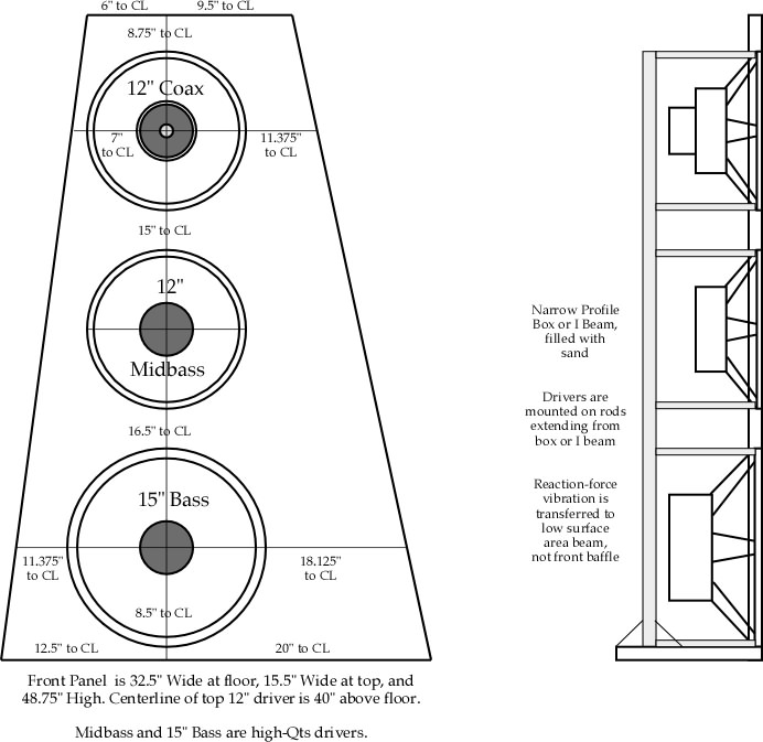

Plugging in Eminence's Beta12CX into Linkwitz's DipoleSPLmax spreadsheet, with a "D" of only 20cm (~7.5"), a single 12 doesn't become excursion limited at 120db until 225hz. However, 120db at only 80hz (too high IMO) would require 4 15's of similar excursion (3.5mm xmax) AND a large "D" of 60cm (a 12" deep U baffle). Now you understand why designers "cheat" by boxing the bass.
Personally, I think 80hz is way too high, because I believe OB bass is a huge benefit in room. It's directionality results in greatly reduced reflections that is perceptively different. Linkwitz calculates this advantage to be +4.8db, making me question whether flat OB bass is even desireable. Whenever I dial in what should be close to flat, it sounds very bass heavy on music with strong LF content, and I back off the shelving EQ.
Note that the numbers I toss out there don't consider placement, or floor reinforcement. The floor cuts it back to 2 15's for 120db at 80hz, plus placement can be used to significant advantage. There's a catch 22 regarding placement. Mids love the breathing room, making the rear wave just ambiance, however, closer placement can reinforce bass, not as boundary reinforcement, but as extra delay for the net rear wave as it travels to the wall and reflects back to combine with the front radiation at the listening position. This is one of the effects that I hope to quantify as part of my measurement regime.

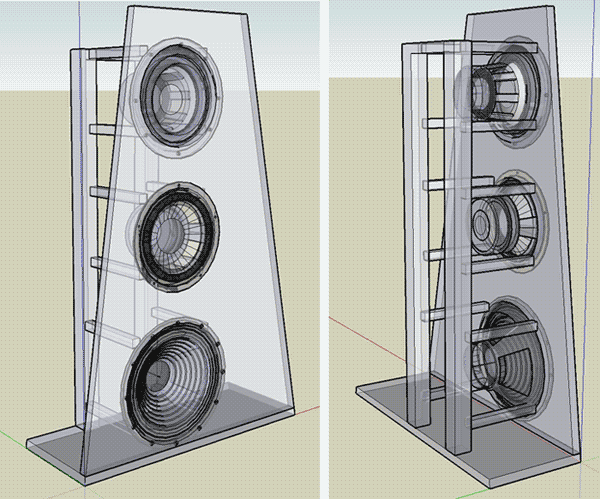

Simple might be best
I might use this as my starting point, and see how much EQ this requires. I've heard the bass Gary Pimm gets from his cardioid/dipole W-boxes - down to 20 Hz with stunning resolution and tonality. This three-speaker setup ought to be able to meet the W-boxes or monopole subwoofers.
It is also simple enough to make a good test bed for the EnABL and Mamboni baffle and speaker-cone edge-termination systems. I'm thinking 18Sound, Radian, or Hemp Acoustics for the 12" wideband coax, possibly something as zany as the 12" Alnico Tone Tubby for the midbass, and a 15" high-Qts bass driver that is yet to be determined. (The new 15" Tone Tubby - who knows? Time to get better and start building!)
Now thats less scary but looks "right" somehow. Beautiful even.
I'm hoping that the coax works out, and the Hemp stuff is the most exciting, but there is another disadvantage to the coax because the "midbass" 12 will have a different response,-even if it is based on the same driver.
If the 12" and "midbass" 12 are exactly the same, then they should integrate better I'd think. But there is the possibility of different models canceling out each other's anomolies also... So either way there are possible pluses. Best to use the same brand though I'd think. At least the cones could then be similar stuff.
Considering the frequencies involved and the area needed, would an 18" be a better choice than the 15? A PA 18 is usually cheaper than two 15" but I don't see them used much. I guess the floor reflection will help here though...forgot about that..
Variac said:Now thats less scary but looks "right" somehow.
I'm hoping that the coax works out, but there is another disadvantage to the coax because the "helper" 12" will have a different response,-even if it is based on the same driver.
If the mid 12" and "helper" 12 are exactly the same, then they should integrate better I'd think. So either way there are pluses.
Considering the frequencies involved and the area needed, would an 18" be a better choice than the 15? A PA 18 is usually cheaper than two 15" but I don't see them used much. Or is this 15" a high excursion sub type as Linkwitz uses?
I'm planning on the midbass and bass driver sharing a steeper 12 dB/octave crossover set to about 1 kHz to prevent mid colorations from sneaking in. The cascade of 6 dB/oct lowpasses for the midbass and bass will control the degree of overlap between the drivers, and allow response shaping without massive EQ from the power amps.
I suspect mildly dissimilar widerange and midbass drivers might be a good thing, actually - remember, all of these drivers are working in the piston band, with intrinsically flat response, so what we're hearing are IM distortion signatures and unusual things like "magnet sound".
As for the bass driver, either a 15 or 18 would work fine. This depends on sonics as far as I can tell. High Q is a must, of course, along with good efficiency to complement the 97 ~ 99 dB/metre drivers upstairs.

Re: Simple might be best
The ladder structure at the back doesn't feel right, there must be a more elegant way of achieving the same ends.
dave
Lynn Olson said:I might use this as my starting point,
dave

Here are some pics of other efforts... these thou, just brace the baffle, but could be adapted with the addition of a magnet clamp amd a tripod structure on the front/baffle end with driver mounting rings... (somewhere on this forum is a Thorsten L supravox baffle with a metal L for driver mounting and a floating plexi baffle)

planet10 said:The ladder structure at the back doesn't feel right, there must be a more elegant way of achieving the same ends.

Lynn, have you considered a 2-structure baffle to separate the dipole woofers?
Dipole woofers will generate baffle vibration that can audibly modulate the higher frequencies unless special attention is paid to the baffle design. Counter balanced W-baffles are one good solution for deep bass from multiple dipole woofers. My earlier post illustrated how sand cavities can be built into the edge round-overs to maintain forward facing dipole woofers. I favor forward facing dipole woofers, but always physically separate the bass structure from the mid-tweeter structure.

Dave, I like the spine approach, especially if you connect it to the magnets. Add a couple of sacks of steel shot to the base and you're in business.
I agree with linesource regarding firing the woofers on axis with physical separation of the woofer section. Also plan on mass even in the upper section if you want a vibration free baffle. It's surprising the forces at play even in the null of the woofer section, and I'm not even talking about high output like Lynn's goal. They only net to zero there, not actually cancel.

LineSource said:Lynn, have you considered a 2-structure baffle to separate the dipole woofers?
The catch here is that I'd like to run the wideband driver pretty much full range, without a 200~300 Hz highpass. If I was going to use a highpass filter - and make an honest midrange of it - the obvious candidate is the 18Sound 8NMB420. Note the response curve and power handling. For a classic 3-way speaker, this is an obvious design choice, and gives more freedom to select the tweeter since a higher tweeter crossover can be selected.
Since the 12NDA520 is the target driver, and I plan to let it "free run", it will be generating some cone-reaction vibration. Not as much as the drivers below it, of course, and that's a good argument for physically isolating the wideband driver from the midbass and bass drivers.
Planet10, thanks for the posts at #448 and #452. Good ideas there, and the 3D illustration is a slick visualization tool for the driver-support framework.
It's interesting - a conventional enclosure is like a monocoque, or exoskeleton, with the outer shell bearing the structural weight but also unfortunately acting like a large-area radiator for all internal vibrations, whether reaction products from the driver, or standing waves from internal box modes. The large area is much of the reason minimonitors have less cabinet coloration than even the most advanced construction big speakers - there's just less area to radiate, thus less coloration.
By contrast, the driver-support structures we're seeing here are external, but are specifically designed to have low radiating area combined with stiffness and rigidity. The trick is to have the large-area baffle not flop around and resonate from the back pressures, which although low, are certainly present in close proximity to the drivers.
