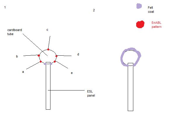

EnABL and ESL?
Sorry for me interrupting the thread, but it seems to be the only place where surface treatment is seriously considered and known.
In the attachment, a pic with two variants of applying treating to an ESL is provided. On the left, it's cardboard tube along the edge of panel, with felt near the panel and several EnABL patterns along it's circumference. I'd also like to know if really several patterns are needed.
On the right, the whole tube is just coated with felt.
The question is, which is more beneficial?
Also, would adding felt between stator and diaphragm along the edge of panel help as well?
Edit: forgot the attachment..
