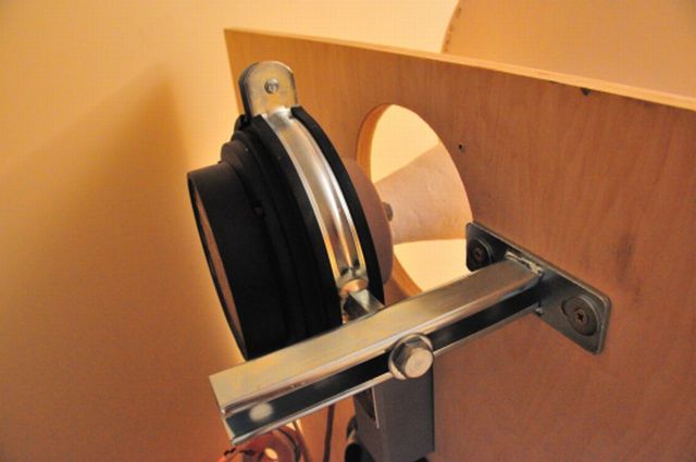

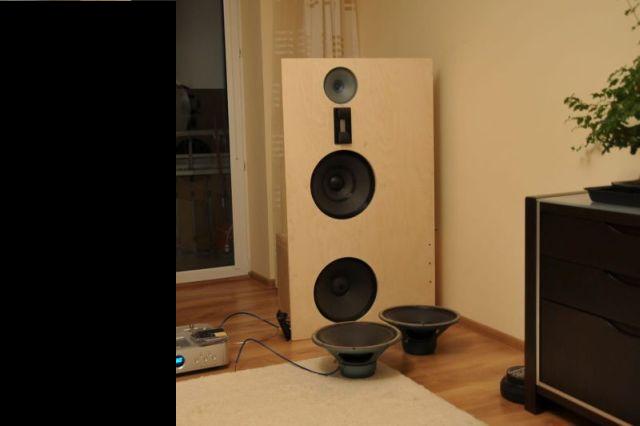

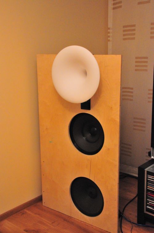

Lynn Olson said:
The Altecs are low-Q, of course, and not an effective choice for the low end of a dipole speaker. You might try a pair or quartet of the Dipole15 (LO), use them as bass augmenters (low-pass filtered just below the baffle peak)
I am newbie-the crosover is a nightmare for me!!! I cant do this by myself... this is my first contact with horns...
As You said- 416 on baffle as a bass is not good idea. I trayed box without back, wings etc. all this is not acceptable for me- boom, boom, bomm
So I would rather try Lo15, Its a pity US$ incrase so much :)
