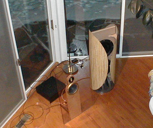

LineSource said:Quadrilateral hierarchy
Right Angle trapezim with vertical on inside of soundstage looks best to my saw.
Also sims nice for diffraction and performs excellently. That's what I did for my last open baffles (best speakers I've built).

I think Karlson was doing several things with his enclosures. Internally coupled sections to tune and control the driver both mechanically and electrically, the characteristics of which must have also interacted with the front inconstantly diffusing slot shape.
The ?woofer? shown by linesource might look 'esoteric', especially as the drivers are more equally loaded at both front and rear so unilateral pressure differentials arising during music time will be minimised, also there cannot be any narrow band tuning peak, but does this complex structure have any advantage over say a shallow and non square 'H' sitting directly on the floor ?
Cheers ......... Graham.
