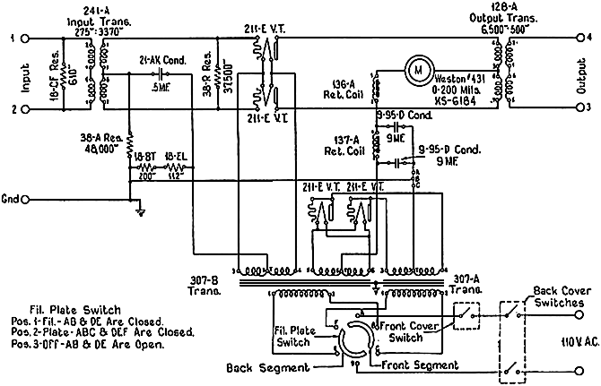

Feed-forward midbass driver? What's that? It's an exotic amplifier design technique (that is fairly sensitive to reactive loads), but I've never heard of it described in the context of a loudspeaker before.
The WE quote is a bit odd as well. WE never made an all-trans-coupled SE amplifier for theater use; the single-ended 91A is cap-coupled (with a pentode front end), and the 86B and 92A amplifiers have PP output stages. The late-twenties 43A is PP as well, as you can see from the schematic. Note the use of a pair of 211's as HV rectifiers - this amp slightly precedes the invention of dedicated rectifier tubes. The filament pre-warmer switch (and separate filament and plate transformers) is a nice transmitter-style refinement that extends reliability.

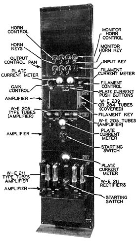

Western Electric rack-mount as used in the late Twenties for the first-generation sound-on-disc movies. (The 86B, 92A, and 91A were introduced in the Thirties and were contemporary with 35mm optical-sound movies and the introduction of the MGM Shearer Sound theatre speaker.) A single 86B, 92A, or 91A amplifier would replace everything in this entire rack, since they incorporated photo-detector pre-amplifiers.
![theatre_amp.jpg](/community/proxy.php?image=http%3A%2F%2Fwww.nutshellhifi.com%2Flibrary%2Ftheatre_amp.jpg&hash=6f4d7ac2ca7627f1601d3a89550bc0ec)
