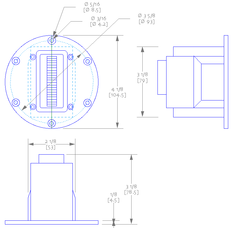

Several pages back, we had an interesting proposal for a custom driver with a 4" VC assembly and a coaxially mounted ribbon where a pole-piece would normally sit. The ribbon could sit fairly deep in the woofer, almost touching the interior of the cone, or it could extend further out on a cylindrical pole-piece. The extended version would be compatible with your suggestion for local felt damping near the center of the cone, where it could do the most good.
I think that there probably isn't room for the ribbon too deep, as the ribbon tweeters are pretty deep themselves. I was however suggesting this as a DIY experiment. It would require one to remove the dust cap in the center of the driver. Anyone who has used one of the kits to replace a driver's rotted suspension can tell you that this is pretty simple. Then glue a piece of pipe, PVC aluminum, cardboard, or whatever comes in an exterior 4" diameter onto the solid steel polepiece which is just inside where the dustcap was. Add some damping inside and then glue the tweeter into the end of the tube. A clever way should be found to try different lengths of tube, but I suspect that getting the tweeter as close in as possible is probably best. The tube could be then wrapped in felt. A 3" tube and tweeter in a 4" voicecoil would probably give a lot more room for experimentation, but even if you remove the tweeter flange I can't remember if it will be small enough- will check This scheme seems a bit more doable now that we are aware of 12" drivers that can go up to 4k or more...
I checked: Darn! 92dB / 2.83V / 1M not efficient enough! Well.... the Phy drivers use piezo tweeters....
OK the Aurum Cantus 2si ribbon has a diameter of 4-5/16" (110mm) but the flange could be removed and easily machined to less than 4" without damage as you can see from the link below.It's 96 db
http://www.e-speakers.com/catalog/aurum_cantus_g2si_4284956.htm
Hmm I wonder if the pressure would damage it? I have a 2si 4.5" laterally away from a 15" woofer and no problems so far...
Variac said:the ribbon tweeters are pretty deep themselves
Isn't that mostly transformer?
I have a set of AC here with custom 104.5 mm bezels... it could be smaller yet, 93 mm by my drawing.

Dave, 93mm doesn't surprise me. It could be done. You are Mr. Phaseplug
so I'd think you'd be tempted. A nice turned wood nose tht tapers from 100mm to 93mm,that fits into a 4"tube which attaches to the polepiece. The tube could just have a piece of steel inserted on the inside end which I would presume would snap right onto the magnatized polepiece. Carefully!!! like the guys that use a socket wrench socket as a phaseplug.
At the moment I cross to the 2si at about 4500 hz and I like it!
At 96db it probably is about the right efficiency to work with 97 Db drivers. People say that padding down a ribbon hurts the sound. I don't have to pad mine down because it matches the mid efficiency so well. That is really elegant IMHO.
I think most of the rear of the ribbon is magnet. It's just that additional bump which I think is the transformer, but I'm just guessing.
