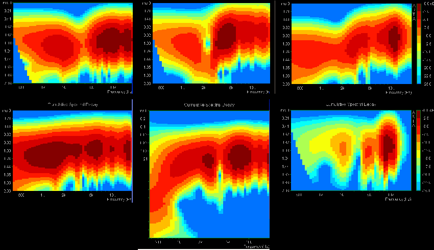

Hello everyone,
I don't know why people are so upset using the waterfall presentation of the CSD.
The waterfall due to its perspective mask many important features of the spectral/time content of the impulse response.
The first important masked feature being the pulse attack itself.
You'll see here attached the spectrogram (ARTA call it "sonogram") presentation of the CSD which is IMHO more meaningfull that the waterfall.
The 6 sonograms were obtained using ARTA from my own measurements on 6 competiting loudspeakers during a contest organized by the french forum Haute-Fidelite.net

gedlee said:Are you guys are talking about single driver systems? Otherwise, you would have to explain to me how any of this "speed" and "impact" discussion has anything to do with a driver which is used in a system with a crossover. It's completely irrelavent.
"speed" and "impact" ("punch" and "slam") are subjective descriptive terms - perhaps what you would refer to in loudspeaker design as "black magic". What it is NOT (as suggested by others), is simply the result of inductance reducing the high freq. bandwidth for a driver (or even increasing non-linear distortion at higher freq.s for a driver). Still, it's always argued, and yes - the argument doesn't make any sense (..except perhaps for "full-range" drivers).
People are still trying to understand exactly what is responsible for these descriptions, but as John K has noted - we really haven't progressed very far here:
john k... said:These concepts of speed and impact are rather esoteric. If you try to relate speed and impact (subjective terms) to a system's impulse response what do you look at? Do systems with the same speed/impact have the same impulse? On axis? If not, and there is any correlation between speed/impact and differences in impulse response then it comes down to difference in amplitude and/or phase response, or perhaps directionality, or nonlinearities?
John_E_Janowitz said:
Note that their paper is written with intent to show what they want it to. It is much more a marketing paper than a paper to evaluate the technology. Take the evaluation of flux modulation. They have figures 5 through 27 all showing flux modulation of a standard motor vs AIC. Yes, AIC does lower flux modulation, but not nearly as much as a solid fixed sleeve on the pole. They don't however show this comparison.
In terms of decreasing distortion the primary benefit is to reduce 2nd harmonic at higher frequencies. Compare Figure 30 (500 type with no shorting ring) to figure Figure 31(500 type with AIC). From 300hz on up, the AIC actually slightly INCREASES the 3rd harmonic (grey line). From 400hz on down AIC does virtually nothing for 2nd or 3rd harmonic. The benefit is a decrease to 2nd harmonic from about 500hz on up.
Now look at Figure 32 with shorting ring under the pole vs Figure 31 with AIC. Look at below 300hz first. The shorting ring has anywhere from a 5-10dB decrease in 2nd harmonic and everywhere below 800hz the shorting ring has lower 3rd harmonic than the AIC. We see similar with figure 33. This is with a shorting ring intentionally not positioned to be fully effective. Had the shorting ring been a full sleeve on the entire pole so it is adjacent to all of the coil at all points of excursion you would see drastically decreased distortion. But their paper wont' show you that either.
John
