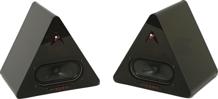

Auratones AKA horrortones. They had them in the first studio I worked in. Their best use was somewhere to put my coffee mug.pjpoes said:It was basically a pair of cubes with very inexpensive full range speakers like you might find in a clock radio.
yes sir, that looks like the ones I saw. I just checked my Full Compass catalog and noticed these:
Anyone explain to me why Studio's wouldn't simply buy a cheap pair of computer speakers for this purpose? Are these some how more reliable? I mean, 235 dollars per pair is a little disturbing when you consider what they are and what they are for. Here is another over priced example:
I understand why these exist, I understand what they are for, I even understand why normal cheap speakers wouldn't necessarily give you the same result. What I don't understand is why these can't be produced for 10 dollars, or why the thousands if not millions of computer speakers, using almost identical designs, can't serve the same purpose.

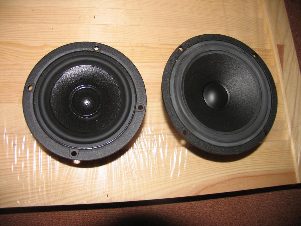

Well it can be truth
Bellow the picutre , showing the difference between rubber suspension of the Vifa PL11WG ( production date- Nov 2003)
and Vifa P13WH ( production date Nov 2004 - bigger one)
I bought both drivers (brand new) by the end of 2005
and the rubber suspenison in both of them was black
After 2 years of storage in the same einvironment
( low humidity , temp range 15-25 C ) the suspension of the P13WH became gray.
I asked about it some technology engineers form rubber industry , and they told me it's not a talc, but rather the mistake in the production process of the rubber compound for the driver suspension ; they also stated , such thing changed the dynamic proprieties of the rubber for sure
Charming. Nothing like management changes to slip in tiny cost-savings that look superficially the same and yet result in big changes to the user.
That's why it's a big deal when the original designer leaves - they're usually responsible, at least indirectly, for making sure production drivers don't drift away from the original spec. When the original guy leaves, there's frequently an interval when there's no designer at all on the staff (these are small companies), and the production people are running things. Naturally, they come up with all kinds of clever ideas to reduce labor content and save on material costs. Management loves all kinds of cost savings, that's always welcome, and a great way for the clever assembly and repair staff to get promoted out of boring assembly line work.
By the time a new chief designer is hired, the drivers may have changed quite a lot from the originals, and by then, there's no good way to exactly reproduce the originals, since the assembly sequence and complete list of parts (including glues) may not have been preserved. Sometimes staff changes on the production line results in loss of specialized manufacturing technique.
Much of manufacturing is never written down - it's in the heads of the staff doing it, a complex network of relationships with suppliers, and it's up to the design staff to stay on top of these things. It's not in the job description, but product continuity is an unspoken requirement for an old-line company. If a key component of the product becomes unavailable, it's the responsibility of the engineer to work on it until performance is maintained, or if unavoidable, discontinue the product and replace it with new (which may not in fact be better, just different).
I met NASA engineers during the Seventies (I worked there during the summer of 1969) and they told me when the German Von Braun/Huntsville team that built and designed the Saturn V was disbanded, there was no way to re-build the moon rocket - much of the know-how was in the minds of the team, and when the team was dispersed all across the country, it was lost for good. The old Germans had worked on everything from the V-2 to the Saturn V, and when they retired, that was it. The ones following in their footsteps had to pretty much re-learn everything.
