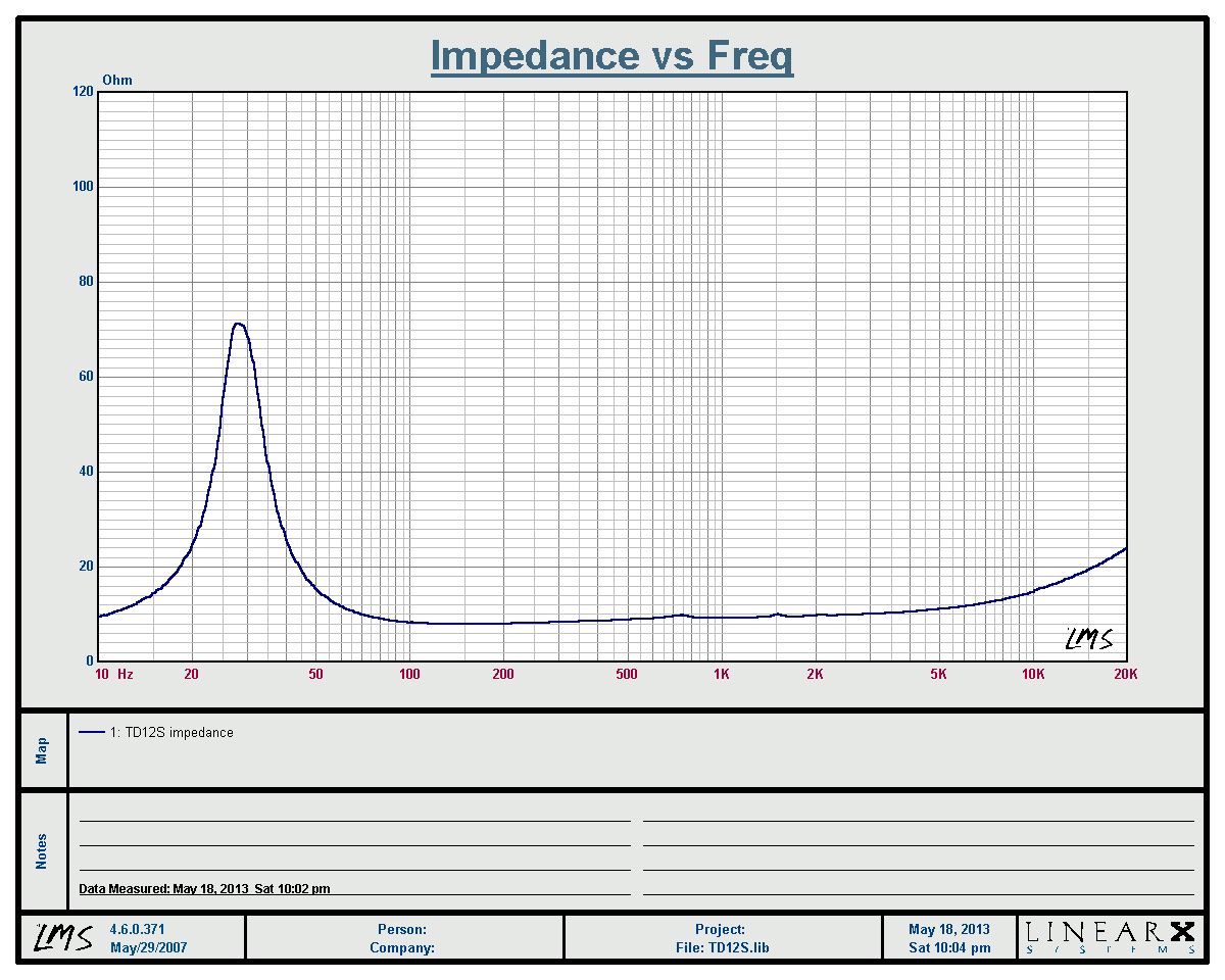

To clarify, I had a customer come to me with AE drivers they had purchased directly from AE. They were measured in a variety of ways - some in a cabinet, some close-mic'ed, some with crossover connected - but they were also measured farfield without a crossover, as per my instructions. They measured as shown in the links posted above, with deep notches around 750Hz and 950Hz, and jagged response above that.
I later measured a few other TD12S drivers and found this response from them too. To be specific, I measured four drivers that acted this way. I did not see this behavior in AE drivers I measured a few years back, and I have some other customers that had TD12S drivers that measured nicely too.
I see now that John has suggested the drivers might have been defective. I would agree that is a possibility. The first person that noticed this behavior complained that the voice coil did not appear to be centered. Since he told me this, I would only assume he told John this too. Could have been a manufacturing defect, possibly one that could have been corrected by warranty service.
Whatever the reason for the defects, I think the first step is validation. When you get your drivers, measure them. What happens beyond that is between you and AE.

I can say with certainty that this is the case. The majority of TD12S woofers made before January 2013 were placed in three Pi loudspeakers, and most were very good. It was only around 12 months ago that this problem presented itself.
I saw the problem myself, so I know that it wasn't a botched measurement. And I saw it in four drivers, so it wasn't an isolated problem, there were multiples that went out that way. But not every driver is that way - I've measured other TD12S drivers that were very good.
I guess I'd probably characterize this as a QC consistency problem. That's understandable too - It's hard to keep a handle on QC when you're a busy job shop. So I would suggest to anyone that buys AE drivers, just measure them and hopefully John will make good on any that don't match your expectations.

I told you then and I'll tell you again, some of your drivers were defective, or at least they measured exactly as I showed you in the link above. It could be that's the way they all are now, I don't know. I know they weren't like that a few years back, last time I checked. Not sure if they're all like that now, or if you just had a few bad apples go out the door. But I know I've seen four that measured just like the charts in the link above.

I would also like to point out the zoomed resolution of the impedance curve you posted. No matter what impedance curve you look at there will be small blips. Other drivers used in the 3Pi speaker have much more significant bumps in the impedance curve than the ones you measured. For comparison I would like to show the normal scale impedance curve you measured and sent to me.

![TD12S_impedance.jpg](https://www.aespeakers.com/pics/measurements/TD12S_impedance.jpg)

I hadn't noticed the degree to which that impedance graph was zoomed in.
That is significant; the blips do look trivial at a more normal scale.
