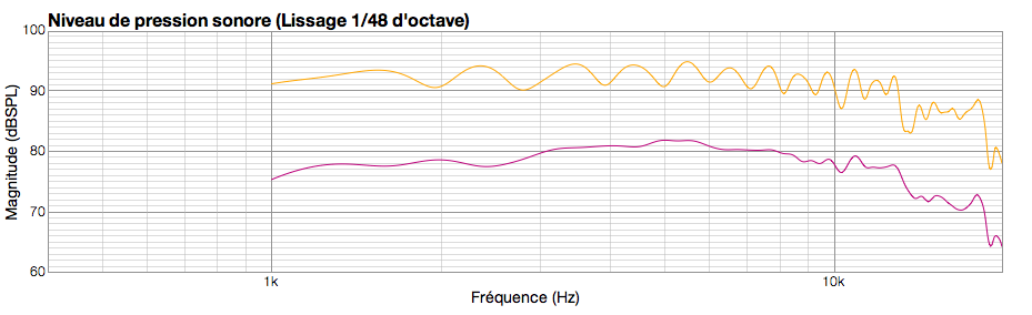

. Here are measurements of the Radian 745 Be on the AH425 horn. The top curve is at horn mouth. The bottom one about 1 m away from horn mouth. The driver is low pass filtered (3d order) and padded about 15 dBs via an autotransformer. Gate duration about 2 ms.
Tis time to revive this thread. Here are measurements of the Radian 745 Be on the AH425 horn. The top curve is at horn mouth. The bottom one about 1 m away from horn mouth. The driver is low pass filtered (3d order) and padded about 15 dBs via an autotransformer. Gate duration about 2 ms.
