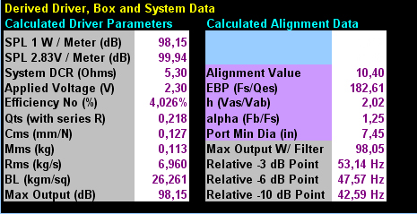

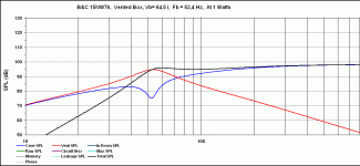

On a more cheerful note, what do the good people of the forum think of the B&C 15NW76 bass driver? It looks as if it was intended for 2-way studio monitor use, with well-behaved response through the rolloff region, 98~100 dB/meter efficiency, and the deluxe feature of a double spider to improve centering under dynamic conditions.

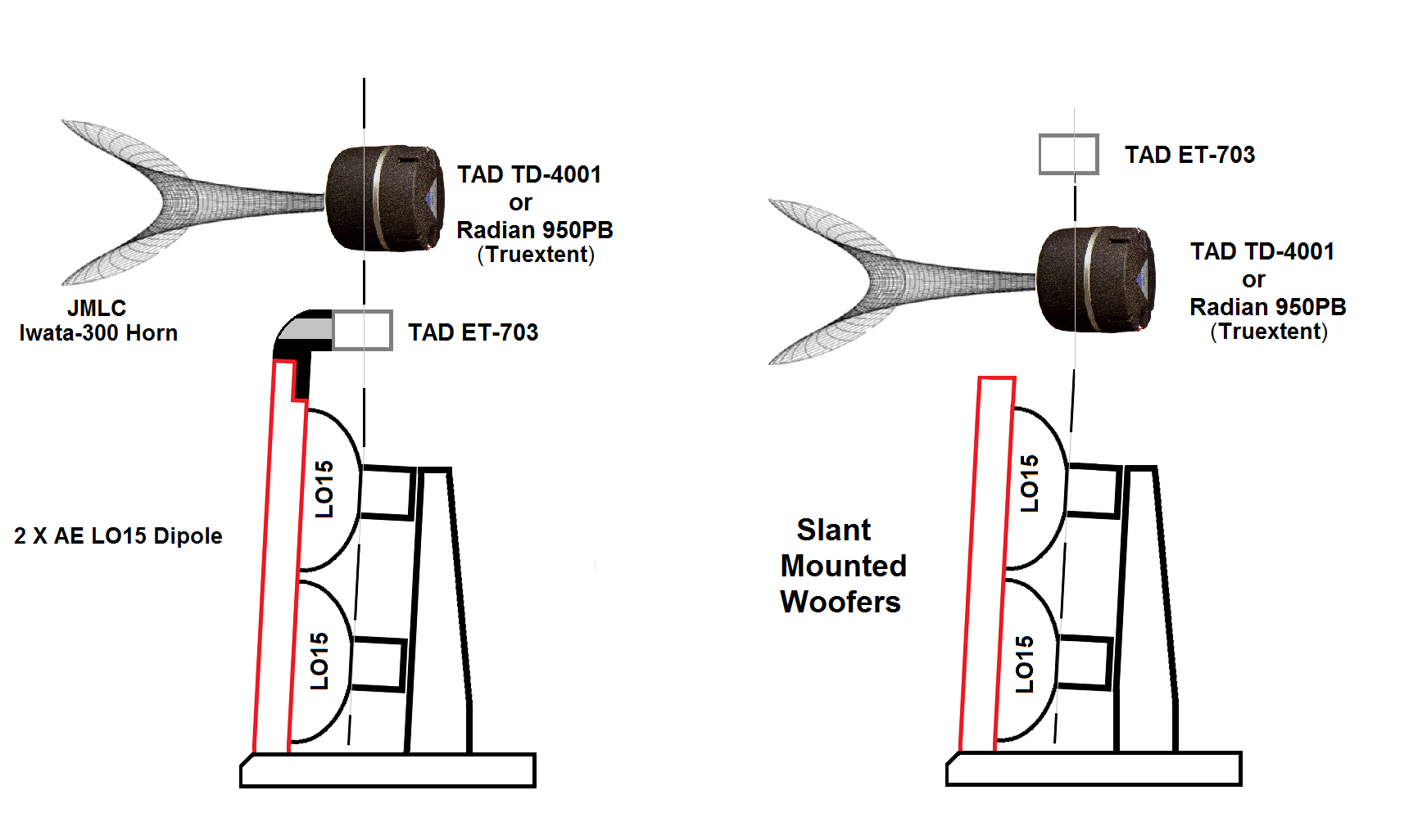

The TAD tweeters, Radian CD w/Be diaphragm, Iwata-300 horn you can see in the North Reading Engineering webpage are all mines. I ordered them such project which also includes an OB mid woofer section. All the components were stricktly selected by me, right or wrong.
This surely doesn't care anyone but let me tell you that the sole inspiration for this project was the "Beyond the Ariel" thread and the works made by JMLC.

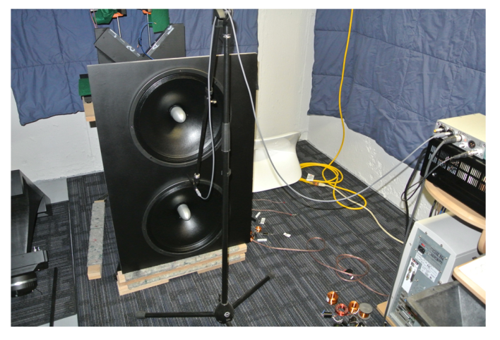

The OB section covers 60-600Hz and I opted for double AE-LO15 the lower unit covering 60-150Hz (probably 60-300Hz) and the top one 60-600Hz.
We are now using the XM-44 active XO from Marchand for the subwoofer section (still not defined), the OB-mid woofer section and the HP for the Iwata and TAD tweeters. The XO section for the Iwata/Radian and the TAD is passive.
The job the AE-LO15 made in the OB section is terrific and they required only a 6dB/Oct EQ from 300 to 60Hz. This is what John Warren from NRE told me.

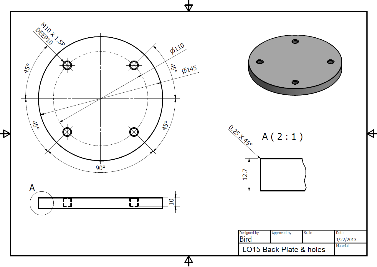

I ordered the 4 LO15 units with the back plates prepared to mount the drivers from the magnet.
The tweeter TAD is crossed to the iwata at about 8-9Khz, again in the words of NRE the disperssion of the Iwata-300 is impressive.
I attach a pic and some sketches to show what I have in mind. I intend the horn and TW section be decoupled from the OB structure, to make this in the correct way all the parts must be CNC from solid metal.

I really like your system. My second choice in midbass is the open baffle and it does have advantage over horn loaded in my experience. If my room were any smaller then it is now I'd be listening to bass on a board
I am intrigued by the IWATA horn, someday I hope to hear a pair.
Very nice!
I don't like it
It looks like the n-th iteration of the "modern" PA-spec'd woofer that is meant to take a lot of abuse without biting the dust.
Two numbers say it all to me:
Fs/Qts = 198. OK, so this is a mid-bass, not a woofer. No hope of getting it to produce much bass at all below 80 Hz or so...
Rms = 6.5 (back-calculated from Qms). Very high mechanical resistance / stiction. It will surely sound "dead" and lacking in micro-dynamics, especially when played at home levels (it might sound OK at ear-splitting PA levels...)
I bet it'll sound somewhat similar to the JBL 2226H (Fs/Qt = 130, Rms = 5), which IIRC you tried and did not like compared to the GPA 416-8B... only probably even worse!
So VERY different from those woofers that I know from experience actually do sound very good, e.g.:
TAD TL-1601a: Fs/Qt = 82, Rms = 3.0
Fostex FW-405N: Fs/Qt = 60, Rms = 2.5
Marco
High mechanical resistance is probably a consequence of using a double spider. Not necessarily a problem in a sub, but I'm not sure I'd want one up higher. I think that the lightness and flexibility of the spider in the Altec/GPA woofer contributes greatly to its subjective responsiveness.
