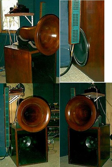

bass enclosure post# 11848 ?
Hi there P: Can you post the details of the bass enclosure shown in the lower section of the picture from Post #11848 (presumably for the Celestion Bx15-4085 king daddy driver mentioned above). ...regards, Michael
Agree 100 percent. 15" midbass horns require less depth and normally go lower with more bass power then smaller driver horns.The EV15L or B are great if you want wide band but I find the Celestion BX15-4085 the to be the king daddy bass horn driver in my system![]()

That was a system that had RTR electrostatic panels with 3.5K HV supply using HF winding of acoustat medellion trannys for upper teble, TAD 4001 600- 8k ? midrange in 180 Hz flare tractrix horns, TAD 1201 carbon midbass driver in 100 Hz flare tractrix horn, the side firing 15 lelped get it down to around 100 HZ, behind these in the corners were four 15" JBL 2235 a channel (eight total, couldn't keep up with the bass horn and midrange) in infinite baffles for low bass. Around year 2000 I think. It was scary at times to listen to.
