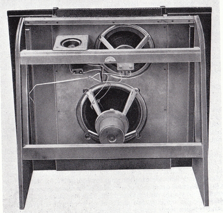

... I am looking for methods to offset the narrowing DI with frequency. A supertweeter with wide dispersion is an obvious choice, but it has to be time-aligned for satisfactory integration with the MF driver. A more offbeat method is taking a cue from AudioKinesis and use up-firing driver(s) to floodlight the ceiling with spectrally shaped HF content. It seemed to work for Duke at the Rocky Mountain show; there was no impairment of image quality that I could hear (at least in a show setting), and the spatial impression opened up quite substantially, so the system sounded more like an electrostat.
Quote from Lynn (highlite my edit)
Thank you for this. This is the true culmination point of this thread. A highly respected authority opens up and confesses that a flooder actually improves the sound.
This ceiling firing tweeter method is very old. Earliest I have came accross is from G.A.Briggs, the SFB/3.
Surely this should be well known, but extremely rarely executed in modern designs.
I only wonder why... Because it works very well in normal domestic rooms.
This is something I'm on board with- and I'd add that secondary sources come in many flavors. I remember one eye-opening experience, when I was working with 2 channel system, with a display in between. After a casual power up and starting up a laserdisc, the system sounded really great one day, I realized that the tv speakers were left on, albeit at about 15 dB down from the mains. Filling in comb filter notches? Spreading modal behavior in the room, just a bit?
Since then, I've been a fan of ambience tweeters, flooders, bipoles, dipoles, and what have you- in systems like the BTA, where treble is so beamy, you can use it to get the balance of reflected energy closer to where the direct energy is, and simplify the balanced EQ process. Sure it's delayed and thus extra impulse noise, but if we respond to it well, then the improvement is worth the price.
