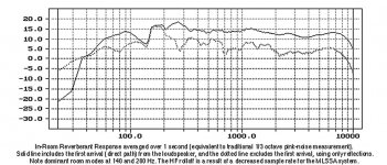

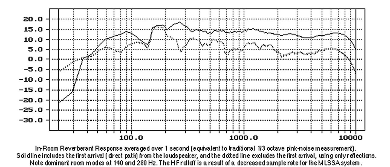

No. Not subjective matching. This is using a conventional FFT measurement system, adjusting the time window to look at the frequency response of the direct-arrival, re-adjusting the FFT time window so you're only looking at the summed room reflections, and then comparing the two sets of frequency response measurements by overlaying them on the same graph (after adjusting the magnitudes).
Here's a measurement I made on the Ariel about 20 years ago with the MLSSA system, comparing the difference between leaving the first-arrival in the measurement versus removing it. The Ariel has very broad dispersion compared to other speakers of the day, so the two curves are fairly similar.
The "Beyond" project has narrower dispersion at HF than the Ariel, so I'm considering additional up-firing drivers. Since the purpose of the additional drivers is to get the room spectra to match the direct spectra, their response will need to be shaped in the crossover.
My usual method of loudspeaker design is getting the curves where I want them, then do small (1 dB or smaller) tweaks for subjectively flat response. If I can't reconcile measurements with subjective impressions of flatness, I've made a mistake somewhere, and will try and find where that might be.

Change stuff in the crossover, whether it's passive, active, or DSP. Since the crossovers for the forward-facing drivers and the additional drivers are independent, they can have different response-shaping.
That's why I'm advocating independent measurements for the first-arrival sound and all subsequent room reflections; it makes it easier to adjust the two sets of crossovers. If the measurements are commingled, it's hard to tell what's going on with the room spectra.
Granted, listening rooms are different, but the substantial change in directivity index of most loudspeakers dominates what the room is going to do. The only way to escape the shift in DI is listen to the speaker outdoors ... which is where controlled-directivity sound reinforcement speakers come in.

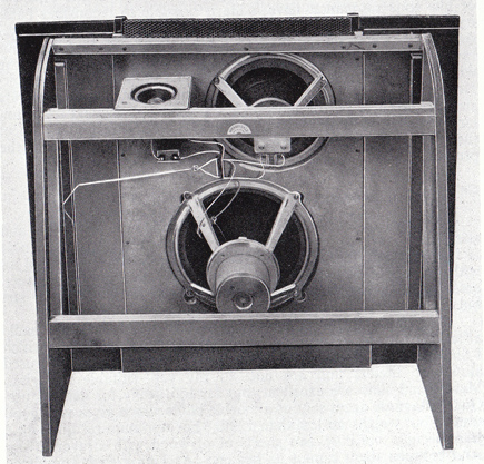

Would an open-baffle driver, like the one shown in the Briggs speaker (see pic below) then not be ideal? An OB driver automatically cancels out side-lobes of energy and show a figure-of-eight (8) pattern in radiation. The only addition I would make is a pipe, preferably about 1.5 times the diameter of the driver, mounted below it, stuffed lightly with wool. The length of the pipe would have to be equal to of greater than the 1/2-wavelength of the lowest frequency that the driver is asked to reproduce. The idea is to absorb as much of the rear (downward) wave of the driver so that it does not simply bounce off the floor and mess up the forward (upward) radiation of the driver (see illustration).
Briggs speaker:
Illustration:
Another option would be a tweeter like the Fountek NeoCd3.5H Horn Tweeter. It has very consistent diffusion off-axis in both the horizontal and vertical dimensions. Being a horn, it might show a lot of roll-off outside the coverage of the horn. See pics below for diffusion patterns of the Fountek NeoCd3.5H Horn Tweeter.
