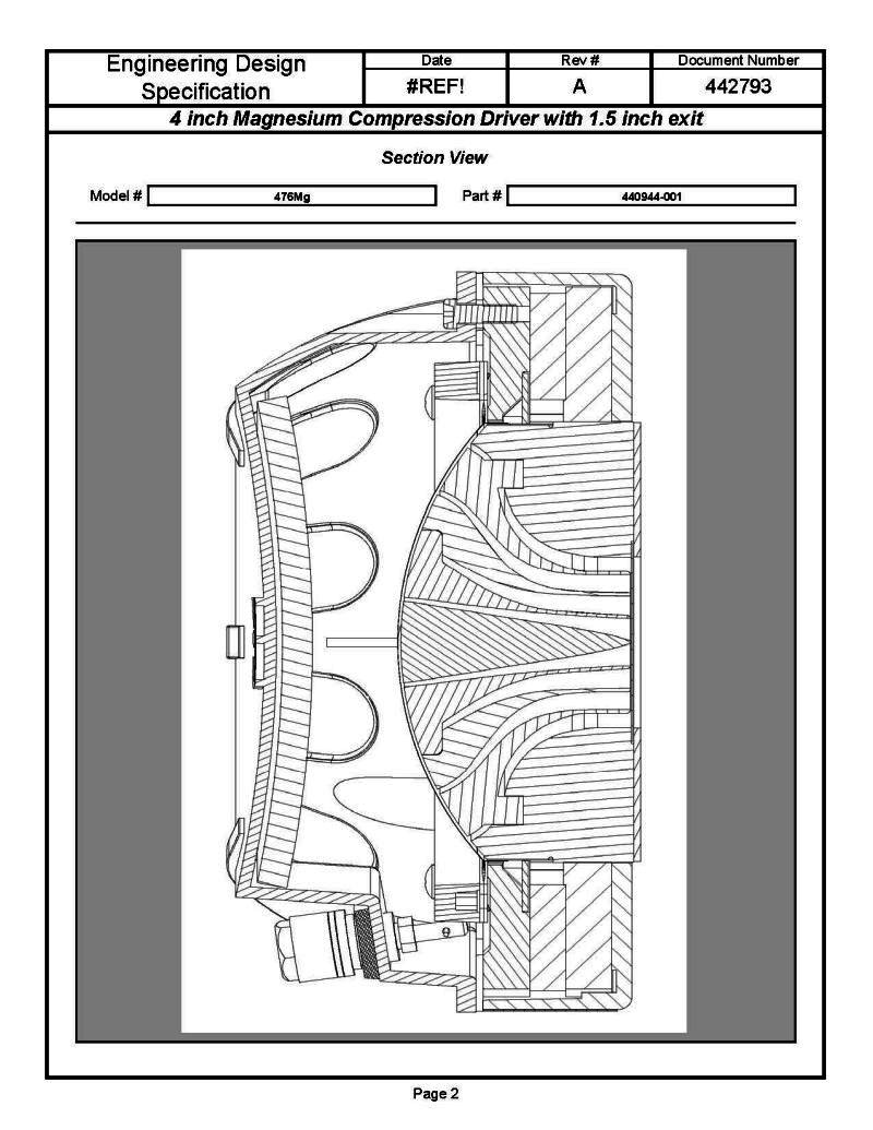

Not all companies use phase plugs are straight sided walls. JBL has been using their Coherent Wave phase plug since the 90's starting in the 2446. Attached is a cross section of a driver that also uses it.
Rob🙂

Rob,
Thanks for that, it's about time! With modern plastic molding techniques and even die casting these is no reason not to get this right.

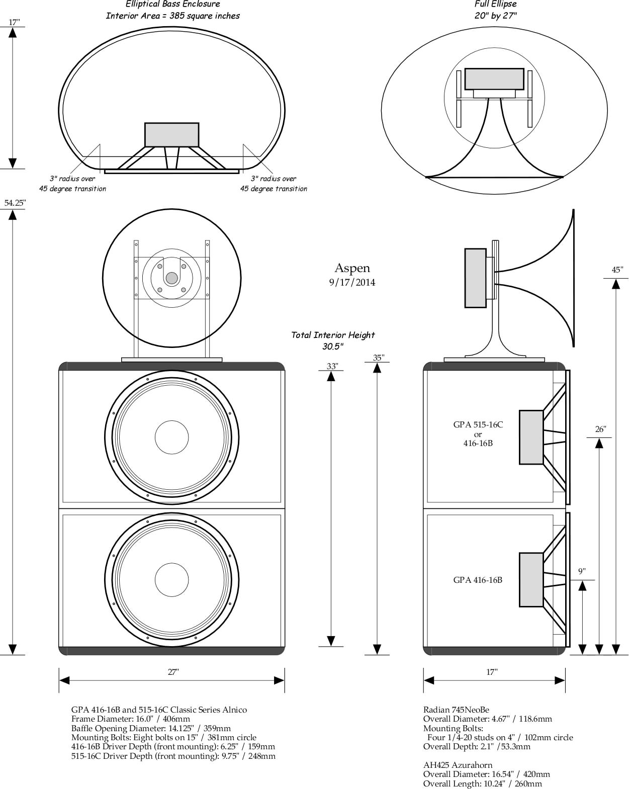

The time-alignment of the current system puts the mouth of the AH425 is about 1/2" in front of the 416 frame (as shown in the drawing). Adding another 34" to the depth of the current system makes the total depth of a time-aligned version about 46" deep; no possible way can that fit anywhere in my house. Not interested in DSP processing.
If I go with the direct-radiator version, here's a drawing of what I've been thinking of, using a bentwood bass enclosure:
