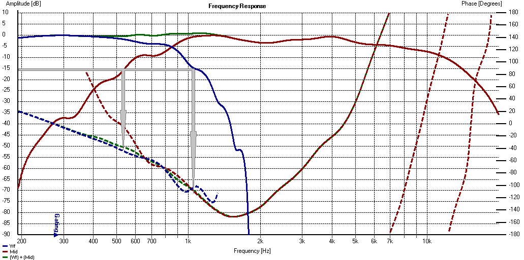

Hi all,
one thing that I noticed in this wonderfully informative and thought-provoking thread is a rather puzzling dearth of actual complete build examples, supported by actual measurements.

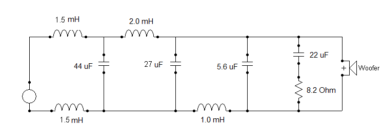

In an attempt to buck that trend, I hereby offer my own design for scrutiny, which, even if not fully "beyond the Ariel", still by and large shares the same fundamental principles.
1) DRIVER SELECTION

2) PASSIVE CROSSOVER:
For the Woofer-Mid crossover, I got inspiration from the design used by Pioneer in their TAD/Exclusive monitors (EXCLUSIVE model2402), and later reprised by Shozo Kinoshita in his Rey Audio monitors (RM Monitor), and I designed an asymmetrical 6th-order low pass / 2nd order high pass.
The crossover frequency was chosen to be 850 Hz, so as to:
(i) match the horizontal directivity of the Woofer to that of the radial horn (110 degrees);
(ii) stay approx. one octave above the horn's cut-off.

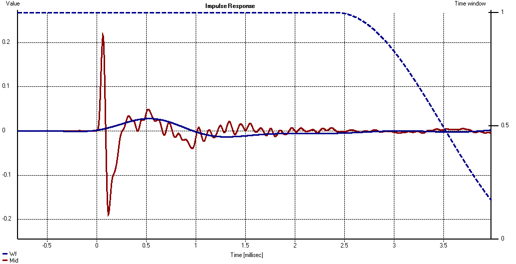

When both the Woofer and Mid are connected with positive polarity and the Mid is phisically set back so as to create a suitable offset between the two acoustic centres, this crossover results in the emissions of both drivers to be in phase over a relatively wide frequency range around the crossover frequency [see actual measurements in FIGURE 1].
This type of crossover is handy in several ways:
(i) the front-to-back offset allows the convenient positioning of the horn-loaded mid atop the Woofer box without requiring any form of delay (digital or otherwise);
(ii) the same offset also happily results in the two impulse responses to be almost perfectly 'time aligned', i.e. both traces leave the horizontal line simultaneously [see IR measurements in FIGURE 2];
(iii) the 6th-order low pass effectively does away with any unwanted resonances at the top of the woofer's operating range.

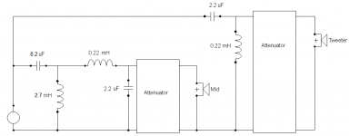

For the second crossover between Mid and super-Tweeter, I opted for a symmetrical 2nd-order Buttwerworth at ~7.5 kHz, which gives a Constant Power response.

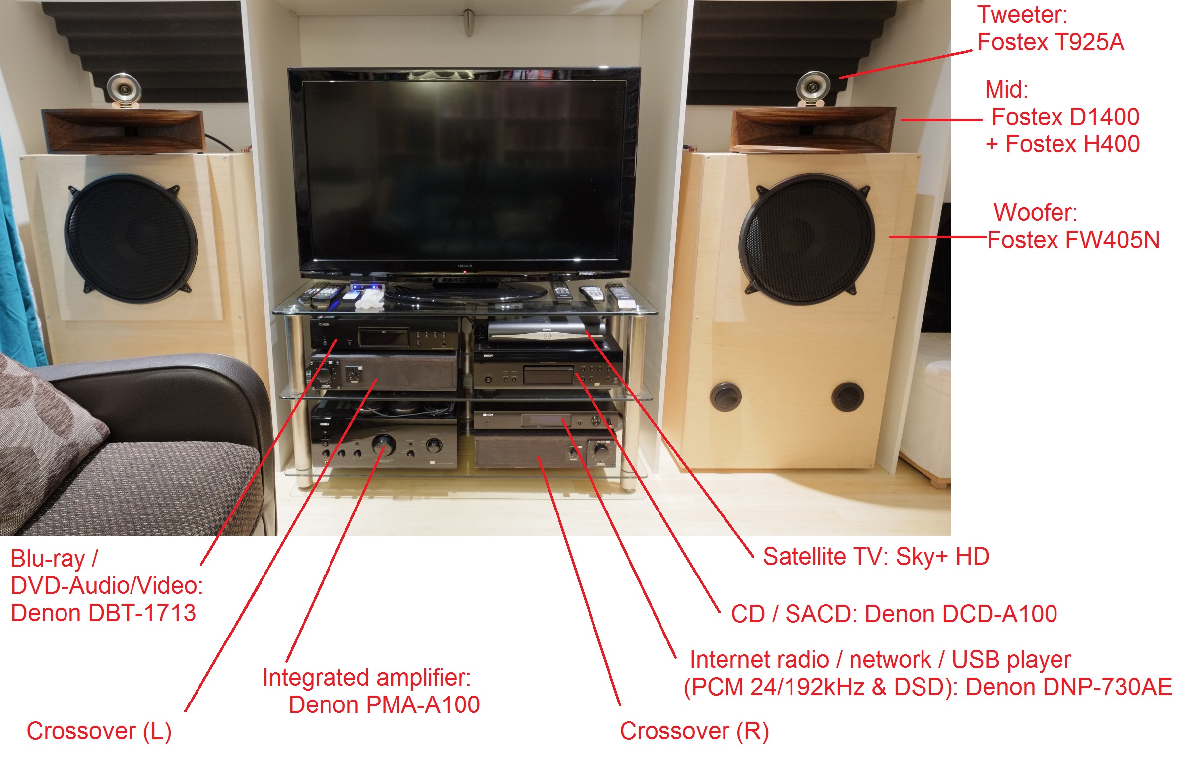

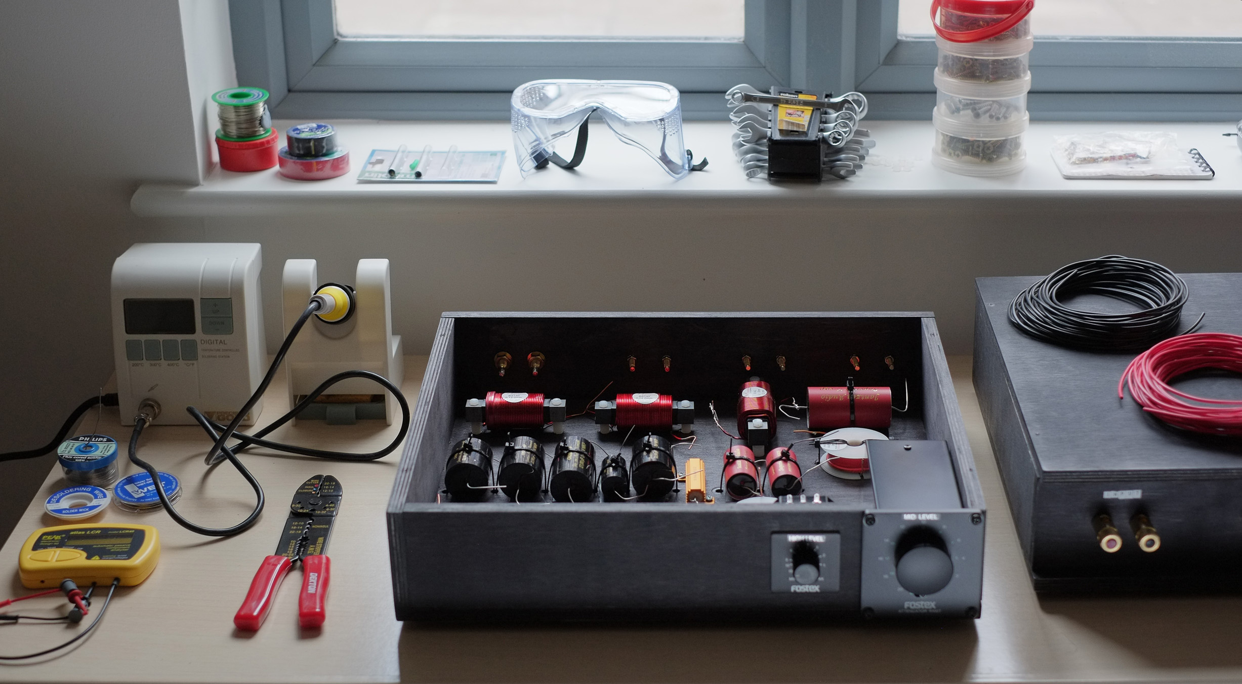

From a practical point of view, the complete crossover was built using quality parts (Mundorf coils and Jantzen MKP capacitors), and housed in two external wooden boxes [FIGURE 3].
The woofer low-pass section [FIGURE 4] uses a semi-balanced topology to reduce crosstalk with the mid and tweeter sections [FIGURE 5].
Both the compression driver and the super-tweeter are attenuated using variable units by Fostex (R80B/R82B/R100T | FOSTEX), respectively the transformer-based R-100T for the CD and the R-80B potentiometer for the sTw.

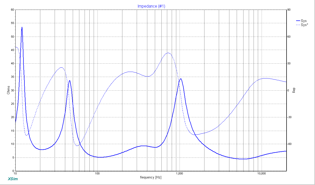

The resulting system impedance plot is shown in [FIGURE 6].

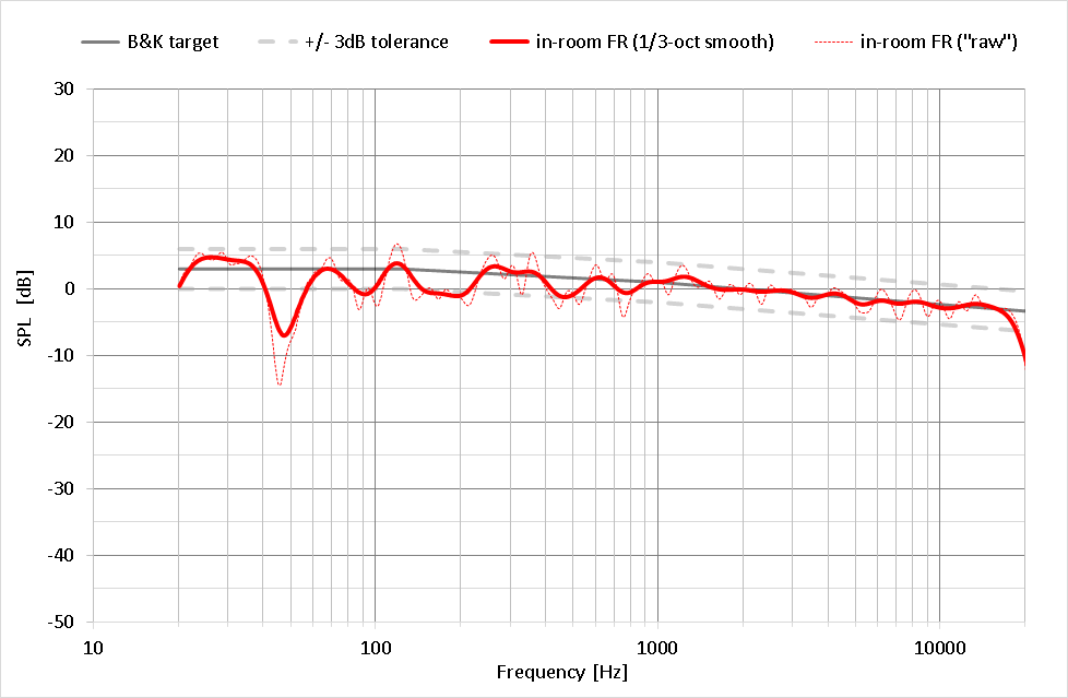

The final system's measured in-room response (unequalized and not corrected in any other way) is shown in [FIGURE 7], with superimposed the well-known Bruel & Kjaer 'target' function, as well as a +/- 3 dB tolerance band.

C&C welcome!
