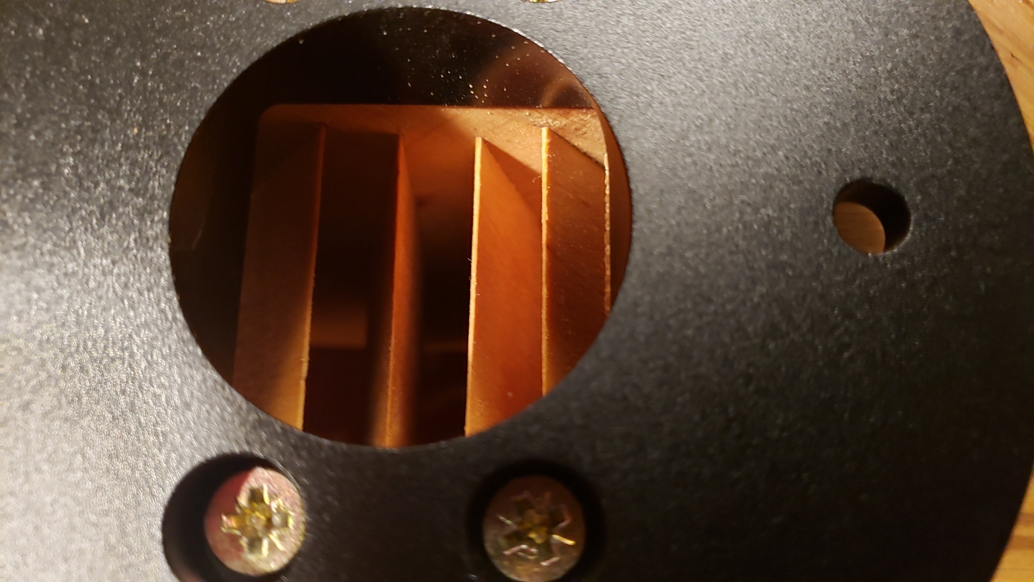

I have never heard of 2440/41 with a 5-slit phase plug, I believe they are all 4-slit. The Radian has a 5-slit phase plug, but I'm not sure I would say it's a superior driver like you do. What makes it superior in your opinion? It has the awful step in the throat that has been discussed earlier in this thread, I can't imagine that does anything good to the sound. I have also found it difficult to match with horns, never had any success with it tbh. The JBL 2441 with beryllium on the other hand, sound glorious (tried BE in Radian 950 as well). The Radian 1245 also sound nice in JBL 2440/41.The 2440 in the scheme of things is ancient, they were in production for more than 30 years before being phased out due to a long ago shortage of Alnico. Mine are later and IIRC have the 5 slot phase plug. (I forgot already despite putting diaphragms in them a few days ago.) There is a lot of misinformation about them on the net. Mine I would guess are around 40 - 50 years old.

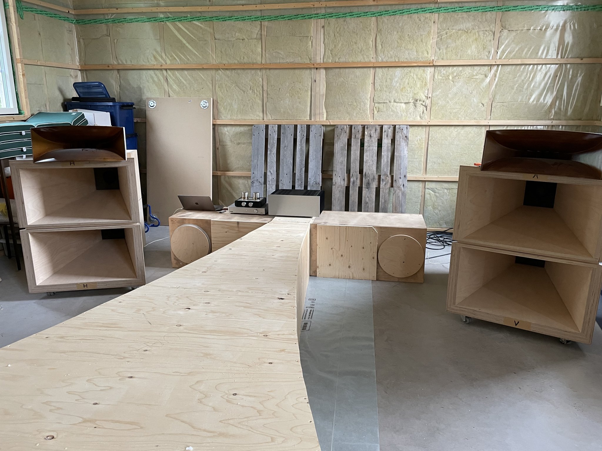

I guess i am one of those old deaf pricks then
as i have Yuichi and TAD 4001 and think they are marvelous. Here you see them on top of my mid bass horns. Could not fit the bass horn in the picture. The room is not ready yet as I need to build a floor above the bass horn. But it plays pretty well in this setup too

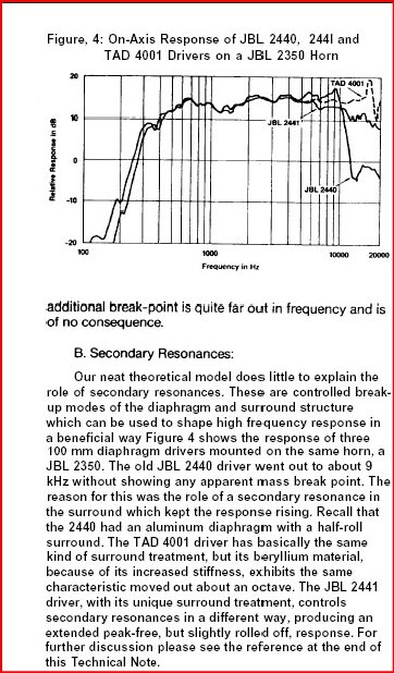

Interesting. Since Kevin is crossing to a horn tweeter circa 8 kHz, I wonder how audible those breakup modes in the 2” exit drivers will be.
My hunch is that the TD-4001 will have a frequency response similar to, but perhaps a little flatter than the JBL 2441. It might have lower distortion, too.

The controlled break up modes are used to extend the HF response obviously, the 2441 diaphragm utilizes them to extend its HF response. I cross below where this should be a major factor. If the TAD uses break up modes at all I would expect them to start higher. Supposedly the benefits of BE are low mass and stiffness which I would think reduce the likelihood of diaphragm break up modes? I have the JBL paper Docali references - I've always thought that was JBLs response to a driver they perceived as a potential threat to sales/reputation in some categories.Interesting. Since Kevin is crossing to a horn tweeter circa 8 kHz, I wonder how audible those breakup modes in the 2” exit drivers will be.

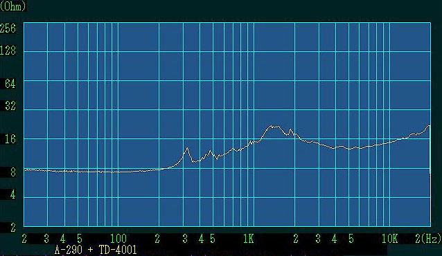

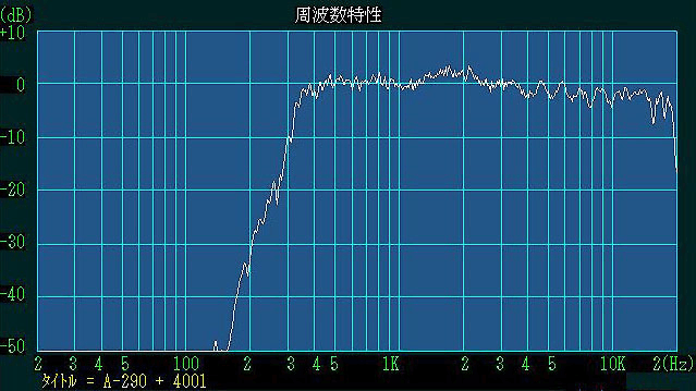

@docali once I have them I will do free air and on horn impedance and phase measurement and then a near field frequency response measurement - this I would think will be very revealing. I have not so far been able to find any measurements of this driver other than on horns like the Yuichi.
From Yuichi:
TAD-4001
TD-4001 Impedance on horn
In addition to free air (no horn) you might also run an impedance sweep with the exit blocked. That's about as much acoustic load as they would ever get.
Earl Geddes has mentioned that he free air, blocked and also with the back off in order to model compression drivers.
