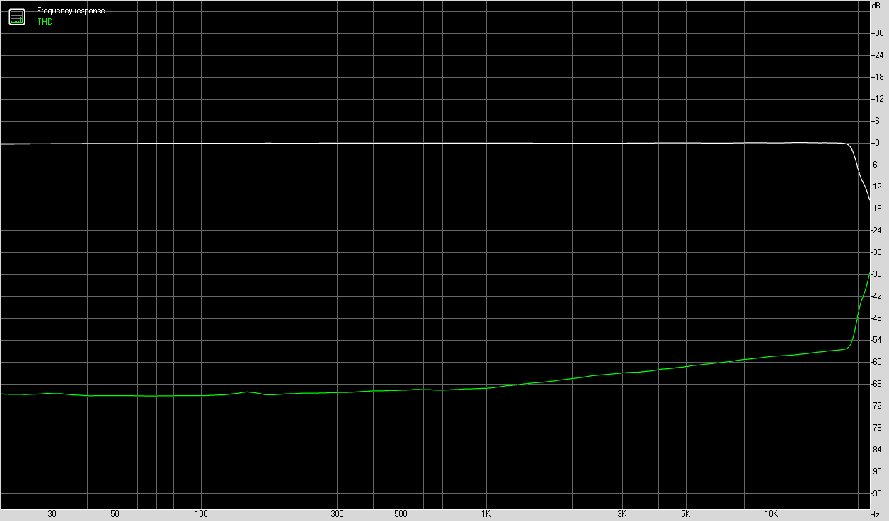

Exciting. As a noob I'm confused by some of the discussion in this thread about the output caps. Am I reading correctly that the cap value should be chosen based on the impedance of headphones to be used with the amp? I'm planning to use my 50 ohm Sennheiser HD 598 cans, a far cry from your beefy Beyers, X. Will I need to change anything? Also, I can't find it if you've posted it already...have you measured the output impedance of your Wintergreen amp? I've read some of NwAvGuy's blog posts about the 1/8th rule...
I don't know how to actually measure output impedance. It's something I can simulate and predict though. Regarding the output cap, then RC time constant as given in the formula previously by AndrewT let's you estimate it. But if the 47uF is good for 250ohm headphones then scale linearly for lower impedance. So 50ohm headphones should have 5x bigger or 150uF. Although there is some leeway as these are slow roll off slopes and we set them a decade below the needed bandwidth. You may find sufficient bass exists with even 100uF on 50ohm cans. The frequency response measurement was absolutely flat down to 20Hz within less than 0.5dB on 270ohm load.
Here is measurement of frequency response. I recall the sim showing things rolling off starting around 100Hz but measuremt doesn't seem to show this (at least not on this larger scale). This is a really flat response actually - textbook perfect. The rolloff on top is the sound card response I think.

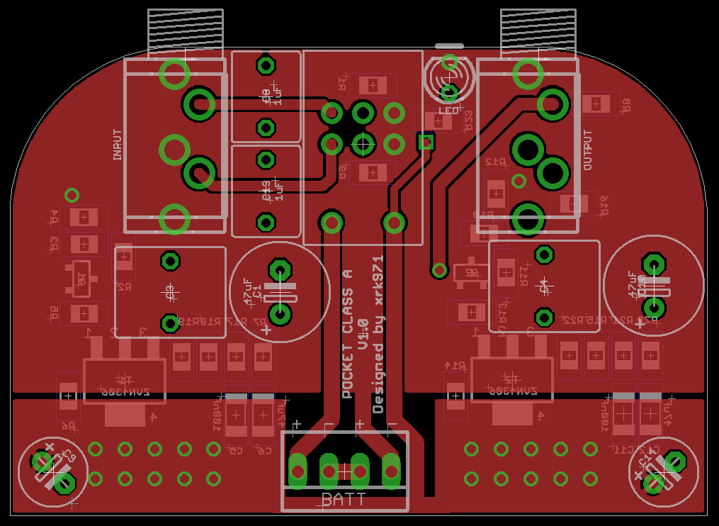

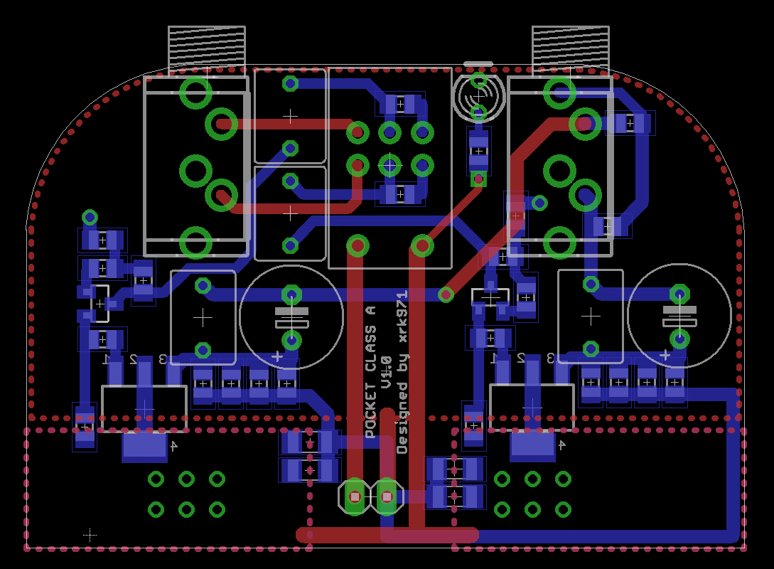

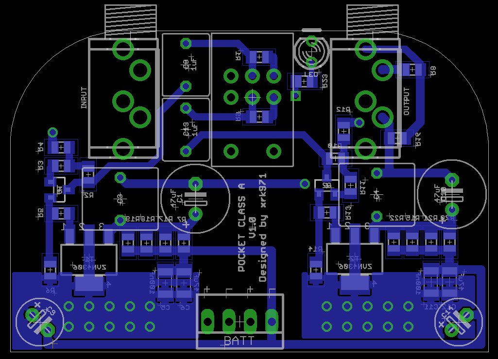

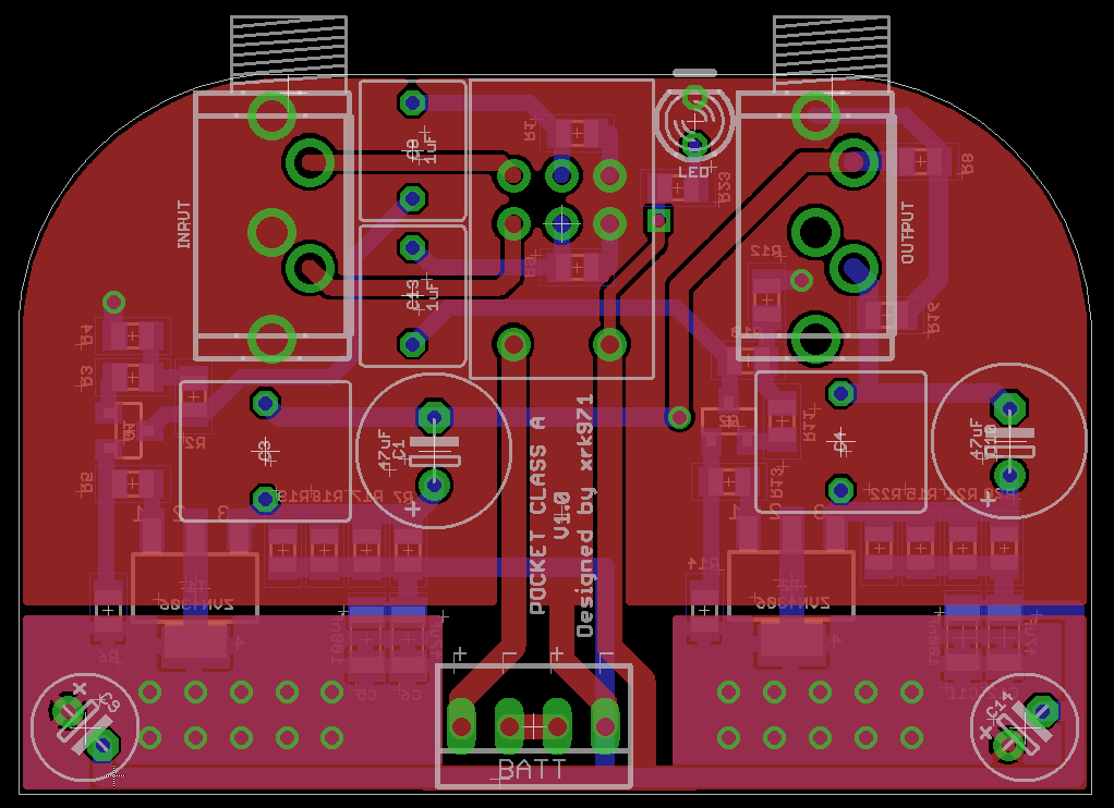

BDHM,
The layout looks great. Are you using 2x100uF power rail smoothing caps like I had on mine? It's on the PCB thorough hole side. Also, I see a couple of resistors on the pot wiper - what is that for (or is that just the 100k resistors normally located elsewhere)? What kind of connector are you using for battery to PCB? I like those small snap in (Molex?) micro connectors. Straight soldered wires to PCB is not as good and if doing that we need 4 connections for the two battery terminal wires, tied in series.
Thanks,
X
Thanks,
X
![592258d1484483155-bf862-based-se-class-headamp-without-heat-class-mints-v6-both.png](https://www.diyaudio.com/forums/attachments/headphone-systems/592258d1484483155-bf862-based-se-class-headamp-without-heat-class-mints-v6-both.png)
If you look at the earlier versions you'll see the big electrolytic smoothing caps. I omitted them in the latest one just for clarity. So as things stand the power rails have 100-470uF electrolytic, 47uF ceramic and 100nF ceramic bypass for each channel.Are you using 2x100uF power rail smoothing caps like I had on mine?
Yup, those are the 100k resistorsAlso, I see a couple of resistors on the pot wiper - what is that for (or is that just the 100k resistors normally located elsewhere)?
The holes are standard 2.54mm pitch, so a Molex connector or pin header will fit just fine.What kind of connector are you using for battery to PCB?
I figured the series connection would happen on the battery side, but I'll see if I can fit a 4-waywe need 4 connections for the two battery terminal wires, tied in series.

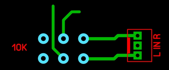

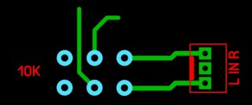

That would be awesome! If it isn't too much to ask, could you include the 5mm spaced pads for a larger volume pot? Something similar to what I use below.
I'm not a fan of the ALPS RK09 or any of the other small cheap pots.
Thank you!
Sure thing
