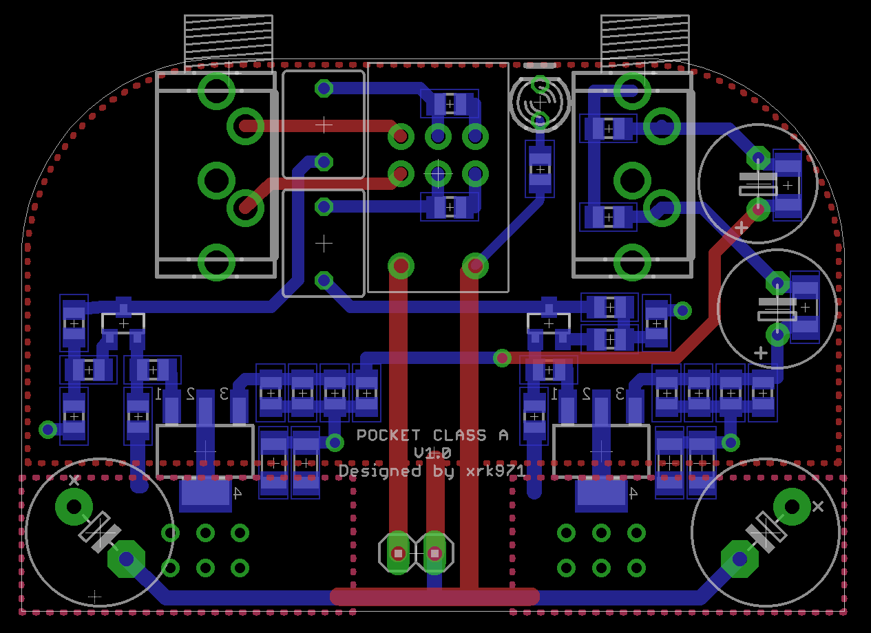

Is there anyway to put two 0.47uF 100v MKP caps in parallel with 47uF output caps? These are the small 5mm radial rectangular plastic package.
It might be possible with MKT, but MKP would be too large. The ones in the picture are MKT, yesno?
edit: Heck, Wima make a 470nF MKT cap with a 2.5mm pitch

I actually have Vishay MKP yellow one
Good point. And as far as the value goes? Is 470nF good, or should we consider something else?The difference between MKT/S and MKP will be miniscule in comparison.
if you want to pass 100Hz then I suggest you choose the F-3dB of the high pass filter to be one decade below that, i.e. 10Hz high pass filter will pass virtually all of the audio band from 100Hz upwards.
If you have F-3dB = 10Hz and the capacitor is 470nF, then the load (the R part of the CR filter) will be
R = 1 / {2 Pi F C} = 338r6
i.e. a 340ohms headphone will receive 100Hz and upwards when a 470nF coupling capacitor is used.

I've never seen 470nF polypropylene that compact before. The highest capacity I've found in a 5mm pitch is 330nF, and those suckers are 8.5mm wide.
Those are MKT caps with 5mm LS, not MKPs.
As you stated, MKP would be much larger since that value would have a LS of at least 7.5mm.
MKTs are still quite good for audio coupling.

My mistake, I have Kemet 0.47uF 100v Polyethylene Terephthalate (PET), Metallized Film caps. is this same as MKT?
R82EC3470DQ70J KEMET | Capacitors | DigiKey
In any case, they are doing a fine job as can be seen above.
No worries...we all make mistakes especially with all the different caps out there.
Yes, they are the same as MKT.
