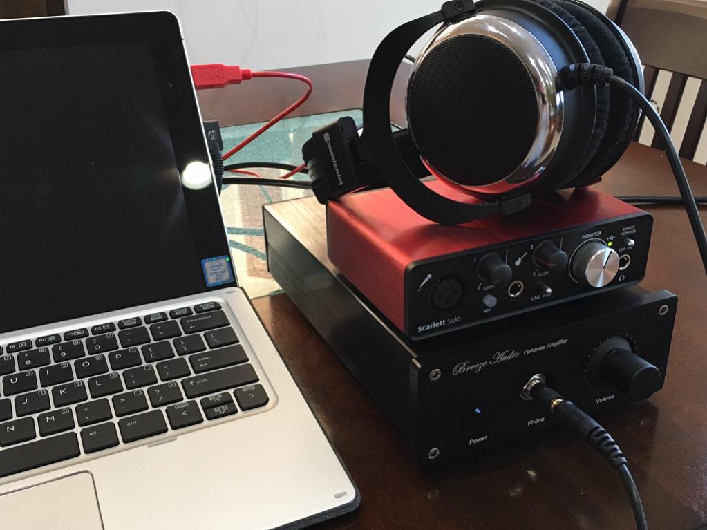

After extensive listening and actual use as a desktop amp paired with the Scarlett Solo 2G, I have to say that I am really happy with the sound. So much so that this is my new reference desktop headamp. In practice, it works superbly as well - no turn on/off thump (thanks to the slow start/stop feature of the cap bank and cap multiplier), no noises from connecting or disconnecting phone jack while powered up, absolutely no noise from any pot movement (cannot tell it is on if no music playing). The Solo 2G as DAC for my laptop seems to fit perfectly sitting on top as the two are same width and have a similar look. The sound is about as close to perfect as I have ever heard. The BF862 and 2SA1837 combo with a cap bank and cap multiplier seems to do the trick. Note that there is only a single power supply connected to both channels but it achieves a nice measured -88.5dB stereo crosstalk figure (thanks to cap bank I think).
This combo with Beyerdynamic DT880-250, Focusrite Solo 2G, laptop, and BF862-2SA1837 two transistor SE headamp is just about perfect.

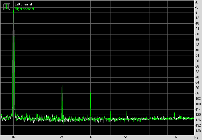

I adjusted the R6 pot for exact balance and match of harmonic distortion profile between left and right channels. THD is now at 0.0072%. H2 is at -86dB and H3 is at -96dB.
There must be something to burning in because I now measure THD at 0.0056% after playing music for 24hrs on the amp. Dynamic range is measured at 92dB and IMD+N measured at 0.0091%. These numbers are almost approaching some opamp based headamps that I have, but doing it with the immediacy and impact of 2 transistors in pure SE Class A.
