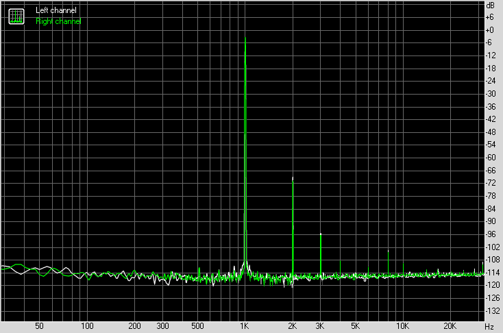

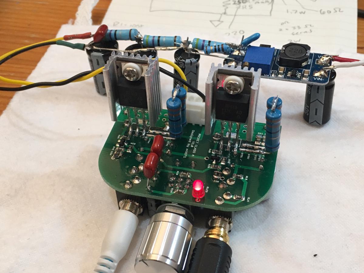

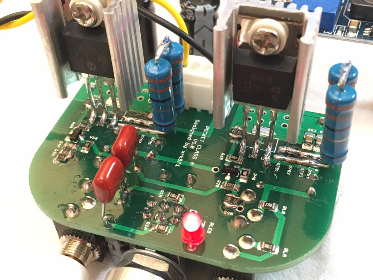

I was able to implement the above circuit using one of the pocket class A amp boards as the basis. I am using two 33R 2W resistors in series for the main power resistor. Two 2k2 in parallel give me 1.1k for the JFET Drain, 1000uF 16V OSCONS on the outputs bypassed with 1uF Wima's. On input using 10uF 63c electrolytic bypassed with 0.1uF 100v film cap. 20v supply provided by 19v SMPS going into step up DC-DC converter for 20.0v. Voltage at source of IRF610 is 9.38v and 9.43v which is about 140mA bias over the 66R resistors.
I listened to it first before measuring and it was powerful but sounded kind of dry. I do not hear any hiss or hum. The measurement shows a broadband white noise at covers DC to audio. The FFT shows that the H2 is indedd very low, hence dry sounding. The SMPS has broadband white noise i the LF's sneaking through the 470uF//4.7R//470uF//4.7R//2200uF//4.7//200uF CRCRCRC filter. Looks like I may need some bigger caps in my CRC to get the broad band noise down.
Anyhow the circuit works - and will need some more work to optimize the noise problem, also probably change R4 to get harmonic profile desired.
THD came in at 0.0078% (too low for my taste), dynamic range is 85dB due to the broad noise hump from the SMPS, stereo crosstalk is -69.2dB.
I am listening to some test tracks now, sounds very nice - great dynamics and headroom. Can get very loud on transients. Daft Punk has some slamming bass. I do not hear any hiss or noise. The measurement does show a low level (-84dB) broadband noise floor rising up below 100Hz. I think this has a lot of promise with some tweaks on a few resistor values and a cleaner PSU.

(emphasis added)...THD came in at 0.0078% (too low for my taste)...
And, yet, you favored the 2SA1837 CFP amp over many others despite the fact that it offers even lower distortion... Do we want hi-fi equipment or effects boxes? Seems you've chosen the latter, despite your previous claims that you are overly sensitive to distortion.
Through that? I very much doubt it. More like around it. Since you did not hear anything in headphones, the problem may be common-mode noise from the SMPS on the ground making its way to PE via your measurement PC.I listened to it first before measuring and it was powerful but sounded kind of dry. I do not hear any hiss or hum. The measurement shows a broadband white noise at covers DC to audio. The FFT shows that the H2 is indedd very low, hence dry sounding. The SMPS has broadband white noise i the LF's sneaking through the 470uF//4.7R//470uF//4.7R//2200uF//4.7//200uF CRCRCRC filter.
*sigh*THD came in at 0.0078% (too low for my taste),
What's IMD(f) like?
BTW, you should be getting better stereo crosstalk than just 70 dB unloaded. Smells like too much shared ground return between the channels.
This is first sound test. Let me add a proper cap bank to boost the capacity of the rail caps. Same 2200uF x 2 as used on 50mA bias version and now bias is 3x higher. Probably need to boost caps to 6800uF x 2 to have similar stereo crosstalk separation. I knew you guys would have fun with my distortion comment. For the record, sensitive to odd order distortion . Let's see if a 9 x 2200uF cap bank will improve things.

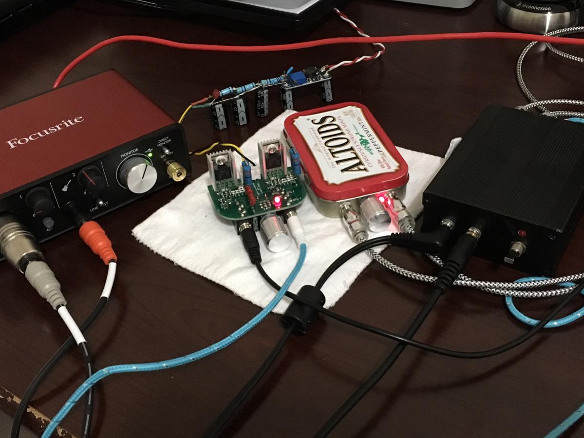

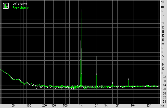

I dropped the supply rail down to 16.5v (trim pot on DC step up), also now using 12v SMPS from external Maxtor HD. The harmonic profile looks much better now. I am running 93mA bias in IRF610 and 5.5mA in the BF862. I used my AB switch box and compared with the Pocket Class A and really could not tell a difference in sound with my 250ohm headphones at 140mA, so figured just drop down and reduce heat output by a lot.
AB Test Setup:
FFT at 16.5v supply rail:
Just need to work on getting better isolation from that broad rise below 100Hz.
*sigh*
What's IMD(f) like?

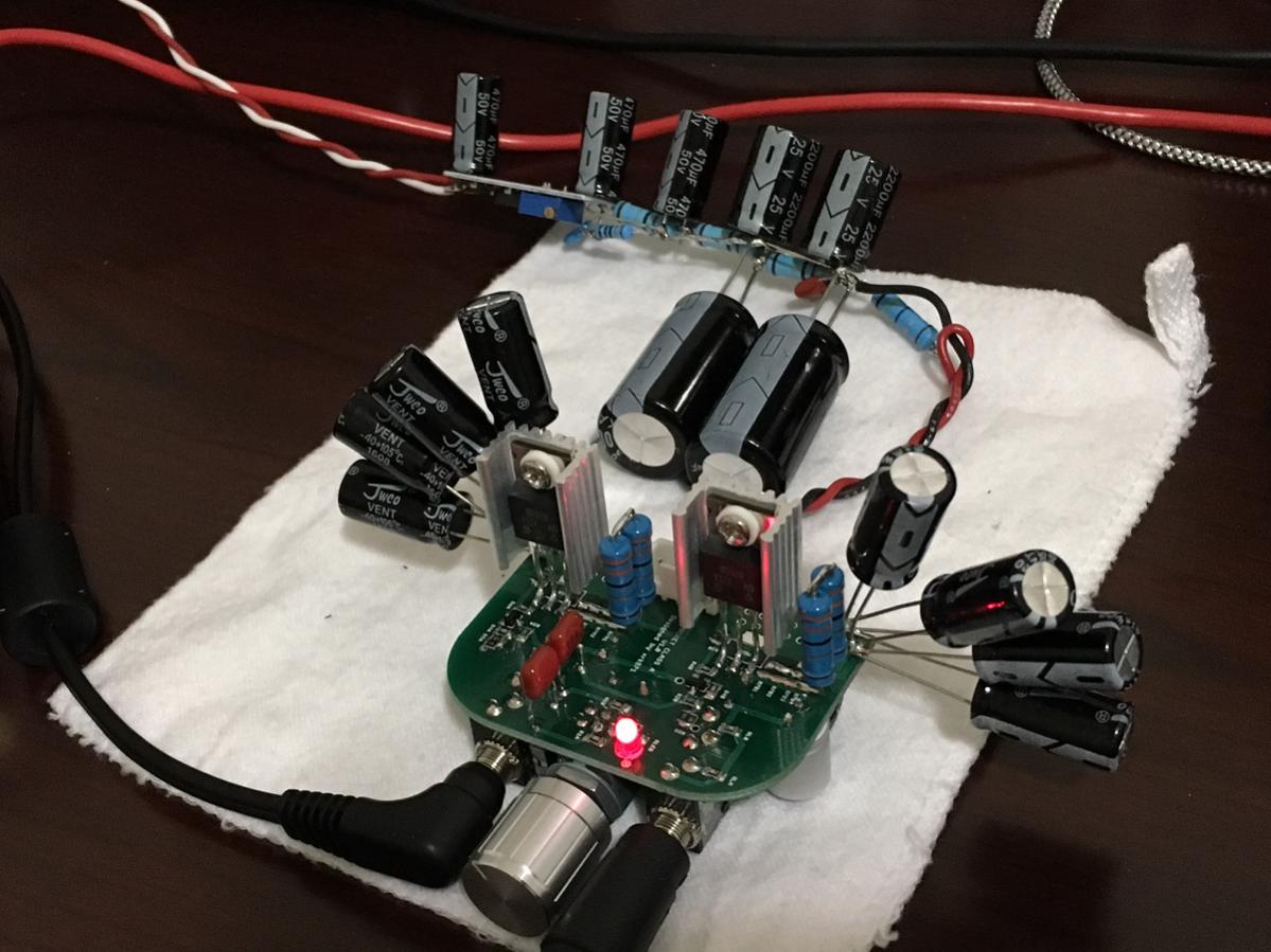

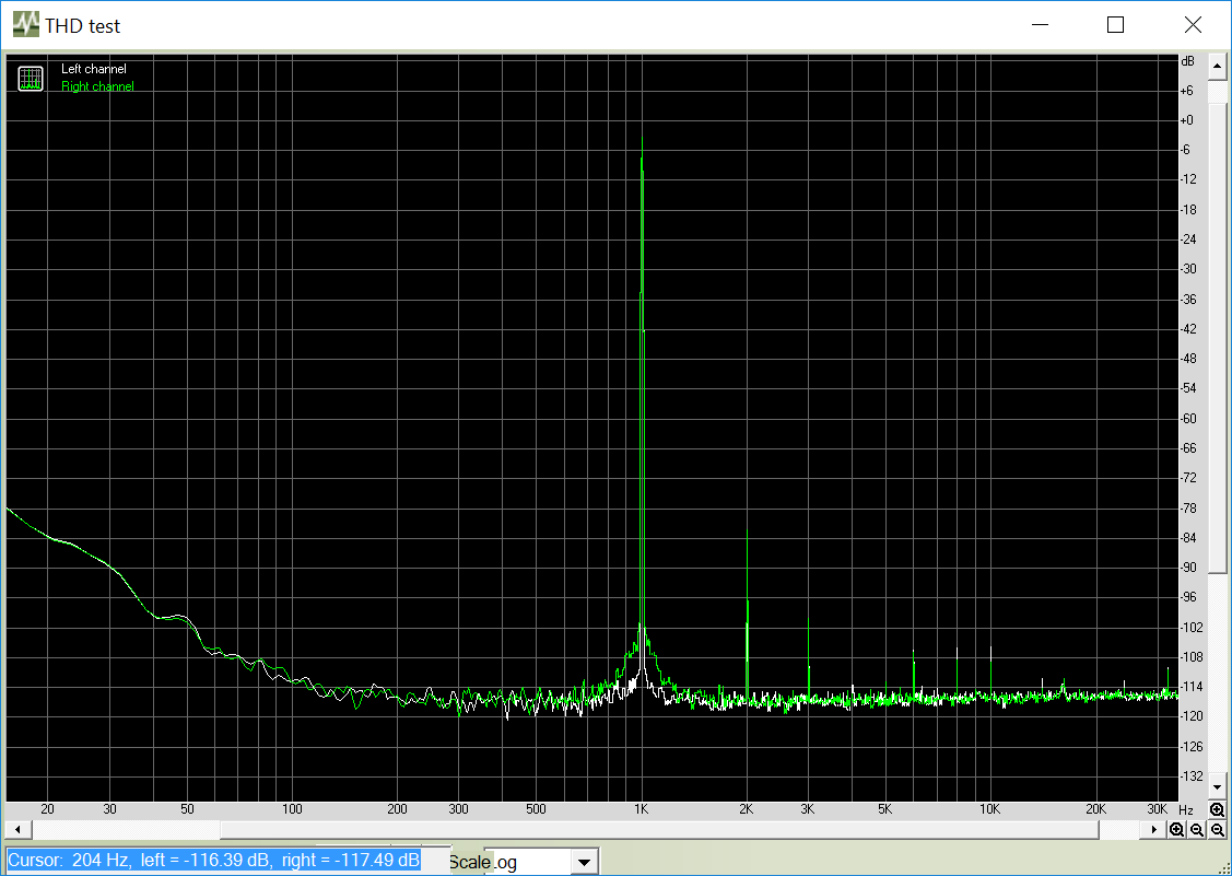

Well, lowering bias to 93mA and adding 10mF x 2 on the final CRC and then 8 x 2200uF cap bank on the amp itself seems to have fixed everything.
No more broad white noise below 100Hz, stereo crosstalk is now -76.2dB, THD is now 0.048%, IMD is 0.046%, harmonic profile looks really nice now.
Here is the "Iron Throne" Cap Bank and you can see the two big 10mF caps added to the final CRC:
Total power train looks like this:
12vdc 3A SMPS//470uF//DC-DC (19.65v)//470uF//4.7R//470uF//4.7R//12.2mF//4.7R//12.2mF//0.47R//17.6mF(cap bank)//Vcc rail (16.5v)
So I think I achieved my goal of a very clean low ripple (-114dB) power supply that is mains powered without any heroic efforts (no shunt regs or cap multiplier, etc). Just SMPS, DC-DC-step up, and passive CRC filtering.
Oh, and how does it sound now? Fantastic! Deep dark background, super dynamics, powerful bass that grabs you. Very engaging vivid presentation.

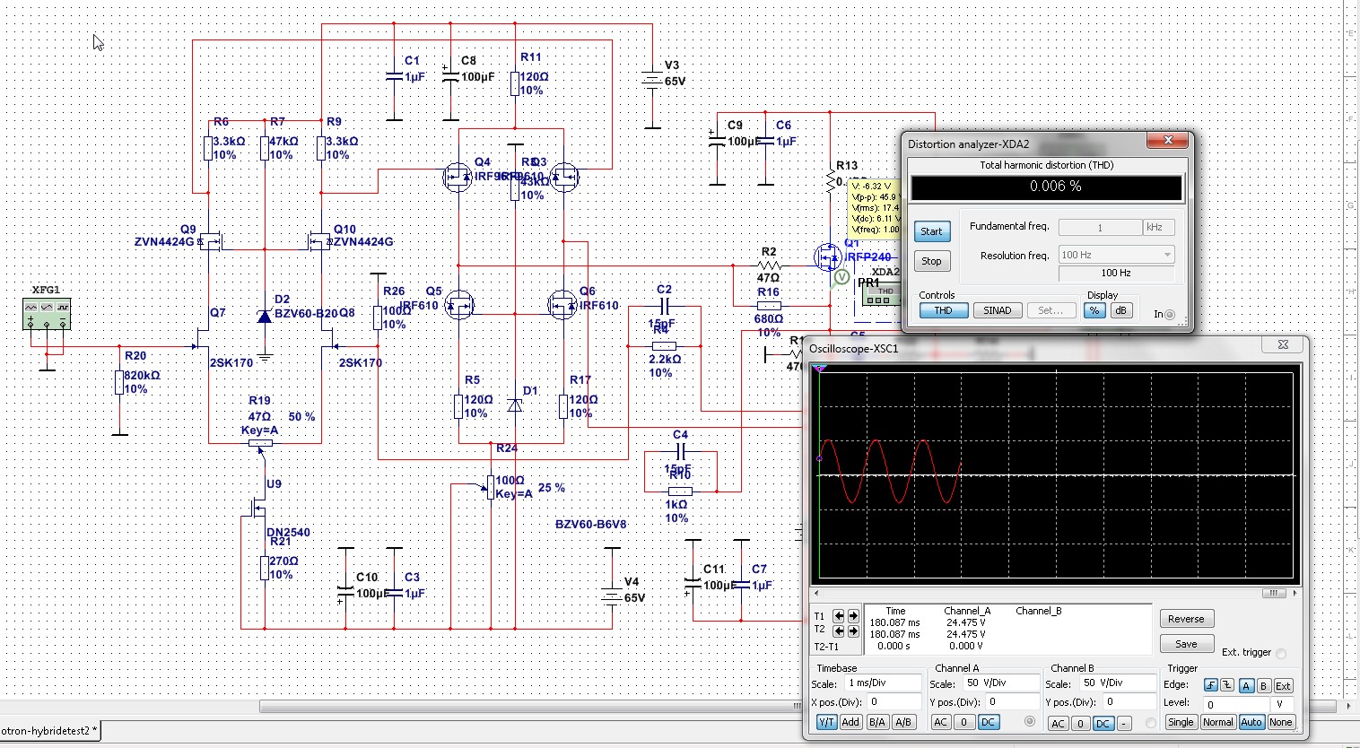

Earlier in this thread you posted the "as built" schematic of the winner, the BF862-2SA1837 combo.
For fun, change R2=75R and R7=27R in your model, and then run it again. Notice any change?
When I made that change, the THD dropped an order of magnitude. Seems too good to be true.
I'd be interested to know what you see.

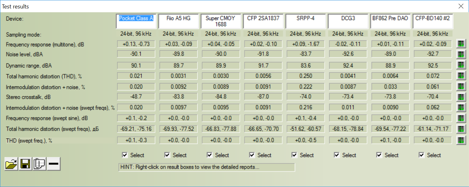

It's true - I knew this already and saw the same thing and the amp in reality and can be even lower. That Toshiba 2SA1837 is a special transistor.
If you recall, the measured THD on blind comparison was 0.0056% and depending on resistor tweaks, can be 0.002%.
Then the 0.03% (in text) on the model was a typo?
No, the model predicts higher THD than measured. I guess the model of the 2SA1837 may not be accurate enough.
OK, just curious. It is really hard to believe that a less then 10% change in resistor values could give an order of magnitude change. I'm still not sure I believe what the models are telling me.
