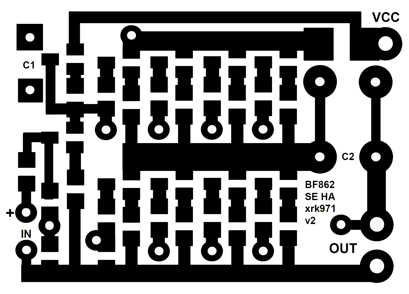

Shrinking it down maybe about 23mm x 16mm now for a mono amp.
Sorry got the size wrong. It's 37mm x 26mm for one channel.

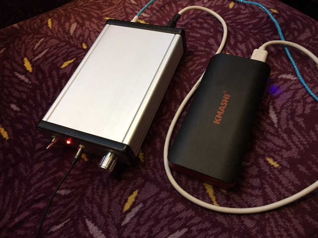

Listening impressions update with balanced armature IEM's. I have very sensitive Aurvana 3 in ear monitor headphones (112dB/mW and 60ohm) which don't need any amplification but are great for checking audible noise/hiss and sound balance.
Well good news: I cannot detect any hiss except a very slight almost inaudible level hiss at the highest (last 90%) volume setting which I would obviously never use as it blow my eardrums and the IEM's given their sensitivity. The sound is like I have never heard from these before - rich, full, great detail and articulation, superb bass. Wow. Class A sound with 2-way balanced armature drivers sounds fantastic. I think one way to describe the sound is superb no distortion and great bass authority with clean and distinct bass lines. You don't know what you are missing until you hear it.
I am also testing out my idea of portable use with a 5v USB battery pack capable of 2.1 amps. Partially good news here: it works fine for the IEM's as they don't take much power but the DT880's lack bass on deep bass notes. It's like the battery pack ran out of juice. Surprising since 2 amps x 5v should be 10w and amp draws about 2.5w assuming 50mA x 22v per channel and 90% efficient on the step up. But it could be that peak currents exceed what can be provided even with 10mF reservoir cap.
But I would never use open-backed DT880's on a commuter bus anyway as they don't block the high levels of ambient noise.
Here it is in use on my bus ride:

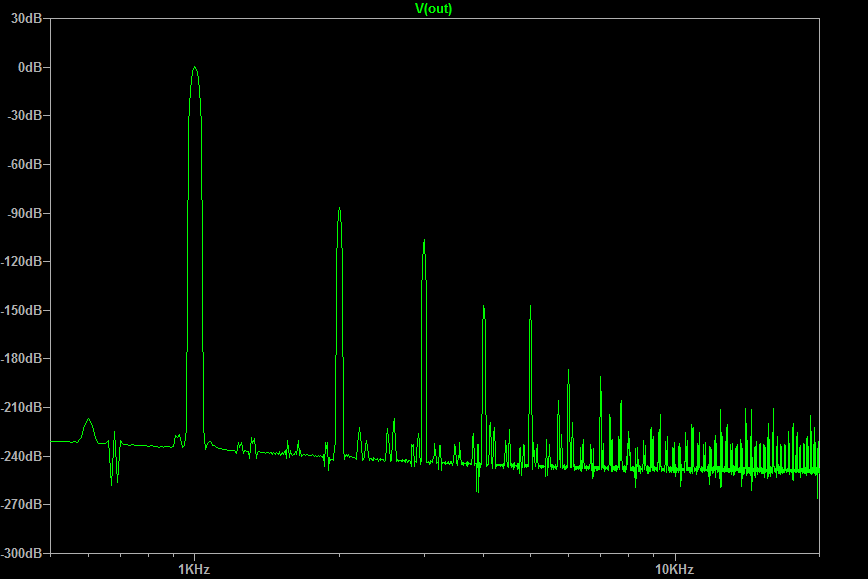

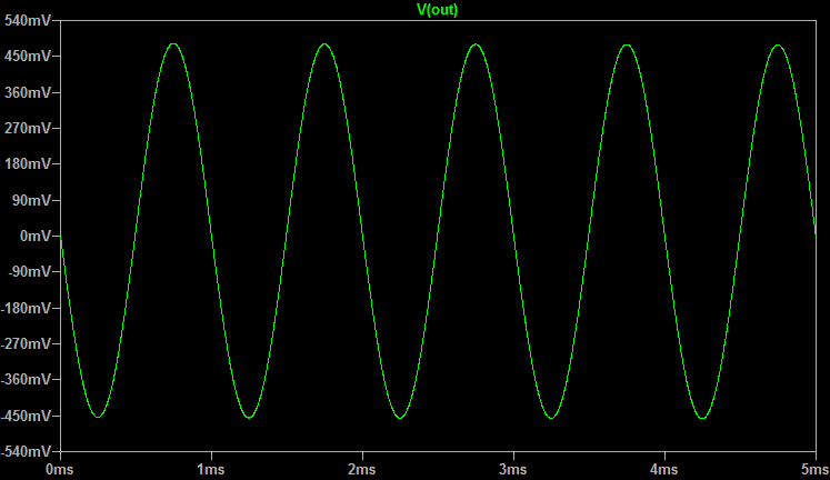

LTSpice Model As-Built

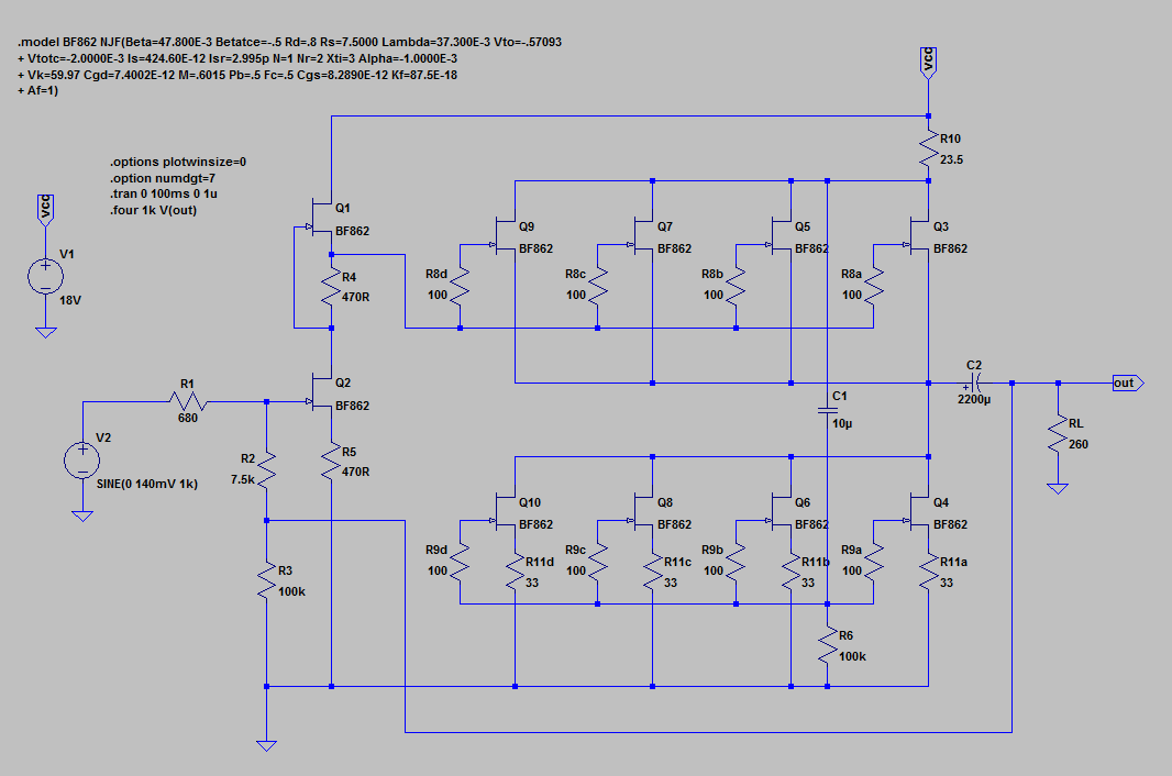

I just got a new tablet and installed LTSpice XVII on it and learning LTSpice now. I normally use TINA. Anyhjow, I modified EUVL's LTSpice model provided previously with my as-built values: 18v supply, 33R source resistors, 2200uF coupling cap, 10uF gate cap, 260R load. I am getting about -85dB H2 and decreasing higher orders. The default config had higher H3 than H2 (which I do not like as much as higher H2 than H3).

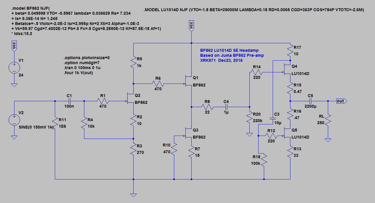

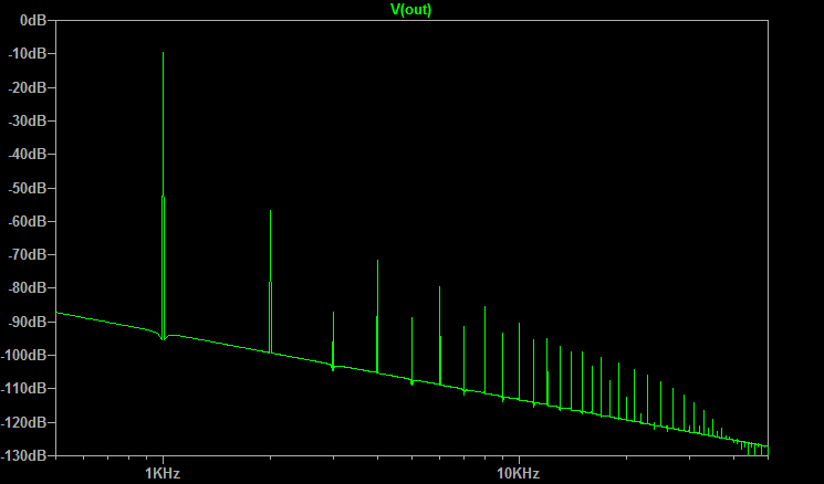

What do you guys think of this BF862 and pair of LU1014D for outputs? What cand I do to improve it?

one can calculate gm (Yfs) from Idss and Vpinch off.It was helpful to read up on SRPP.
The Tube CAD Journal: Mixed Mode Amplifiers
I will order some a bunch more BF862's and try to match them. Idss is easy. How to measure Yfs? Need a small rig with contact pads and press clamp in place to measure.
http://www.nxp.com/assets/documents/data/en/application-notes/AN211A.pdf
See Borbely.
i.e. match Idss and then from within those batches select Vpinchoff and you have roughly matching curves.
