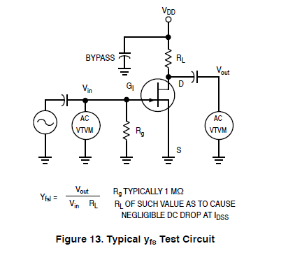

one can calculate gm (Yfs) from Idss and Vpinch off.
See Borbely.
i.e. match Idss and then from within those batches select Vpinchoff and you have roughly matching curves.
Ok, thanks for the tip. The hard part is making an adapter board to measure ea SOT23 with clamp pressure. Yfs can also be measured directly with two DMM rig.
Fig. 13 from here:
http://www.retro.co.za/zs1ke/FT-107/AN211A.pdf

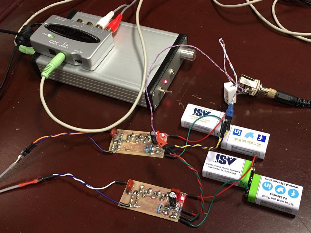

It's singing now.... need second channel for stereo to do sound quality assessment. What I hear so far in one ear is surprisingly good. This Juma-Aksa design is very easy to make. I am using Idss matched JFETs.
![588294d1482991424-mosfet-source-follower-headamp-juma-aksa-bf862-ha-build-03.jpg](https://www.diyaudio.com/forums/attachments/solid-state/588294d1482991424-mosfet-source-follower-headamp-juma-aksa-bf862-ha-build-03.jpg)

It's pretty amazing what you can do with 4 tinyJFETs. The best part is the predicted harmonic profile having pretty much only H2 at -61dB and H3 at -121dB. I will try a single MOSFET output version with more current capability and no need to match devices.

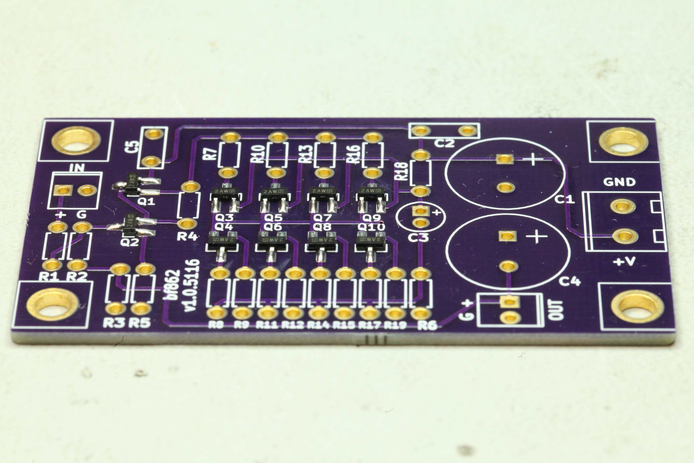

In your as-built model, you changed R11a, R11b, R11c, and R11d from 1R to 33R. Was this a model-only change, or did you change this to reduce dissipation through the FETs? I've just started soldering parts on my board, and want to keep abreast of changes me by others and why. Why make the same mistake twice?

Yes, I changed to 33R to get about 13mA current though ea leg. At 1R, it was basically too much current (saturated).
Nice PCB! You had that made at board shop in China?

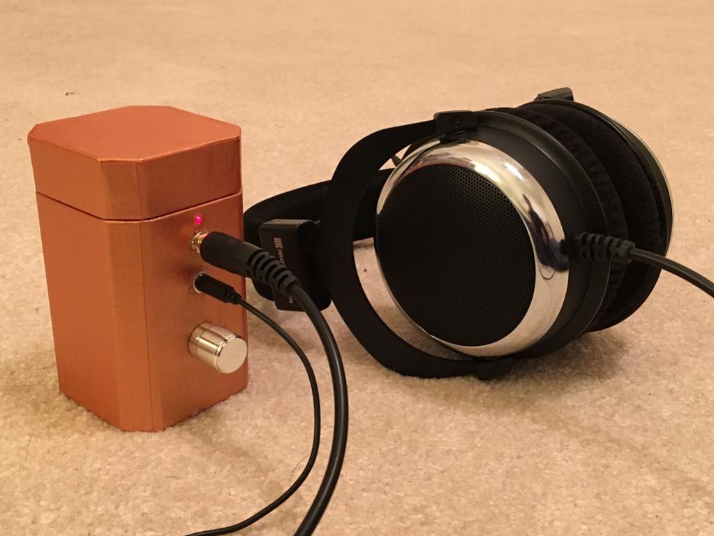

I just boxed up my 2 JFET amp:
![589200d1483349909-mosfet-source-follower-headamp-aksa-xrk971-jfet-ha-box-noise-meas-06.jpg](https://www.diyaudio.com/forums/attachments/solid-state/589200d1483349909-mosfet-source-follower-headamp-aksa-xrk971-jfet-ha-box-noise-meas-06.jpg)

I'm just curious. What was voltage across (or current through) the drain resistor prior to your change? Do you remember?
Nice build. Packaging is historically where I start to lose interest.
The boards are from OSH Park. You get 3 copies per order. So I build up mono boards, small size keeps cost down. I've been using them exclusively for over 4 years, they have never fouled up an order. Seriously high quality boards, about 2 weeks (consistent) from upload to mailbox. And... they are made onshore, in the US.

I think I was getting like 23mA to 25mA per leg with the 1R. I heard you want it at 2/3rds if Idss for best operation.
What did 3 of those boards cost from OSH?

Thank you. It sounds like something I'll want to change also, to reduce heat.
OSH Park has fixed price of $5 per square inch. That sounds expensive until you consider that you get three boards. The boards in the photo were approx 2.6" x 1.4" total cost $18.95.
